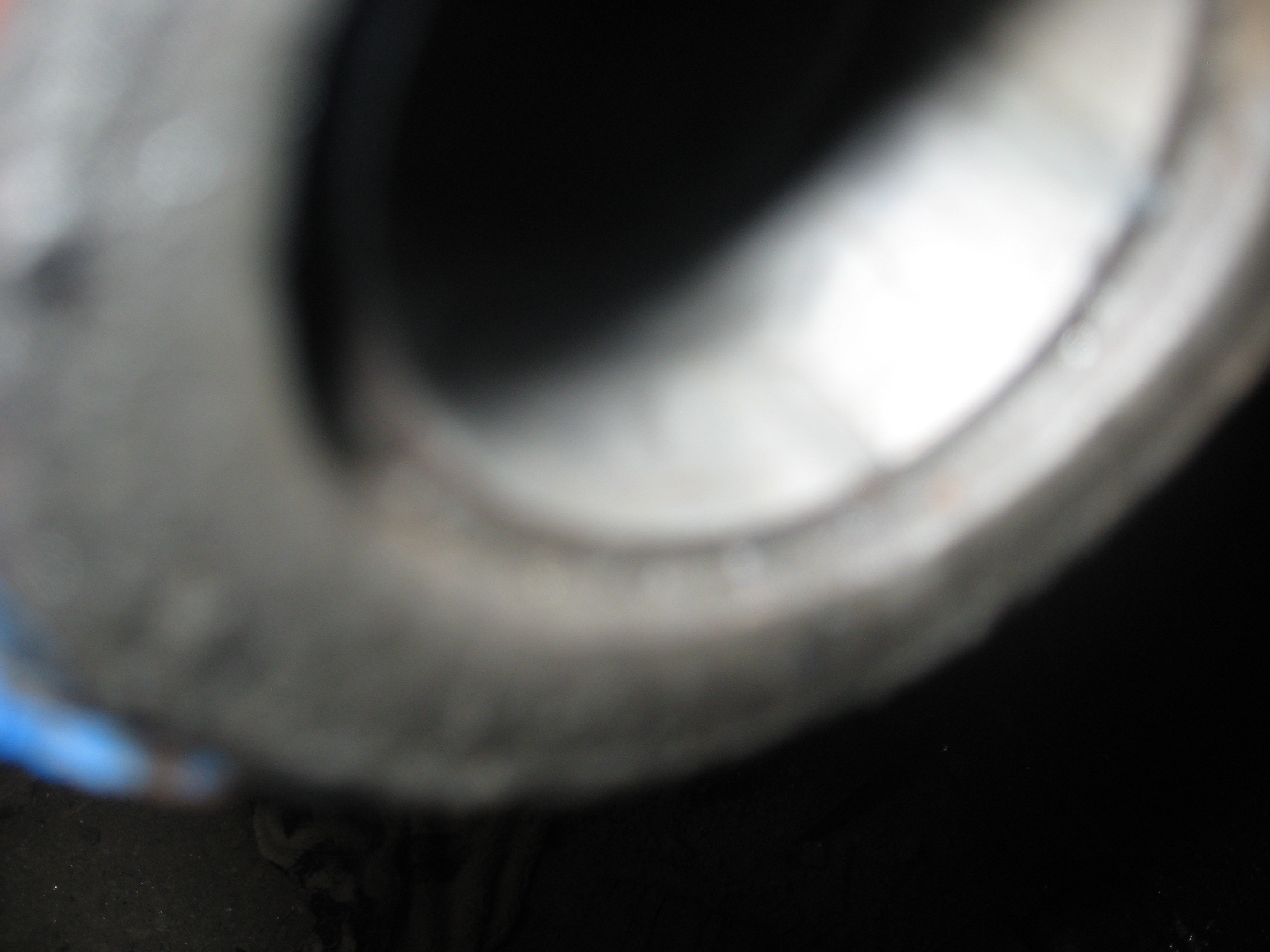

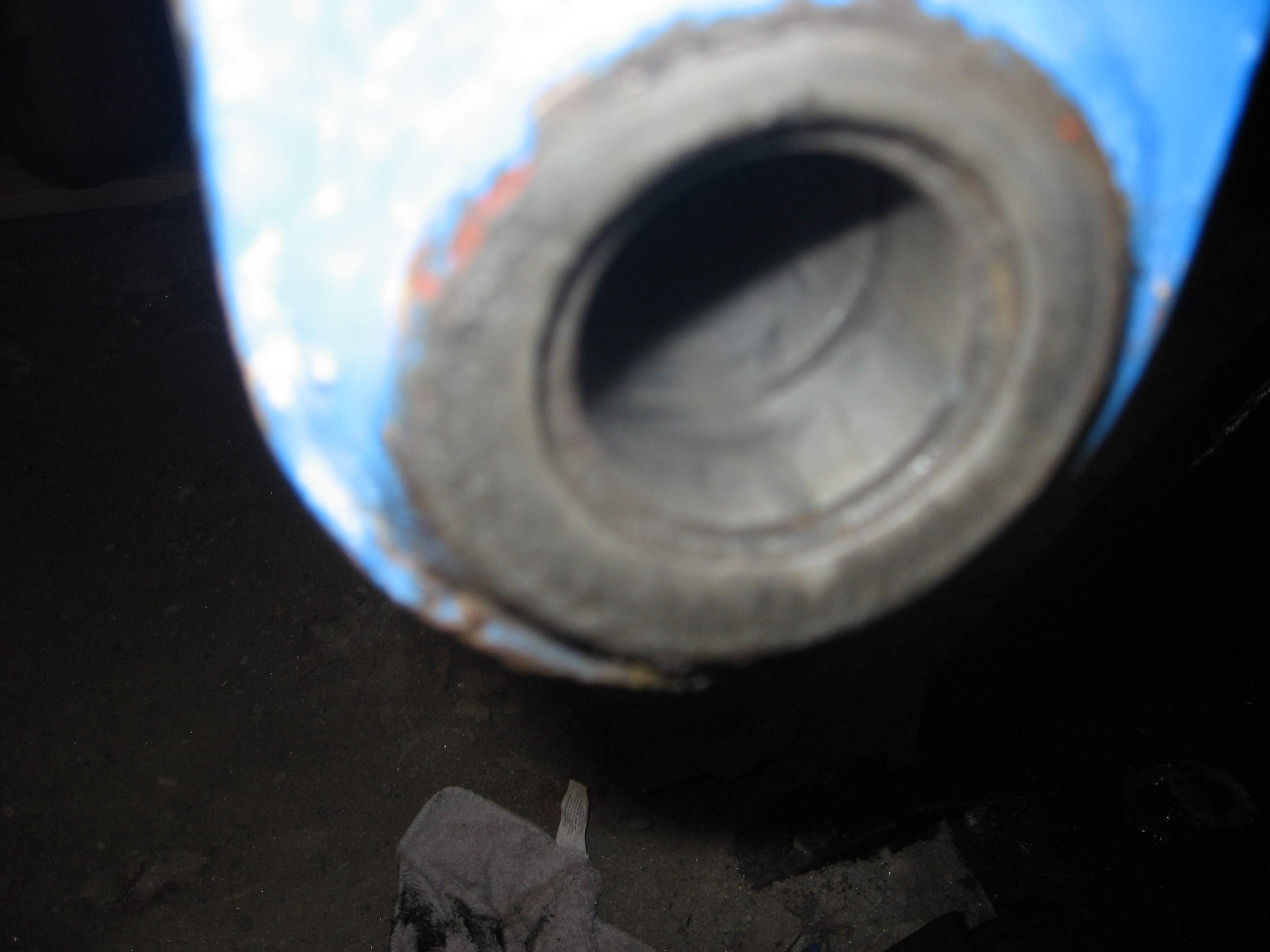

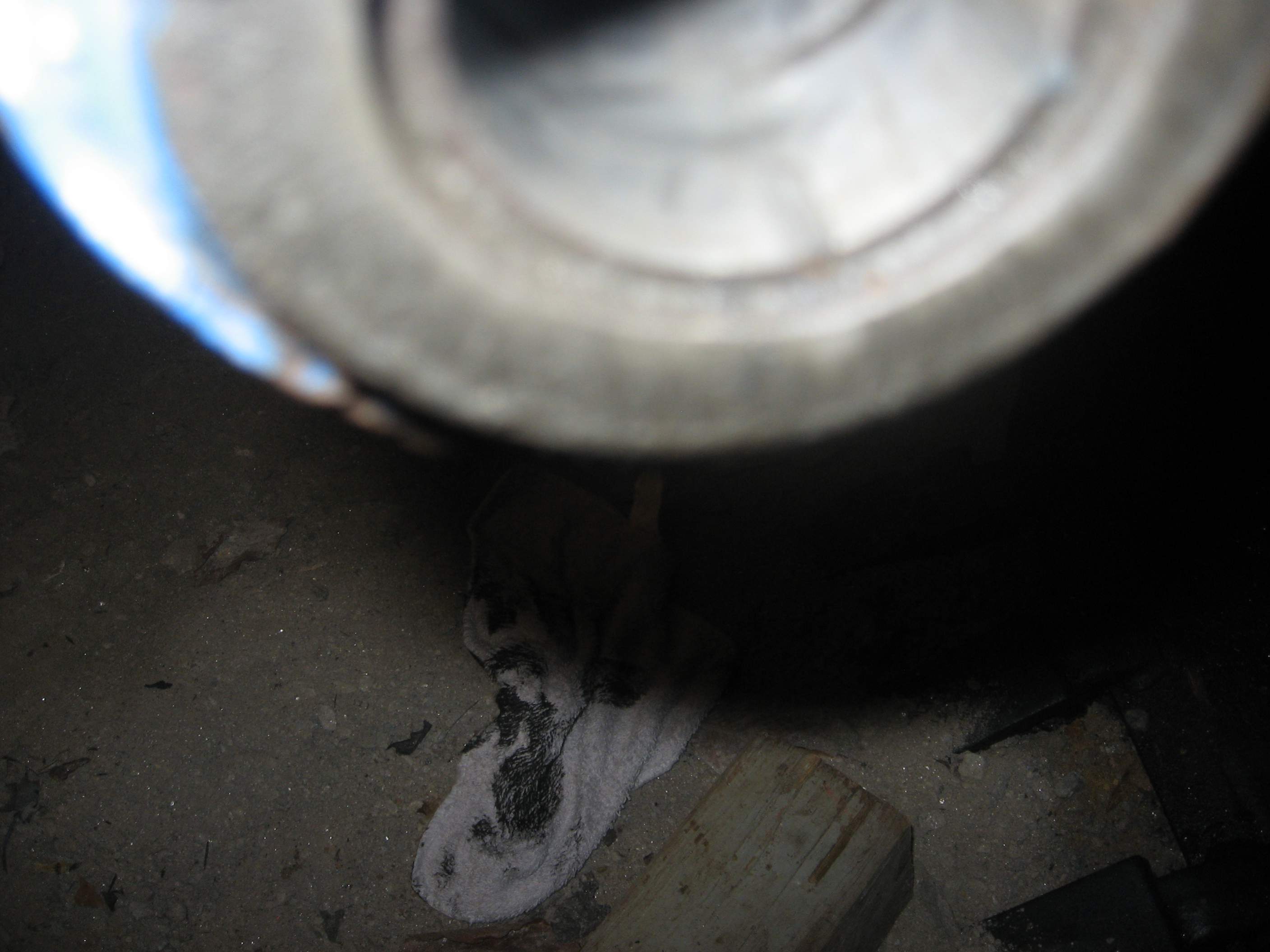

Im brokenIMG_1006.jpgIMG_1007.jpgIMG_1010.JPG down now to the ''possible bushings" I assume they are give the looks of it. In one picture you can see a split. At first I thought it was one of the split bushing I was in the previous posters site.
But For there to be a split it must be a bushing. Now Ill call parts and see if there is one listed. This machine is very old. 1980 ish.

While the photos look OK in the thumbnails, any sign of a bushing is blurred in the full size versions. Perhaps if your camera has a macro setting they'd come out better?
But I agree, the best place to start is with the parts people to see if a bushing is specified. Even if not, any decent machine shop should be able to fit one if also given a new, matching, pin and the desired tolerances. :2cents:

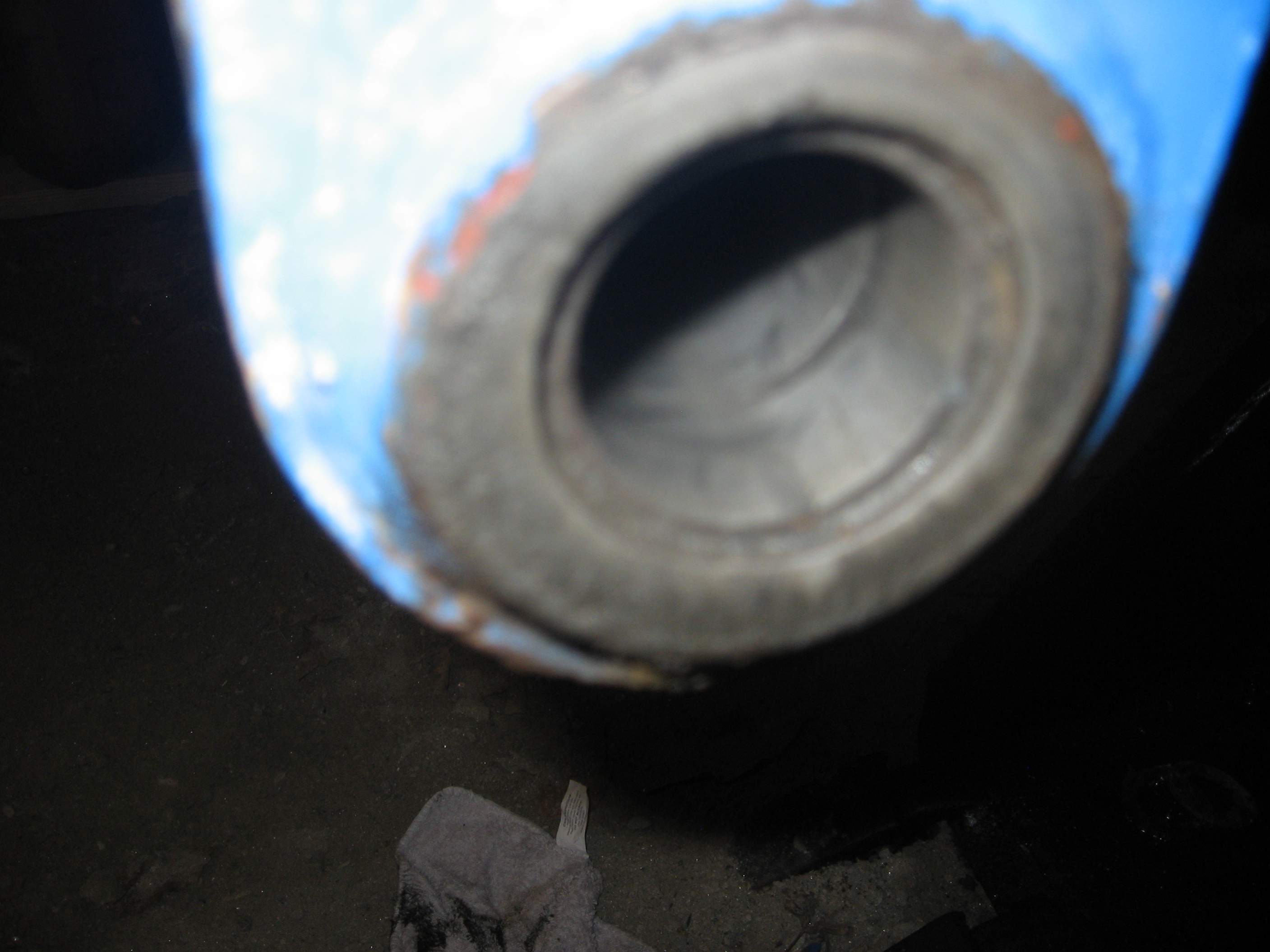

View attachment 426954View attachment 426955View attachment 426956
Im brokenView attachment 426954View attachment 426955View attachment 426956 down now to the ''possible bushings" I assume they are give the looks of it. In one picture you can see a split. At first I thought it was one of the split bushing I was in the previous posters site.
It's time to change them out before the bores themselves wear from the movement of the cracked bushings. On bigger hoes there would be a seal in end of the bore also. I've never worked on one that small. Hollow bore hydraulic rams are wonderful for pulling in bushings like those. I've also frozen them in liquid nitrogen and usually they slide right in. You likely don;t have access to either of those though. Dry ice for the bushings and a weed burner to heat the bore works too. I would try just a hammer and punch and see if they will drive out. If not, try welding like was mentioned. You will get more shrink if you weld around the inside of the bushing then lengthwise, but either will probably work.
