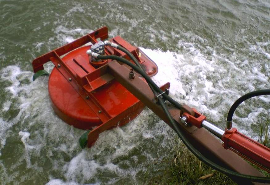

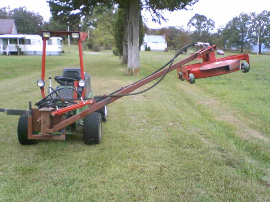

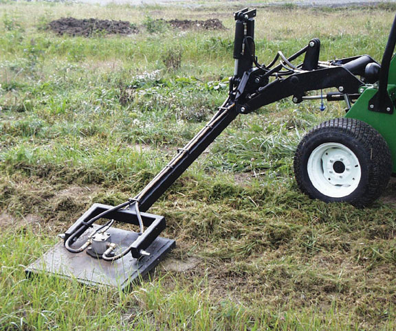

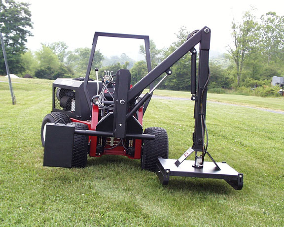

Just build something like this.
Pictures 1,2,and 4, the hyd motor is driven by 8 GPM's, and the red machine pump flow is about 20 GPM's. On the Power-Trac machines, we have fan and radiator cooling.
