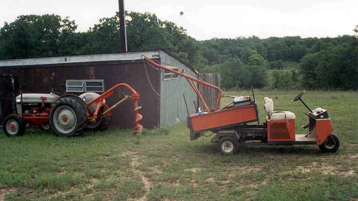

About 8 years ago I was building fence with the auger on the back of my Ford Jubilee and I got the "bright " idea of mounting a boompole in the hydraulic lift bed of my Jacobsen Truckster (see photo). It worked great for dragging and lifting one crosstie, but I got overzealous and tried it with two. As soon as I stepped off the 3-wheeler, the back went down and the front tire went skyward. /forums/images/graemlins/shocked.gif /forums/images/graemlins/blush.gif Luckily, all I had to do was "raise" the bed and the front came back to the ground. Sometimes you can "out-clever" yourself. /forums/images/graemlins/crazy.gif /forums/images/graemlins/tongue.gif

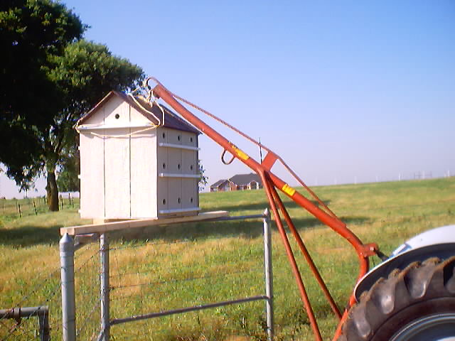

Used my pole to erect a bird condo...
