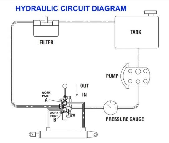

I have a 620 John Deere with a Bush Hog 3pt hitch log splitter. The splitter works generally well until I get into some big oak. Then the hydraulic squeals on the tractor and I have to knock the wood off the splitter wedge. I've been told the cylinder is big enough but the pressure relief valve on the tractor is releasing. Has anyone ever shimmed up the pressure relief valve on a '58-59 620 John Deere? I have a repair manual but was hoping someone had done it before.

No doubt the pressure is too low for the log splitter at 1200 psi, but increasing the pressure of the tractor will shorten the life of the pump or cause irreparable damage. I would be inclined to attach a PTO pump and reservoir for the splitter. The splitter valve most likely has a relief in the 2000-2500 psi range that will protect the system and deliver the results you desire.
   / Boosting hydraulic pressure #3
IF you tractor hydraulic pressure is only 1200 PSI and splitter cylinder id is 4 inches you are only getting about 7.5 ton ram pressure...(you only care about push pressure)...
Even increasing pressure to 2000 PSI will only give you about 12.5 ton....
Most stand alone splitters with only 6.5 hp motors can develop 22 tons... I do primarily oak wood and my 22 ton splitter has to strain on some.... Would not consider anything less in tonnage (22 ton) unless it is really softwoods....

Safest way to increase the force without harming the old low pressure system in that Deere is to mount a larger diameter cylinder to the splitter. Just going from a 4”to 5” diameter cylinder would increase the force from ~15000lbs to about ~23500lbs which is over a 50% increase. Only drawback is it would slow the cyl stroke time by about 50% also, if that matters to you.

One thing no one has mentioned, whenever you adjust pumps, you need to have a pressure guage to determine what pressure the relief is opening.
Your pressure may be low anyway being it is an old tractor, but it wasn't made to operate at the higher pressures that today's hydraulics ooerate.
Midifiying your splitter by adding an engine would be the best

No , you’re relief valve setting will always be your high pressure limit. With the same gallons per minute flow the retract side of cyl will be faster than extend side. This is because the cylinder rod is taking up space on retract side and creating a smaller cavity to fill.

As for your existing setup, I would first get a gauge on the hydraulics and see what pressure you are reaching vs the tractor specs. As earlier suggested, the pressure may be low relative to specs, and bringing it up to spec will improve performance. I would not increase it any more than 10-15% over spec, and I'd think twice about doing even that. Any tractor damage caused by the higher pressure may be difficult and expensive to fix on an older tractor with limited parts availability, etc.
Also as suggested earlier, the easiest "fix" is to increase the cylinder size. That would be a pretty easy and affordable swap. The down size is that the splitter will run slower, so you are trading time for splitting power.
If you are going to change to some other source of hydraulic power, whether driven by a separate engine or a PTO driven pump, I would carefully compare the costs vs buying a stand-alone splitter. I think you would be hard pressed to build a hydraulic system and pump for less than a purchased splitter. Hydraulic hoses alone will cost $50 to $200 each depending on size and pressure rating. And you would need to carefully figure out the flow, pressures and splitting force. including whether or not to use a 2 stage pump.
