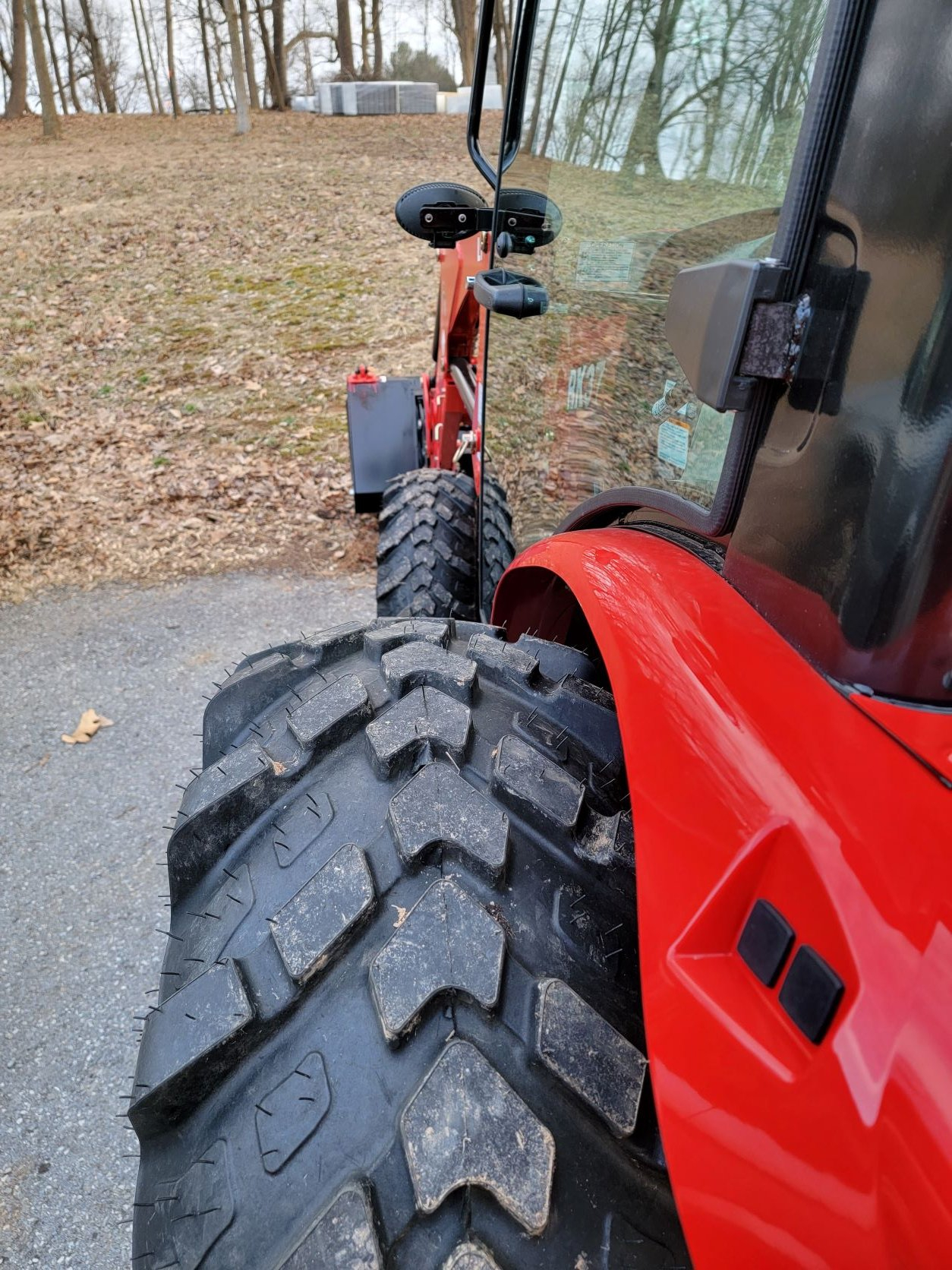

If you order spacers for the rear wheels of an RK37HC double check your bolt thread pattern. I just got 6" Bora spacers and they came with 16x1.5 bolts with sloped heads. (Those have to go inside the spacers and attach to the wheel hub.) My RK37HC has 16x2.0 bolts with flat heads so those won't fit the tapped holes in the spacers. Motorsports-tech is responsive and will send me replacement spacers. They said that in the past the RK37 tractors took the 16x1.5 bolts.
So if you are buying spacers check your bolt thread measurement - fine or coarse.

I LOVE how much more stable the tractor feels. I'm starting to bush hog across the hill, which reduces the strain on the engine. Still wary of the few places where the slope approaches 20 degrees. My issue now is that the seat is tilted.
Motorsports-tech was very good about replacing the 6" spacers - covered the return shipping and sent new ones when they said they would, despite the COVID-19 and winter shipping problems. They communicated what they were dealing with and gave good time estimates. They double checked the specs on my tractor as well. Even though I told them it needed a thread in mm they got the correct thread count in US measure (tiny difference but.... ), and all the bolts fit perfectly.
I am trying to decide if front spacers would help - after all, the front axle is on a pivot so they would not do much until the rear wheel is lifting... which, with filled rears and keeping the loader and mower low, has not happened. :)

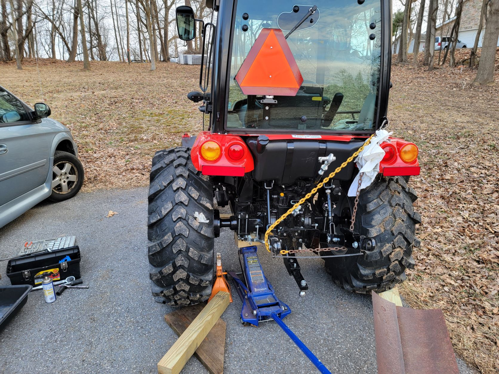

Found your thread looking for information on spacers; nice to see you're happy with Bora as they're one of the brands I'm considering, customer service is important. Question, do you only have a spacer on your left side? If so, why is that?
   / Bora spacer mounting bolt thread #4
Looks like a single offset to aid in traversing slope.
Just saw your question - I have the Bora spacers on both sides. The picture was taken during installation for the purpose of showing how the offset looks after one wheel was done, Bora side vs. original.
All the pictures were within a day or two of each other but it snowed. :) The chain is holding up the 3pt. attachment arms so I can work under the tractor (safety move) and the scraper blade is waiting to go back on for snow plowing.
The Bora instructions tell you to re-torque the bolts after x hrs. but that requires removing the wheel so I just keep a visual check on the bolt tips sticking out the inside of the wheel hub. So far they don't seem to have moved.
I would love another pair of Bora spacers on the front, next time I have extra $$$. For now, the rear really help and I keep my loads low when traversing the hill.
