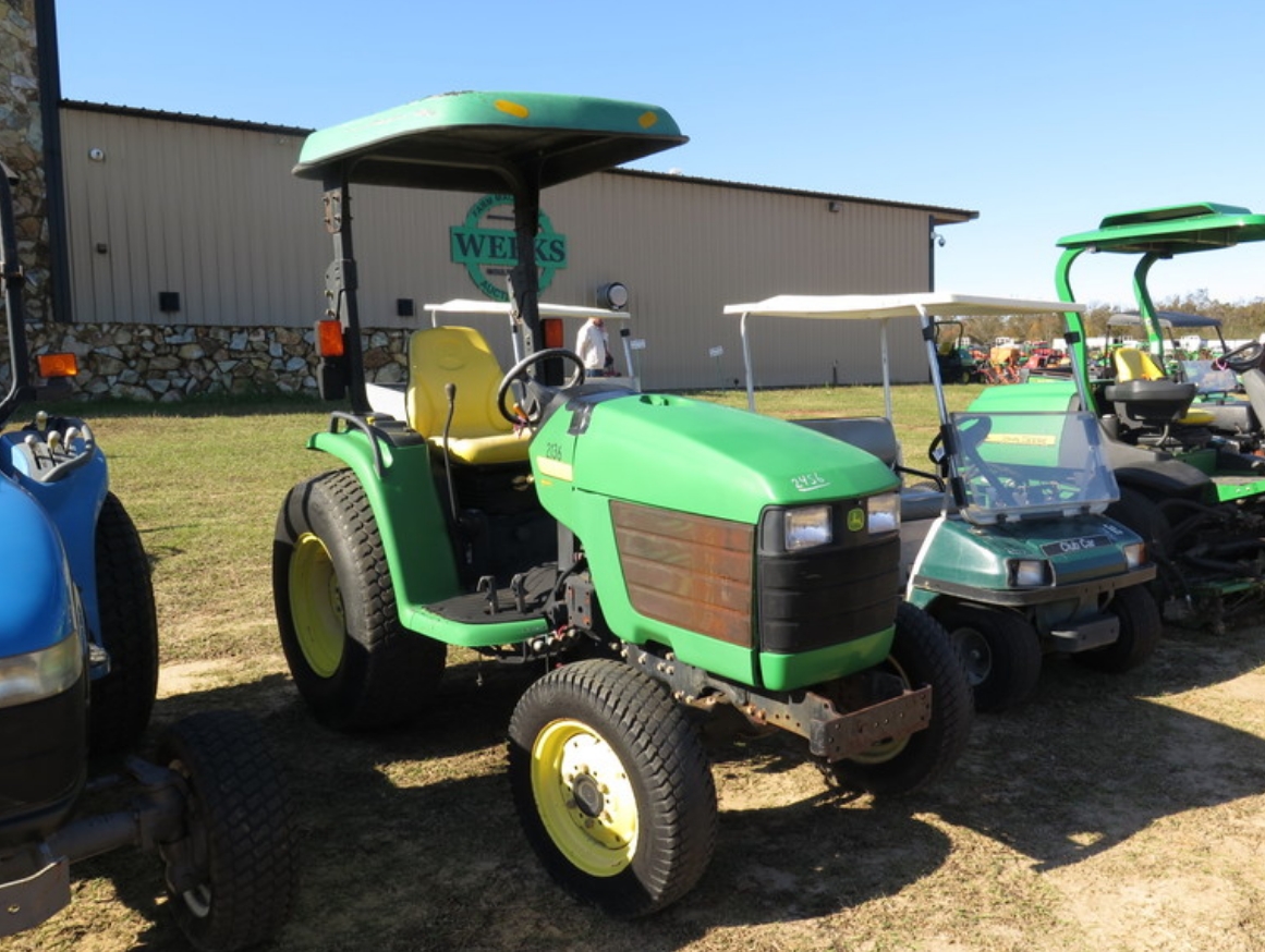

Picked up a 4310 at auction yesterday. Got it home today and looks like everything works and no leaks. Looking for a 430 loader and mounts if anybody knows of one. Tractor has the control and connections but loader is gone if it had one.

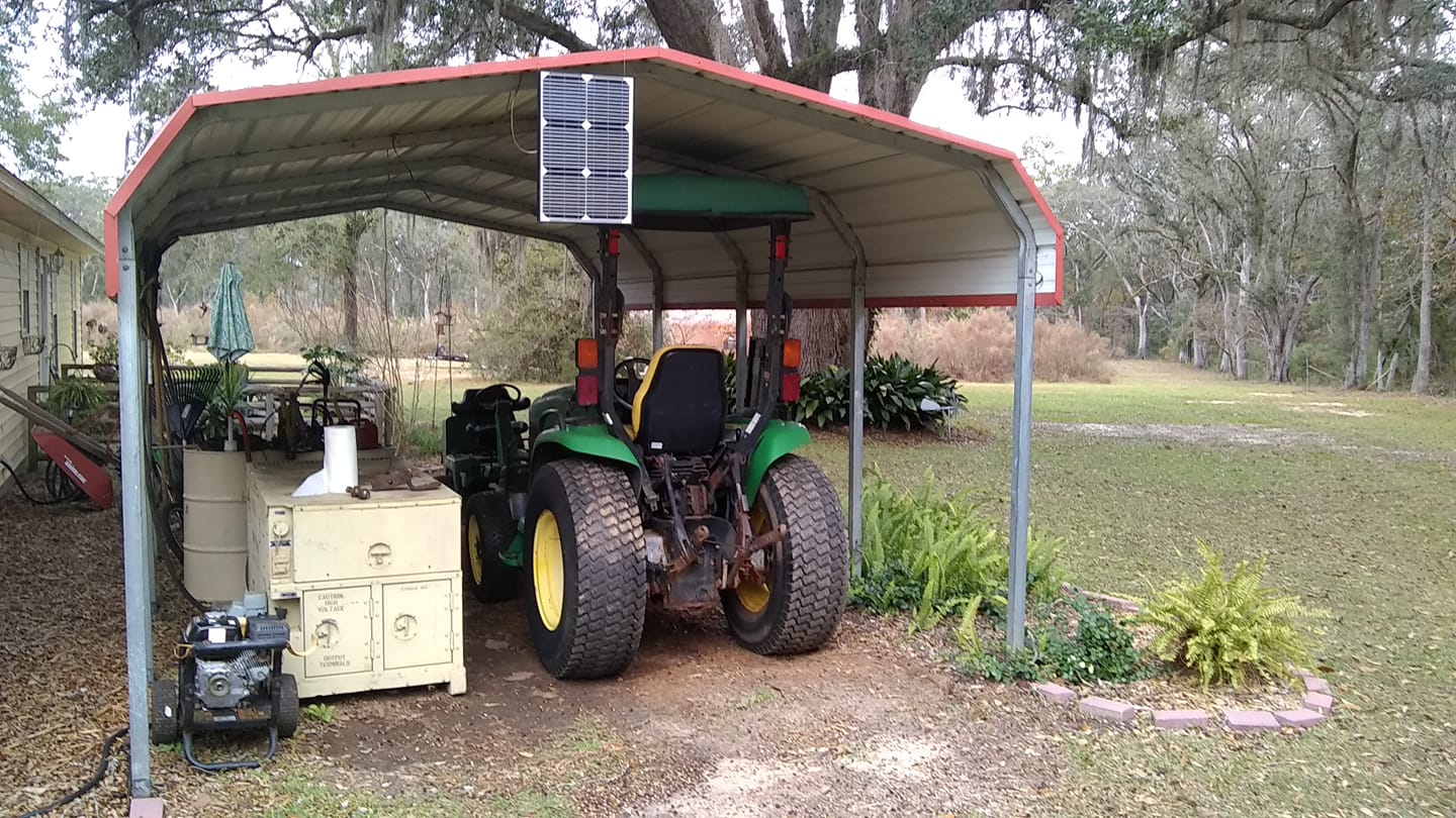

Tried parking it under my shed and it fits but barely. I went ahead and lowered the canopy position some after this photo was taken.

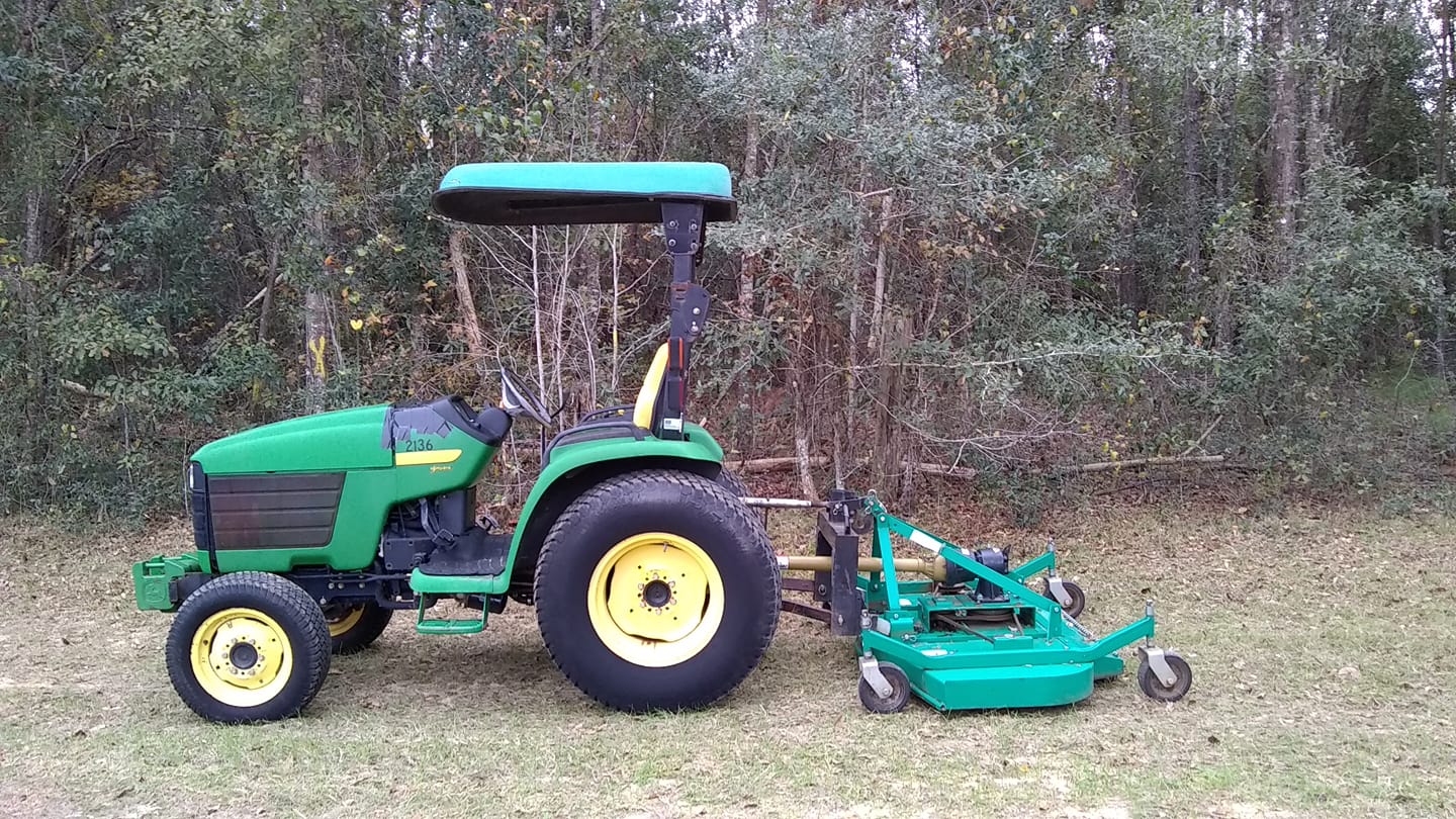

Next I put the quick hitch on and hooked up my finish mower to make sure the PTO would operate under a load. No problems there.
The cowl is broken as is the fuel door hinge area of the hood. Fuel door is missing. I went ahead and ordered a new hood and cowl set for it.

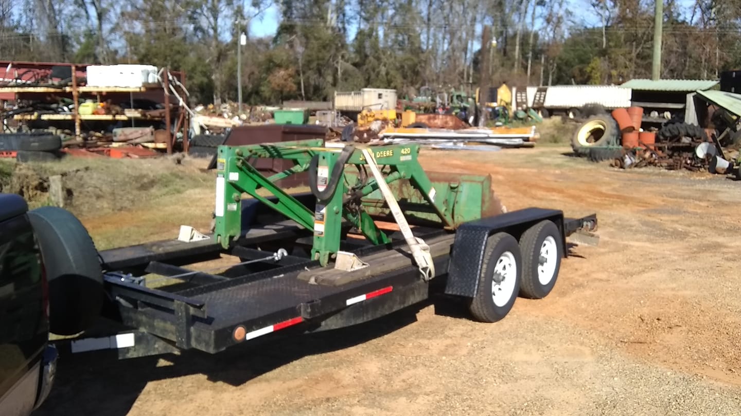

I picked up a 420 loader and all the brackets for it for $1200. The loader was missing the bucket cylinders. I am going to try and retrofit some 2" cylinders on the lift and bucket to increase the strength and height. Planning to do another thread on that.

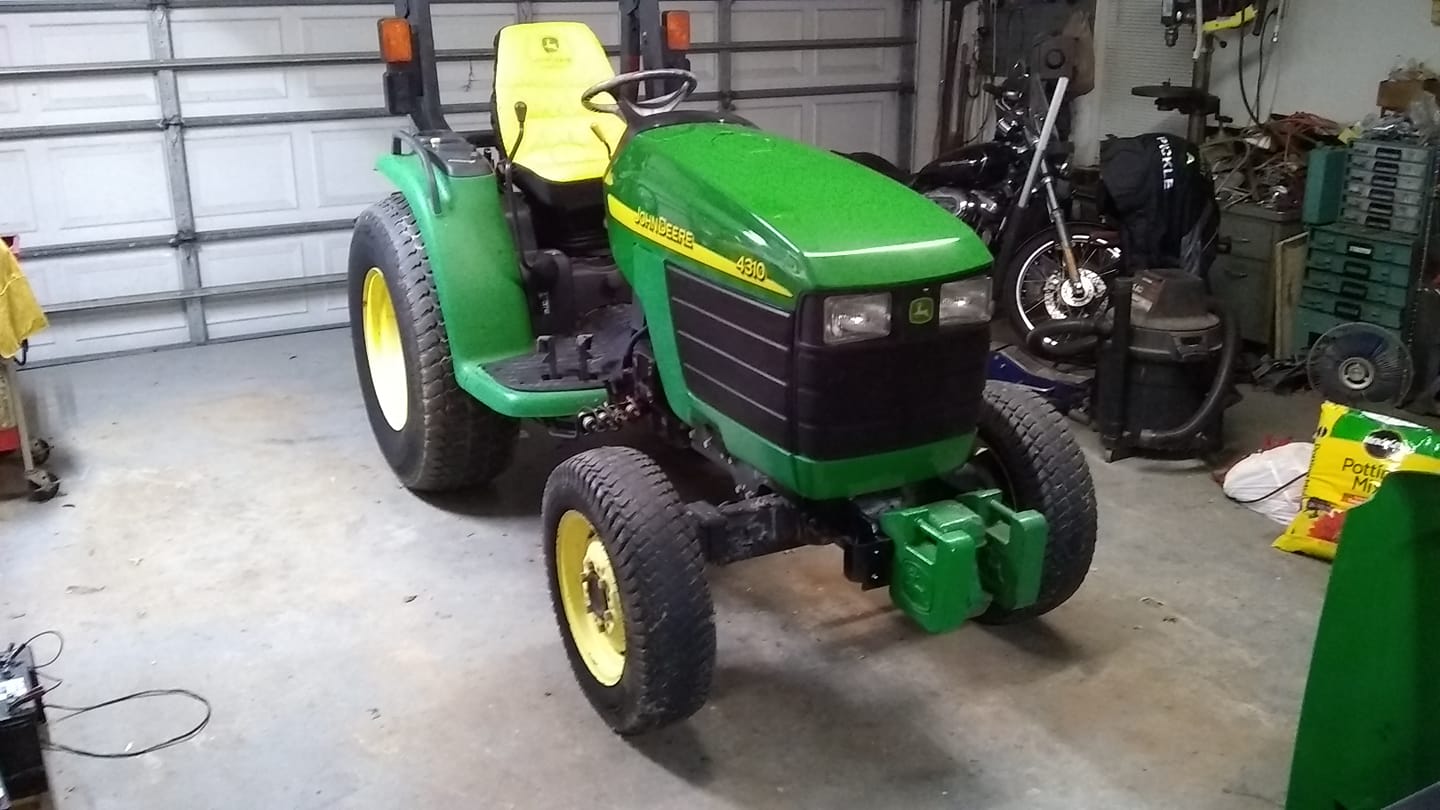

Installed the new hood and cowl. Cleaned out the inside of the dash panel glass so I can see through that now. Still cleaning stuff up and got side tracked with having to rebuild my landscape rake. Had to pull the canopy off and fold down the ROP to get it in the garage. Canopy has some cracks anyways so that is another project for another day

Looking better by the day. Did you buy the aftermarket hood? Or the high dollar stock hood?
If you bought aftermarket, how well did it fit?

I bought the generic hood/cowl set from FLIP. It fits okay. The cowl lines up perfect with the side panels but the hood is about a 1/4" mismatch all the way around. (EDIT: Looking at earlier pics the new hood fits just like the old but I don't know if it had an OEM hood on it to begin with?) It's not something that bothers me and may well be the way the factory hood would fit. The fuel door doesn't snap in very positive and was bouncing up and down. I stuck some small pieces of velcro on the rest pads to keep it down. The set was $358 shipped.
It didn't come with the foam pieces that stick under the hood on top of the fuel tank. I was able to reuse the one that was on my old one but I may order a new set from JD.

I'm thinking the only difference between the 420 and 430 loaders is the cylinder bore. I read another thread and watched the OPs videos on how he upgraded a 420 loader to 2" bore cylinders. He bought some odd cylinders from Surplus Center and did some fairly intense modifications to make them work. I'm hoping to just trim the cross tube on one end and adapt the hoses or make new hoses.

I received the cylinder from Magistar today and it looks like it will work okay. When I went back to order 3 more they had gone up so I called to see if they would match last weeks price and they did. Hope these Ukraine cylinders don't bite me in the ***. I will have $416 in four new cylinders. Will have to adapt or make new hoses but that was going to happen any way I went.
