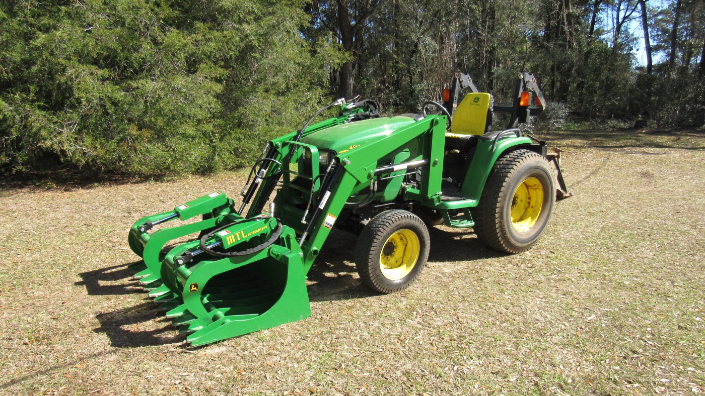

I'm interested to see what you have done for your 3rd function.
I ordered my grapple from MTL last night. I have everything ready for the 3rd function but I didn't bother putting it on yet. I have finished the loader handle part and the rest is sitting on the work bench. I will do a thread on this when I get the grapple in and connected.
