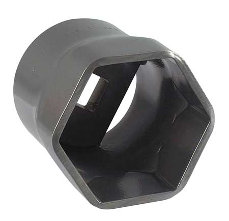

Thanks for the idea, I didn't note the size socket needed when I had it off to replace the inner seal. So I'll have to wait until I take it apart to see what size I need. I've looked around on the net for large sockets and man they are expensive. I guess you just cut off the end that the pull handle or ratchet goes then weld on the extension pipe large enough to fit over the axle. I have a 3/4" drive craftsman set but I'm not cutting up one of the sockets. My set goes up to 2" socket but I'm thinking the nut is larger than that. I'll soon fine out when I finish some of the other projects and clear out the shop a little. :)

I think I found it!
I bought the socket for my 3400 Ford axle (same as 3000) from ZORO.COM
I believe it was the ZORO item G1186455. Cost is shown as $22.14 plus shipping (USPS)
It is described on the ZORO site as:
Locknut socket 3/4 in. Dr. 2-3/4 in. Hex
Check out the ZORO picture; you will see that it is constructed perfectly to adapt for your use.
I can't be absolutely positive about the 2-3/4" size though, as I bought it almost two years ago, and no longer have it.

Hey thanks, I'll check it out. I've shopped on ZORO site before but I have to hide my credit card from myself before I go on there. :) That 2 3/4" sounds about right it's large but I'll wait until I have it apart to measure.

Yea I see what kind of socket you're talking about. Thinwall and the center can be removed easily and a lot less expensive than a reg socket. I'll sure check them out when buying. Thanks.

Actually, I seem to remember now that all we did was cut the center out.
Then we used a pipe wrench to turn the socket, as it was deep enough to let us do that.
Am thinking that I should have saved mine, because we did not do the other axle.
I am 77 years old now though, so it is likely that the other side will outlast me.
