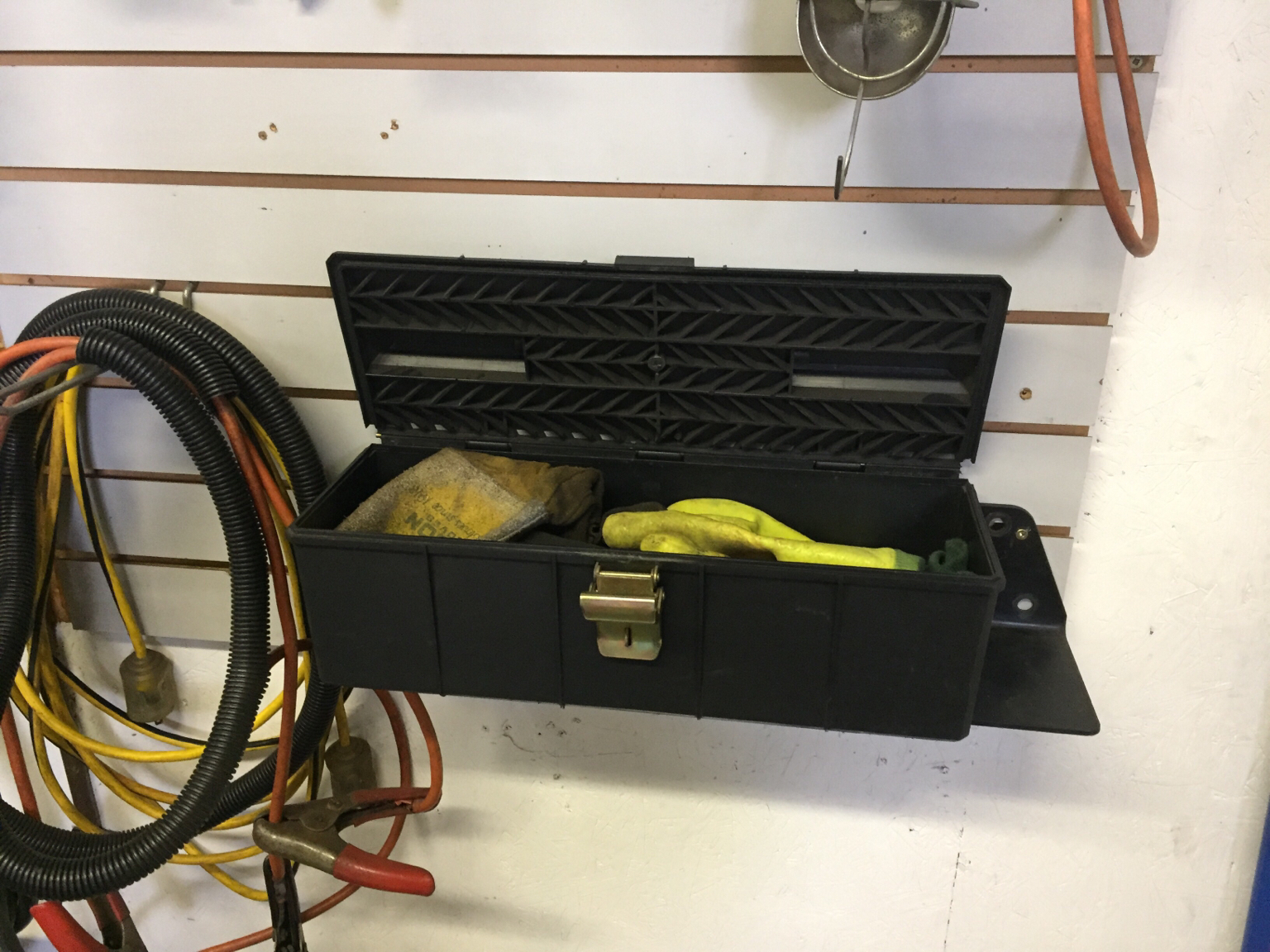

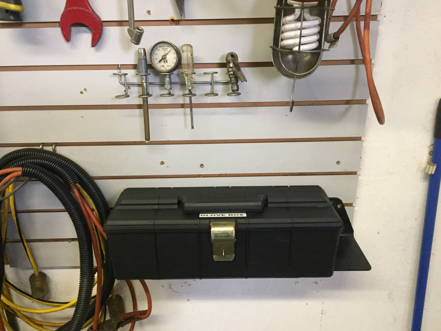

Sorry for the confusion, Sodo. That was a stainless wire brush pictured. It was labeled to remind me it was dedicated for use on aluminum.
At my age I need all the reminders I can get although I have yet to label my sock drawer.

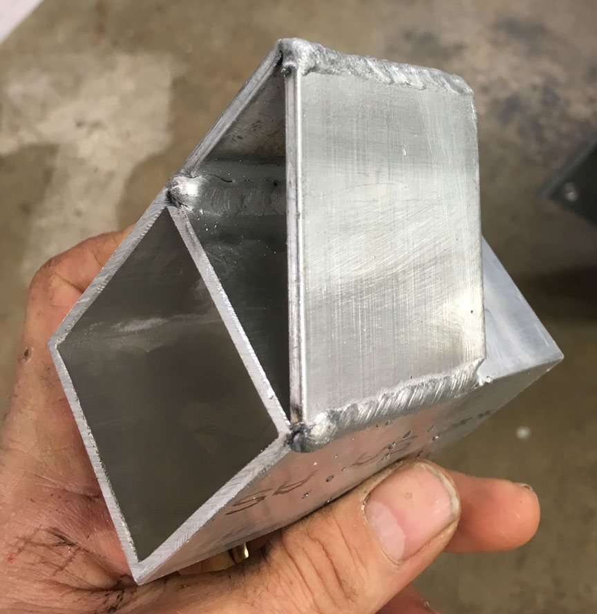

I've been using the Spoolmate100 a bit more. It' works pretty well. One problem I have is the weld start, it takes a little while for the heat to build up and the weld doesn't penetrate. So it kinda seems to me (for the weld quality with the spoolmate) that it's better to start in the middle where the stresses will be low.
You can see that startup lump where it was cold on the inside fillet.
The one outside weld with only 2 legs sucking heat away it looks like the heat built up quicker and penetration is better (than the 3-leg joints).
537079d1516817101-bought-miller-multimatic-200-a-aluminum_spoolmate100-jpg
I preheated other joints to 200F and the spoolmate welded them much better. Even 1/4" thick. Anyway I got my Aluminum projects going with this Spoolmate100 and it's a good tool.

Might try 500 degrees on 1/4. really wets in good. i always turn on acetylene only and soot smoke the weld area. turn on the 02 and heat til the black is gone = 500 degrees. Spoolguns love 500 degrees on AL.
