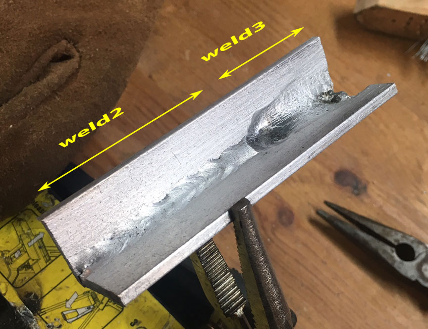

I've now done 3 welds. Yes having trouble with the end melting/dropping out. Need to do a lot more before I dive into my "project" of "purchased" raw materials. I will practice that, stopping before the end then spot the last 1/2", make sense.

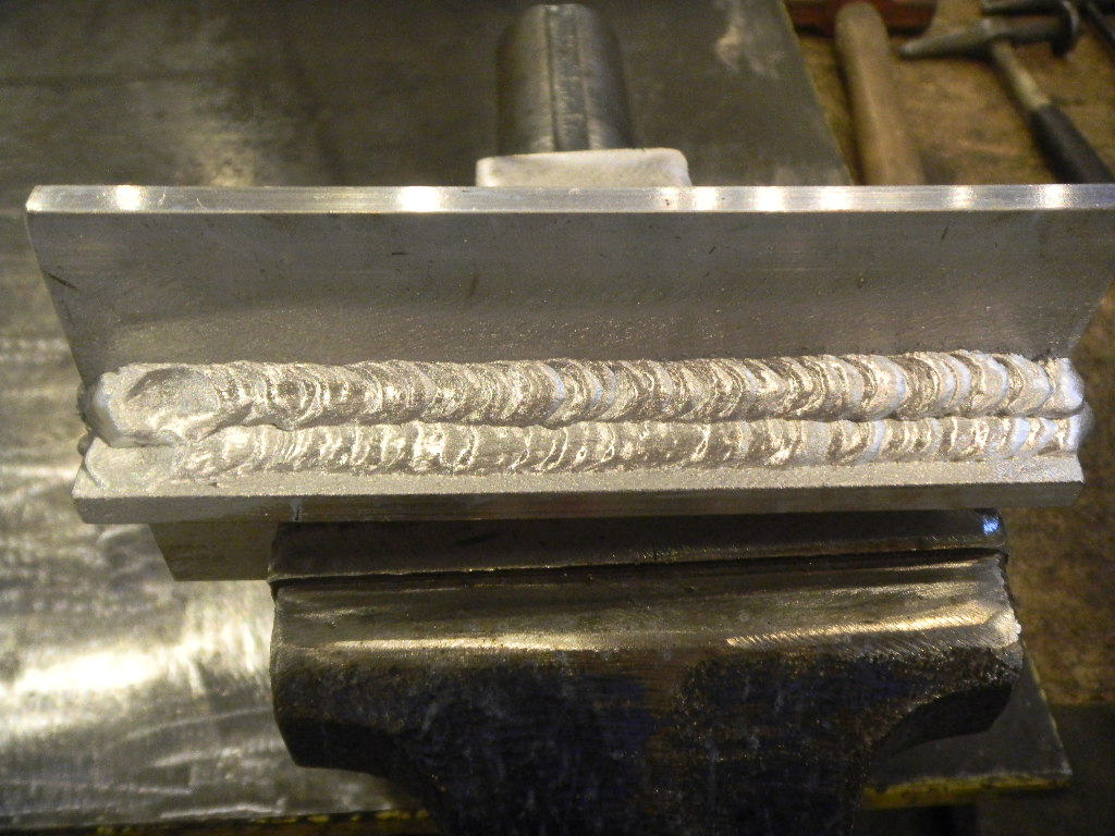

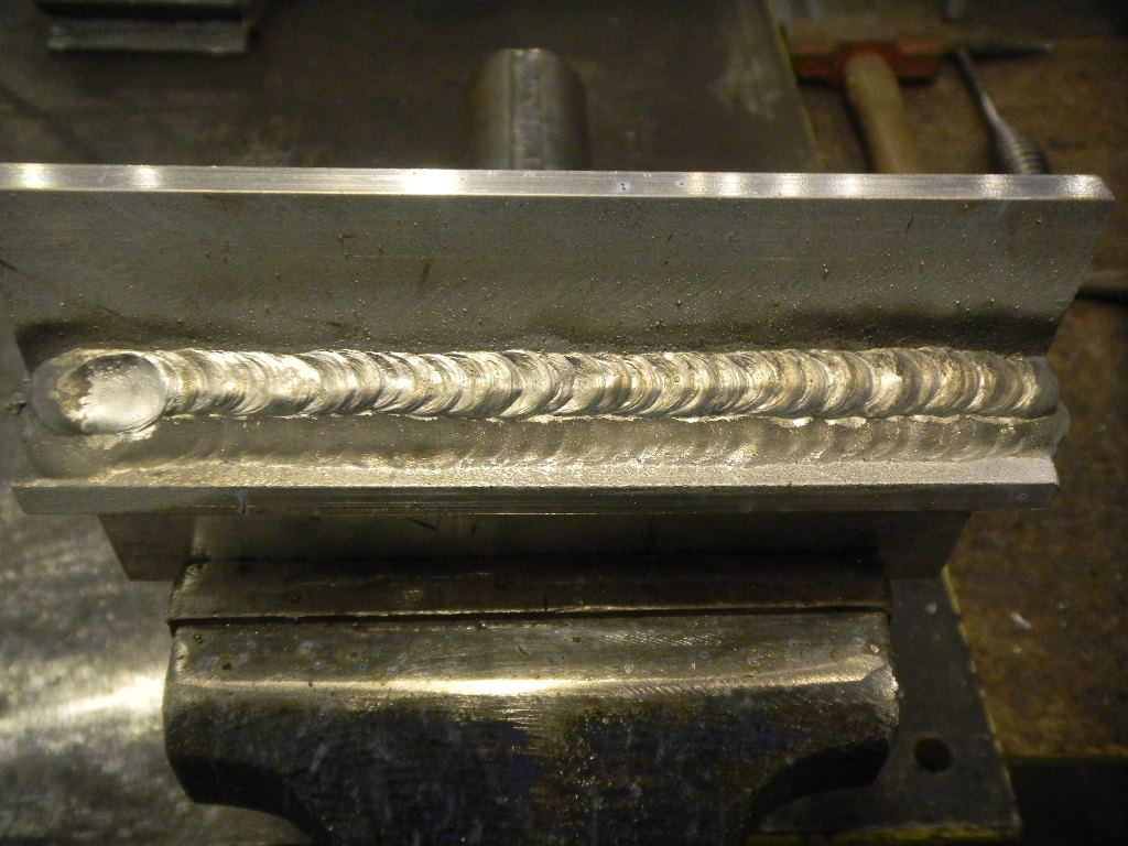

Sometimes it works best to stop in the center.

When looking for advice on how to improve your welds, show the finished weld as welded and not cleaned up or polished so much you can't even see the ripples in the weld. The ripples in the weld can tell more than you think.

Its just lightly wirebrushed, just enough to get the soot off - the ripples are so faint it would be hard to see in a photo. Need a different method to get the soot off (to see the ripples).
This pic is simply my first weld, I simply wanted to show that if the first weld is this easy, success is feasible. Not really ready for advice yet as the whole of my experience is not ready for refinement as I was simply testing if it works at all. On my 3rd weld, molten aluminum dropped to the floor and spattered in all directions. My shop has a couple other projects going at the moment, and a pretty good mess brewing, it's not safe for welding, if ever. Normally I weld outside, consequently have to wait for a wind-less day. But how well this first test weld came out,,,,, was inspiring.
I will certainly weld more Aluminum soon in various conditions and a more organized fashion and will post pics for advice.

I tried that and that's when the molten Aluminum dropped out (on weld #3, my last). Anyway there are many things to learn. I'm sure disappointed I can't just walk out there and weld. All I have here at home, is a garage, and it's 3/4 full. Wish I could clear it out but can't do that (at the moment).

How do you get the soot off a MIG weld without messing up the ripples?
A stainless steel wire brush. But wait until the weld is cold! Also, never use that brush for anything but aluminum!
