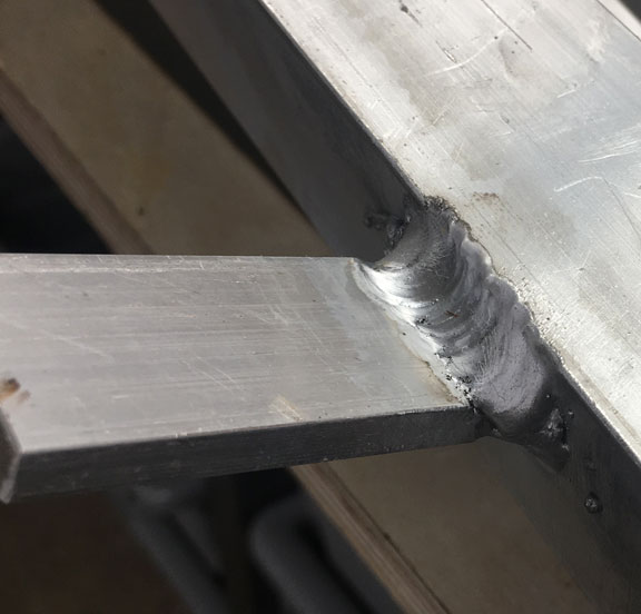

OK I've been doing some of the things you guys suggested and the welds are better and more consistent.
With the Spoolmate100, which is really a "cheap" device. IT sure does NOT look like $315 SRP. It looks like $115. But anyway it seems to work. I started cleaning my welds with An "Aluminum weld cleaner". It's phosphoric acid. It was $7 for 1 quart, and I just wipe it on with a paper towel, let it sit 2 minutes, wipe off with a dry towel, then a wet (water towel) then dry.
- Pre-clean weld area with "Aluminum weld cleaner"
- Wirebrush with a dedicated SS brush
- PUSH the MIG, with about 3/4" stickout
I was amazed how much difference it makes to PUSH the MIG. It's not like steel, where you can work out out either way. It wants to be pushed and sounds like a sizzling egg. To start I trim the wire back to about 1/4" so the gas gets there before the wire. Not sure if this is the bomb but I've been doing it.
540620d1519021786-bought-miller-multimatic-200-a-spoolmate100-jpg
This is a 1/4" x 1 flatbar welded onto 1.5 x 1.5 x .120 sq tube

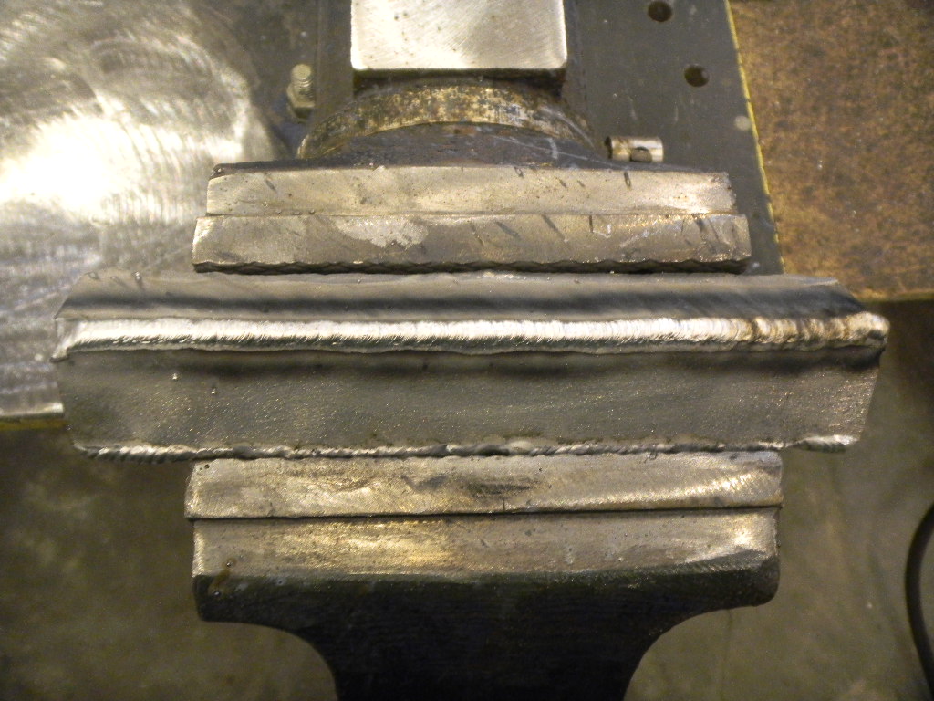

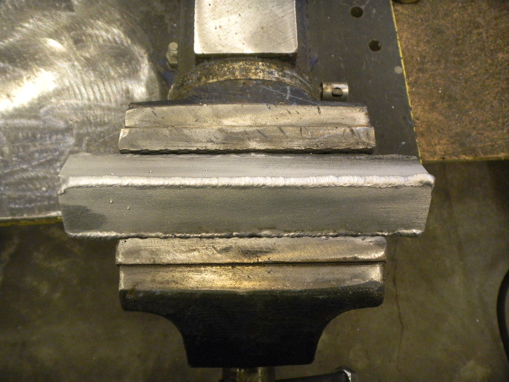

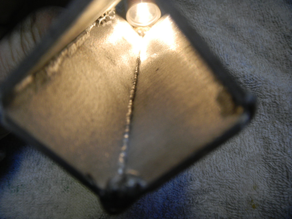

Keep practicing with your spool gun:thumbsup:. When I bought my spool gun, I hadn't run one since the late 1970s. I ran this corner joint on 16-GA aluminum.
Took a little bit, to get it dialed in!

I'd be real happy with a lesser weld than that....

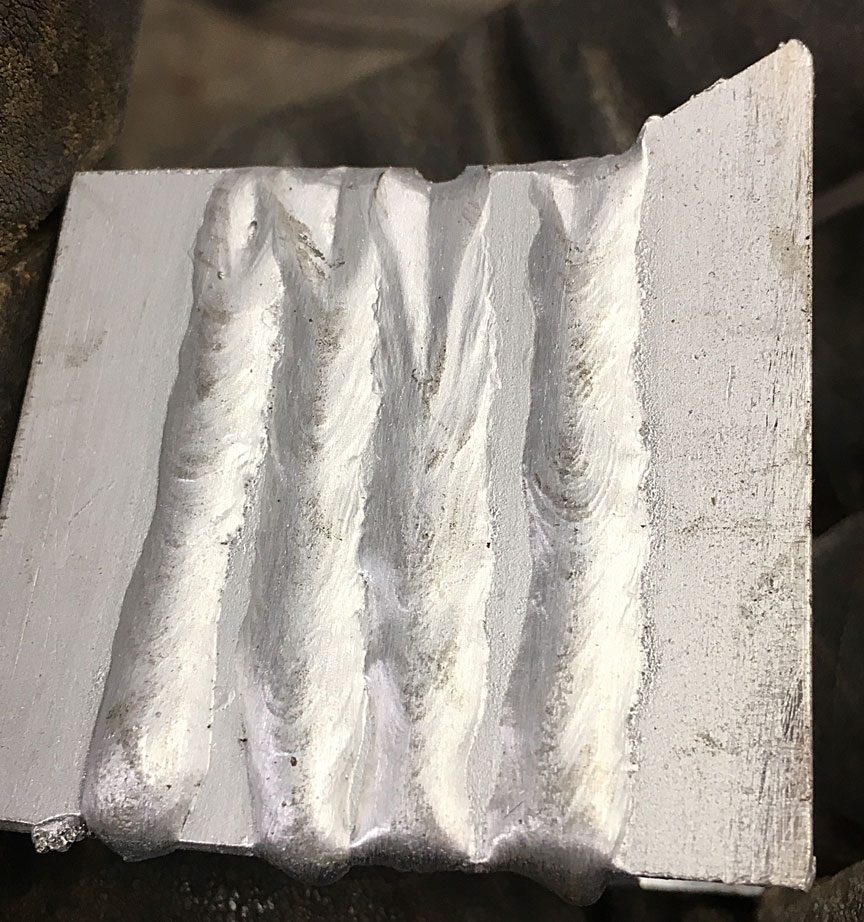

I can't complain about this Spoolmate100 .... Beads on 1/8" thick aluminum.
543435d1520739899-bought-miller-multimatic-200-a-img_1035-jpg
This is about 1/2" stick-out, moving FAST.

Thanks Sodo, I guess I am going to have to pull my SpoolMate out of the brand new box and give it a try on some Aluminum. It has been sitting there staring at me for about two years now!
   / Bought a Miller Multimatic 200
#128
Mine sat for longer than that.
You'll need 100% argon.
