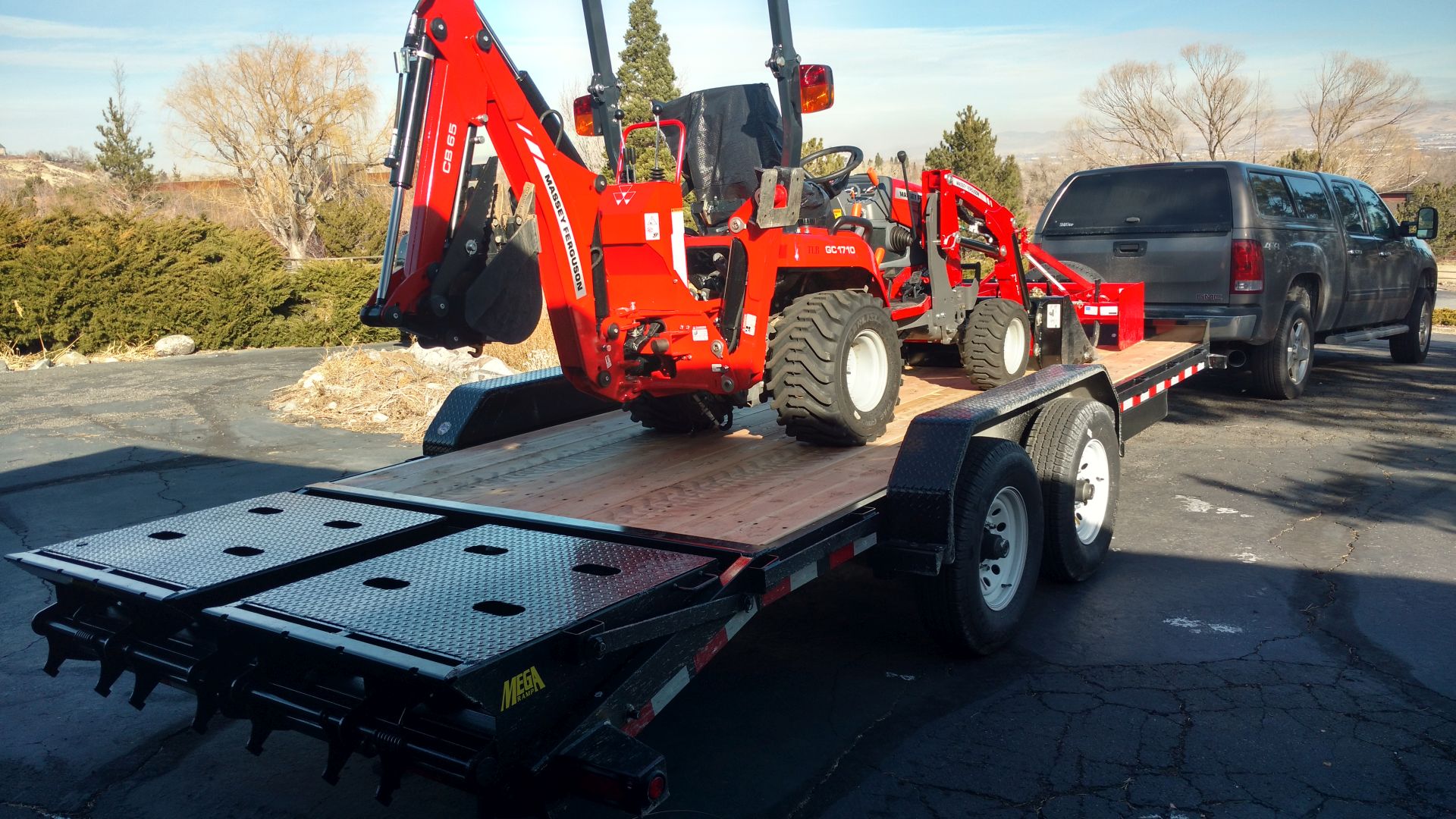

After much hand wringing about which trailer to get, and what type, I finally bought one!
Bought a 20 foot Big Tex bumper pull equipment trailer, with mega-ramps on the back. I wanted the 14,000 gvr trailer since it has bigger axles and brakes, but didn't want to trigger the need for a CDL. So I bought the 14,000 gvr trailer with the agreement that they de-rated the VIN sticker to 9,990 lbs. Best of both worlds, I hope? Safety due to trailer strength, no CDL needed.
The base weight is about 3,100 lbs. I don't think I will ever haul anything to top it out at 10,000 lbs. So hopefully my transport needs are safely met, while staying legal. I transported my Massey SCUT on its first trip, and it pulled very nicely. My tow vehicle is a GMC 2500HD diesel.
/ Bought a trailer!

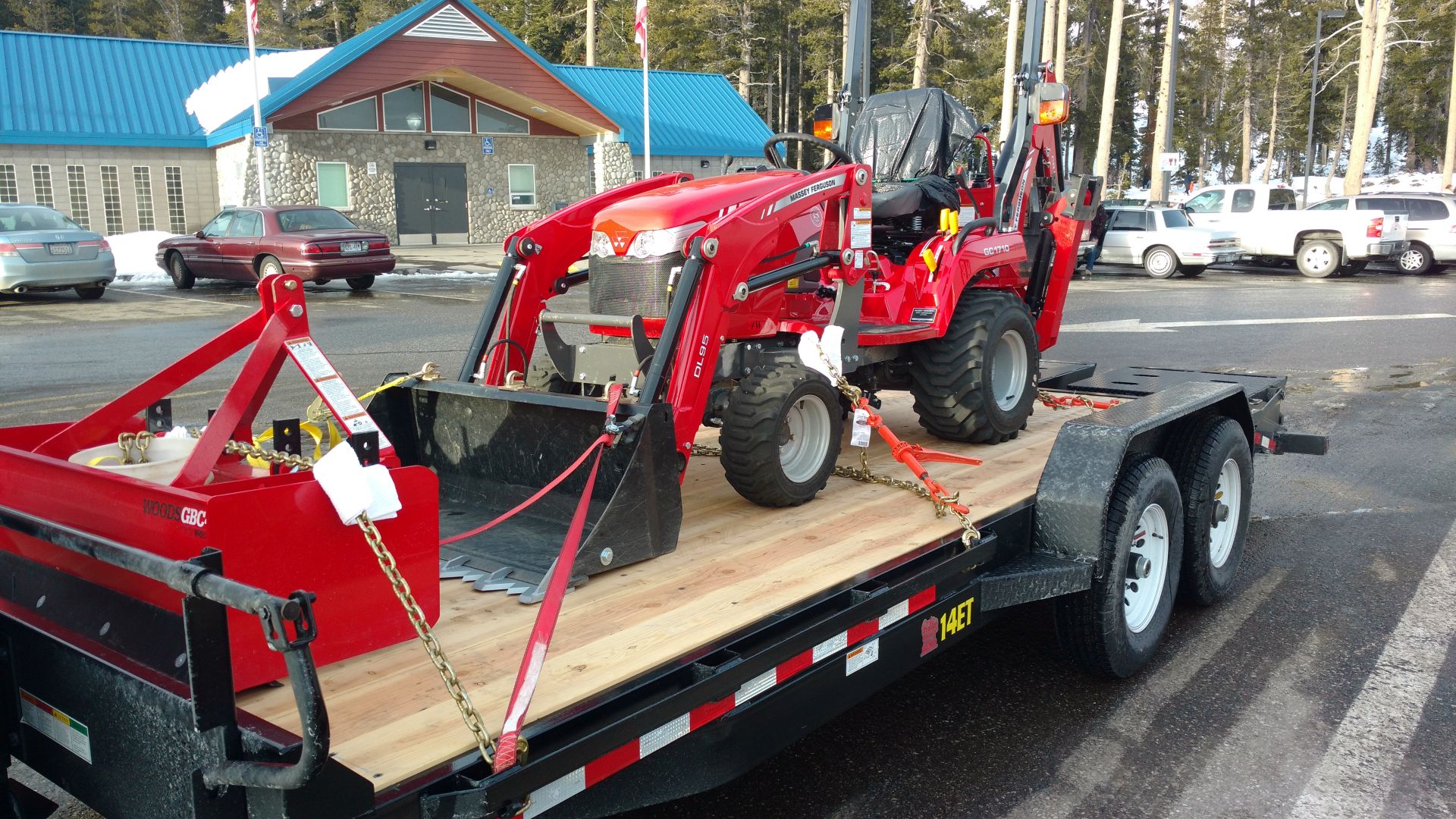

Here are two pix. The first is in my driveway, loaded up and ready for the first trip. The second photo is at the Interstate 80 / Donner Summit rest area in the Sierras, elevation about 7,000'. Mid-way on its first trip.

looking good, I like those ramps laying flat like that.

Like the look of those ramps.
Technical question on the derate. Rated for 9990, but is heavier than one built for 10000. So legally you can actually put less o it than if it was built for 9990?

I like the looks of those stake pocket tie down rings. Gotta get some of those!
If I want some side stakes for hauling logs or firewood, do most people make the side stakes DIY, or are there sources for those?
btw, the ramps are interesting. They extend and act as a ramp, but fold flat as shown in the picture. There is a 3rd option. The "bottom" part of the ramp is fixed, like a beaver tail. The folding top part can be folded part-way up to the vertical position, and then fixed in that position during tow without having to fold it flat. So you can get full use of the entire length of trailer, if needed.

Quick side-jack since I have a GC1720 - would it be better to cross the front straps (left pocket to right bucket hook, right pocket to left bucket hook) to limit lateral movement or is the OP's method better?
It depends on where your trailer attachment points are. If you mostly want to prevent lateral movement, you would want the tiedown to be straight across the trailer, if you want to prevent foward/back as well, it needs to be at an angle front to back as well.
An ideal tiedown would be at a 45 degree angle up/down as well as forward/back. That will hold equally well to keep the load from lifting, going forward/back or going from side to side.
If you look at the OP's box blade, it is well strapped down to keep it from moving from side to side as well as up and down, but if it were a wheeled load, there wouldn't be much to keep it from moving forward/back.
That is why on the tractor, the OP has the chains going forward/back and up/down at roughly a 45 degree angle.
The way the OP has the bucket strapped down will hold well to keep the bucket from going backward, but it wont hold as well for side to side or up/down as it would if the strap was connected to the next stake pocket back.
