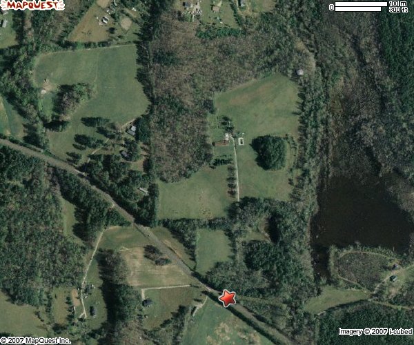

About 16 months ago, the wife and I purchased 92ac in the Wake/Durham area of North Carolina. The general purpose was simply to get some dirt for a weekend retreat, but also with longer term retirement house build possibilities.

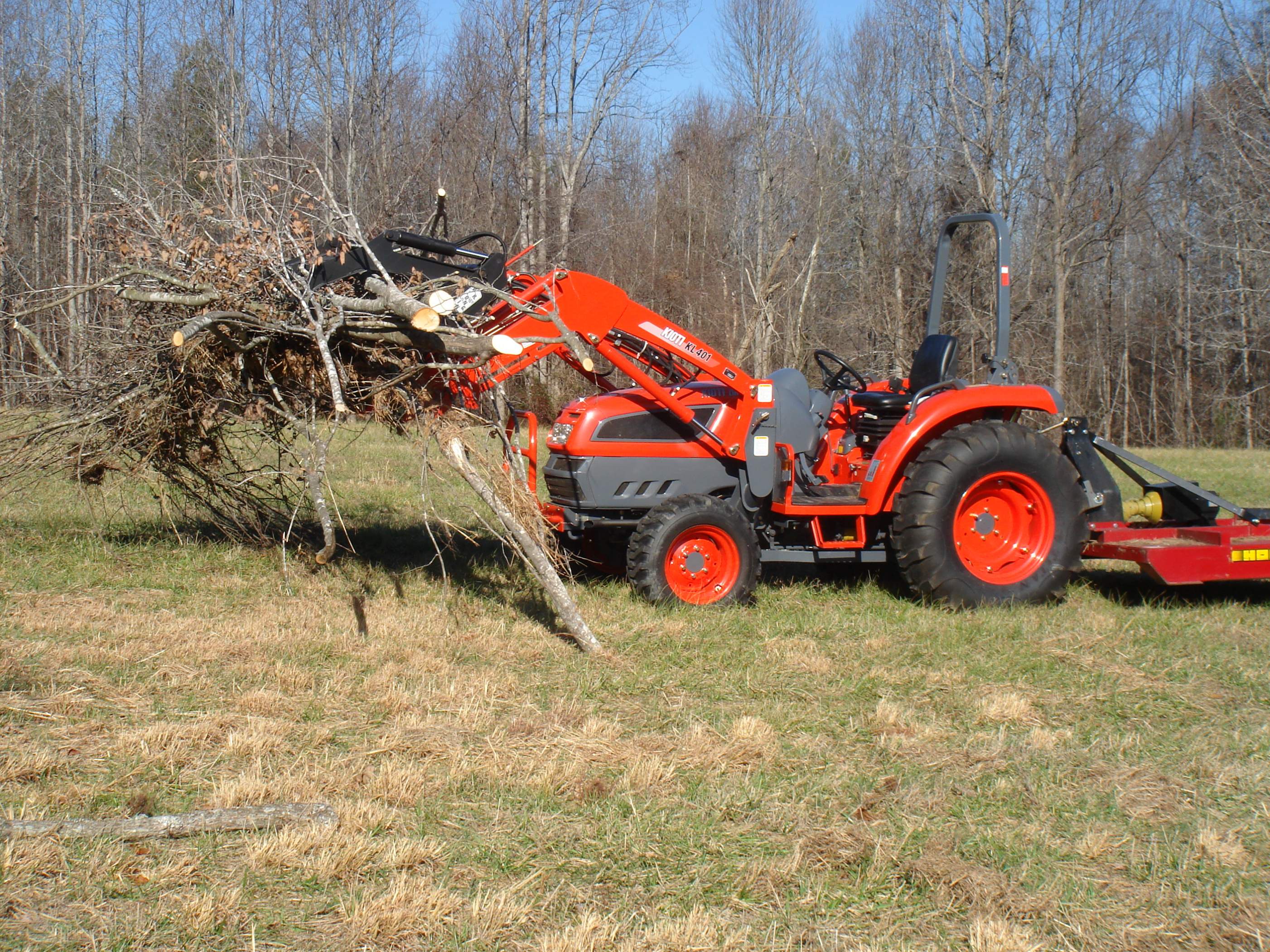

Of course, a tractor was on the list of must "haves" after buying the property. I went with a Kioti 45SE and have no regrets.
For the record and being a newbie, I did not believe it when people said a tractor would get "stronger" after the break-in period; however, after hitting 60 hours the thing found a whole new gear which is awsome.
Anyway, after putting the tractor through the normal initial paces - I started to get stupid. I was mowing one of my smaller fields and said: "You know this field would really look authentic with an old tobacco barn in it"
Long story short - I looked at buying an old one (there are lots in this area of the country) and then moving/assembling it on my property, but then figured it would be more fun to build one new and try to make it look old(ish).
I will try and post some pictures of my progress as I go. My plan (the stupid part) is to try and build the thing myself. One man vs One building.
Attached Pictures:
Tractor with grapple
Overhead of Property (I own from the star up including the swamp on the right of the picture. The structure will sit in the small field above the star).

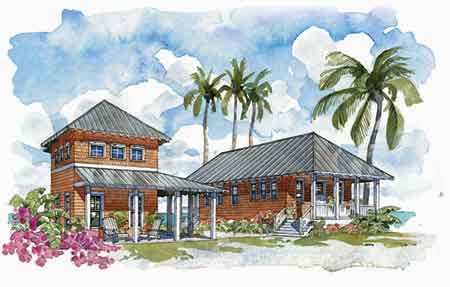

Anyway, one afternoon my wife says "what about this?". She had been looking at a Southern Living magazine and saw a plan my an architect named Jason Bigelow.
The rendering looks like the below. I am only building the tower structure and thought with the right siding/etc - It would look like a restored tobacco barn.

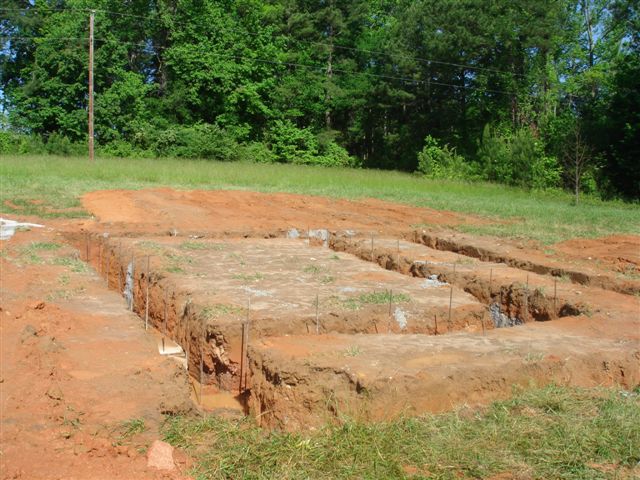

Digging the footings -
After getting plan approval, I started by getting my footings dug out.
This was the first One Man vs One Building decision. I hadn't even started the project yet and I came to the conclusion that I would be better off paying someone to dig the footings.
After doing the layout, I realized that the slope of my field would not let me do a slab foundation. I therefore needed to regroup and go the route of a block foundation. (Hard to see in the picture, but there is a 4 foot grade difference from front to back. I did not want water problems so I opted for block foundation)
I do believe I could have done it myself with a rented backhoe/etc. However, for the small size of the structure it was more efficient to bring in a pro.
He banged it out in a little over an hour. Cost me $300 bucks. Since the $300 bucks got me two hours, I had him dig me a trench for a new culvert across my drive also.
Mistake number 2. Changing the plan (from slab to block crawlspace) after getting approval requires a new engineer stamp. More time - More Money. Not off to the start I was hoping for.....
Pictures of footings with rebar
