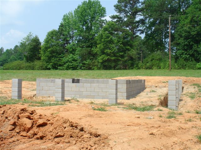

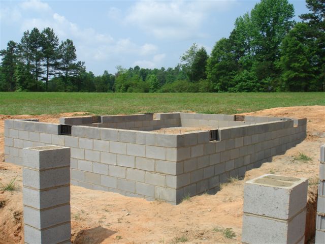

Here are some pictures of the block foundation.
I finally got to get my hands dirty and have started the "One Man vs One Building" experiment.
The block took me three weekends to complete and was not as difficult as I imagined. The first course was very, very slow going. This was my own doing as I was very concerned that I started out square and plumb.
After the initial learnings, I got into a routine and it went fairly smooth. I have respect for people that do this for a living, I am fairly young but my back and hands were killing me after.
Mistake number 3 - CMU block will wear through a cheap pair of gloves in a hurry.
Mistake number 4 - Having water onsite would have been nice. I had to make trips to the swamp/pond on the property to get water for the mix.

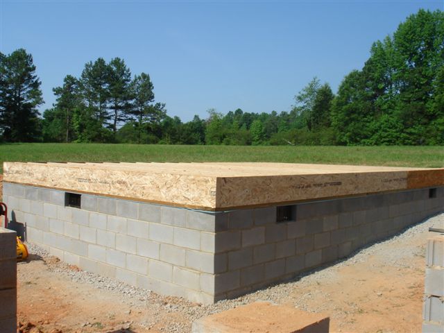

Floor Joists -
The span of the structure is only 16 ft. I had planned on just using conventional lumber to do this - actually I looked at using some salvaged timbers, but quickly got priced out of that idea.
I also got the skinny from the local inspector here in town. It seems some of my problems stem from my engineering letter itself.
Long story short - My brother in-law is an engineer. He is not licensed in NC, but did the Engineering letter for me. I believe he was trying to help me out (who knows mayble he was trying to screw me), but he over engineered the piss out of this thing and then had a NC engineer stamp his letter.
Well - the local inspector tells me "You shouldn't have had your engineer be so specific. If an Engineer says it in his letter, we are going to hold you to it. We don't want the liability."
Since me brother in-law got so specific as to name the brand name, type, size, etc of individual fasteners, lumber, etc. I am being inspected on these things. Turning out to be a pain in my ***.
In fairness, the inspectors are nice people, but simply checking a box vs using some common sense.
Anyway, the floor joists are pretty straight-forward. I-Level Joists spaced 16inches on center. The back 8ft of the structure they are spaced 8 inches on center. I am guessing this if due to the stair case being in the back half of the structure.
You can see from one of the pictures the grade of my field and why I opted to go the foundation route vs slab. (Also the tractor in the background :) )
The IJoists are then banded with standard Band Board.
The work in the pictures below took me a weekend to do.
Lesson Learned - This work was not at all hard. The IJoists are very light and easy to work with; however, I am finding myself not working "smart".
I am going at this as an individual project, but am taking longer than it should take. As an example, I could have cut all of the joists to length all at once. I didn't - I would cut one - install - repeat. Hindsight - Not very effecient.
No worries though - I am having fun and so far at least holding my own in the "One Man vs One Building" experiment.
