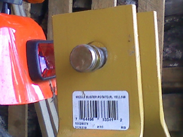

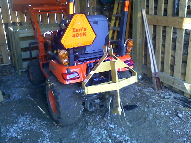

I got to playing with it today, thought I'd post a couple pics. I also have a question. The lift pins are standard cat 1, but the hole for the top link pin is huge, the head of the pin will fall right through it. Kinda like they drilled it for a cat 2 or 3 pin. Anyone ever run into this? Is there a pin with a large head that won't fall through or will I just have to weld a doubler plate on it with a smaller hole? The spacing is also really wide like it's meant for a bigger top link.

Looks like you got the pin in wrong hole. That pin in pics should go on tractor and the one with shape almost like an L goes on the implement top link. If you had a BX24/25 you would know what I mean. The pwrbyd hose is in the way and MUST use that striaght pin on the tractor side only.

I don't have one with an L shape, the pins on either end of the top link are identical. Came that way.
I was watching one of Everything Attachment's videos and noticed they used a big fender washer on the pin to keep it from falling through the hole. I just closed the hole up with a bushing so it would be the proper size.
