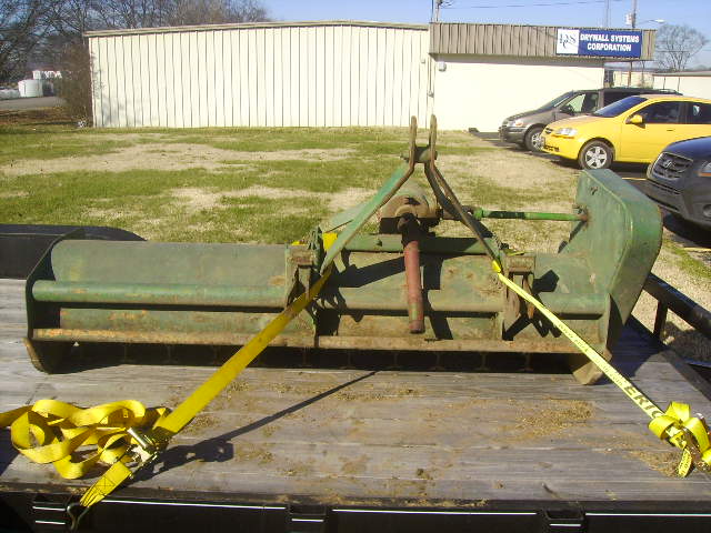

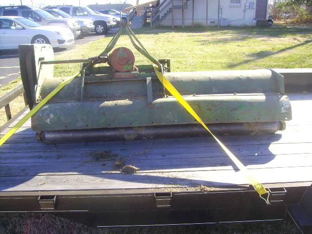

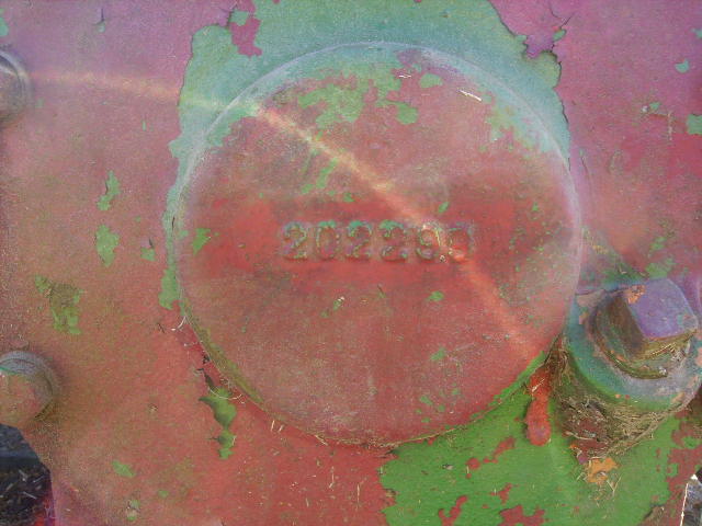

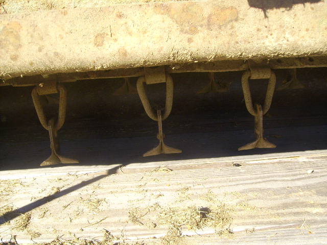

I recently found a flail mower for sale. I posted a thread with pictures asking for information. I only got one response from Halftrack identifying it as a Ford 917. I decided to go ahead and take a chance and bought it. There is an identification number cast on the gearbox cover. It looks like 202299. Is that the model number? Any information you can give me on this mower will be appreciated.

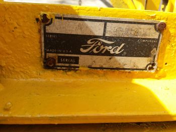

My Ford has a 1.5 x 2.5 Alum. tag on it serial and model no. on it.

I can't find a alum tag on mine. Only the number that is cast on the gearbox. Any help identifying the model of this mower is appreciated.

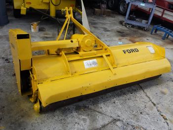

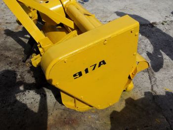

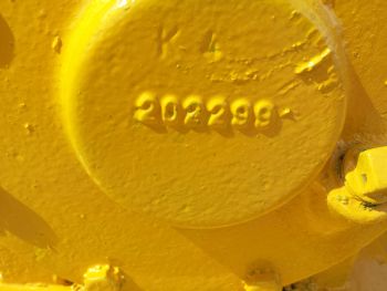

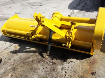

I think that may be the part number of the cover. Here are some pictures of a 917A, from a google image search.
https://www.google.com/search?safe=...Mower-Tractor-3-point-attachment.html;350;263

I saw the photos after responding to your IM. Not sure, I'd have to see a side view of a lower three point lift receiver. If there are not small holes above and below the actual lift pin holes, your can rule out 917H. Having said that, hopefully the parts diagrams can narrow it down to a 917 or a 917A or a 917L

Thanks Greg. No small holes in the lower 3 point lift receiver. I'm sure it's not 917h.

Definitely 917 or 917A. If bracket for gearbox that bolts to frame is Z-shaped, then 917. If U-shaped, then 917A. Gearbox was used on 907, 917, 917A and 917H. 917L had a square gearbox. 917H has a welded back skirt instead of bolted.
