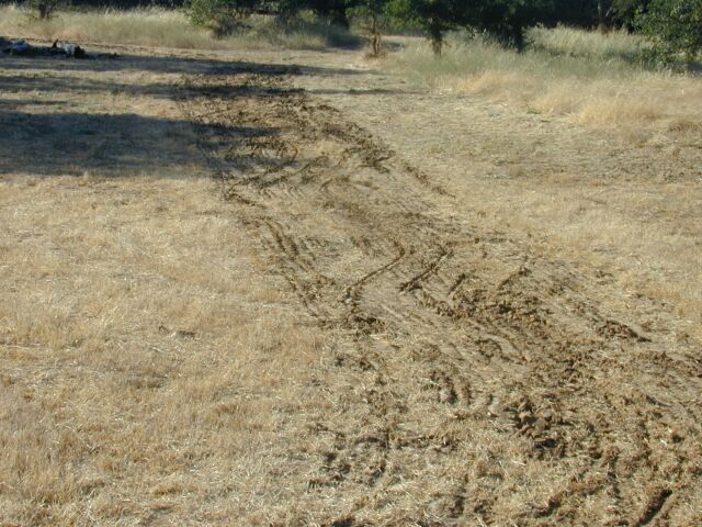

I've got a Bushhog 48" box @ 430# w/ fixed rear blade. The BX23 will pull a full box of dirt but I do drop the tires to 15 psi and load the FEL.
I don't know how my soil compares to Tom's or Barry's but in summer, it's almost bullet proof. The shanks and blade just glance off. (I replaced my 3 hole shanks w/ 4 hole ones, BTW, so the teeth are well below the cutting edge.) I had no choice but to work some dirt last summer and here's what worked for me. shortening the toplink as far as possible to get the teeth real aggressive. Then I made a straight pass(es) ripping .... with VERY little effect. Then I made half a dozen zig zag passes to try to get one or more teeth hooked into the ground. Then another straight pass, maybe. I was always able get the ground to breakup, but it's a lot of work.
The attached pic shows the pattern and the beginning of soil breakup. From this point on, the dirt will rip completely up. As Barry said, sometimes a tooth will hook and stop the BX but I could usually power thru it or use the 3PH to pop out a giant chunk and the zig zag technique seems to help keep the machine moving when snagged. Usually the ripped clods were BIG (for a little tractor) ... up to volleyball size. Once ripped, I took my ranch truck, w/ over inflated tires and pulverized the clods.
