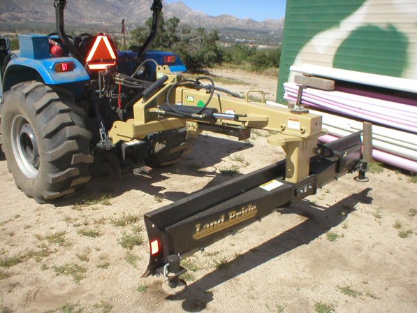

I liked the Land Pride GS1572 Grading Scraper because it has teeth and looks like a combination of the Frontier LP1172 land plane and the Frontier BB2172 box blade. They're all similar weight too, around 550-575 lbs. But I do have iMatch on my tractor so would the JD implements work better with my setup?
The implement I plan to buy next year is the 300cx FEL. I know that the box blade can be used as a ballast box for the FEL. Can the grading scraper or land plane be used the same way?

Anything that hangs on the 3pt is a counter weight. The scraper would work well for you.

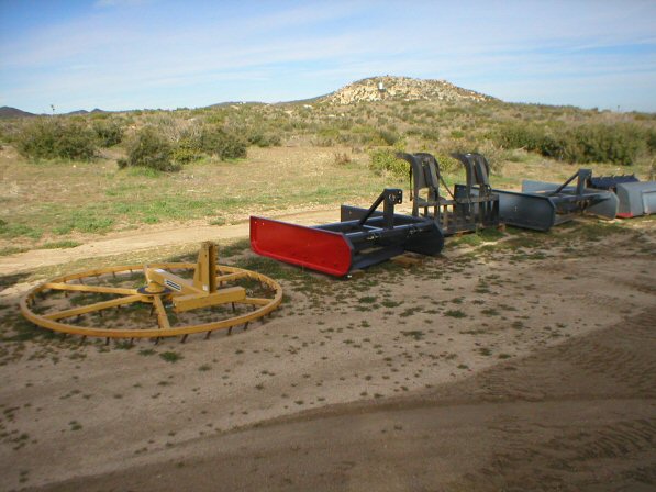

Could be the soil Im working in...I find the rear blade too light...doesn't cut adequately compared to the BB
   / box blade, landscape rake, or rear blade #28
Very well might be the problem, My Land Pride RB45108 weighs in at 1166lbs. It works day and night difference compared to my previous MidWest rear blade that was around 600lbs.
Tug, the JD with the tracks, is that your work machine?

Yup it's a weight issue.
The JD 7430 is owned by a snowmobile club that I belong to...I and 15 other members operate it and a Pisten Bully Trail Edge grooming over 100 miles of trails in the Tug Hill area
