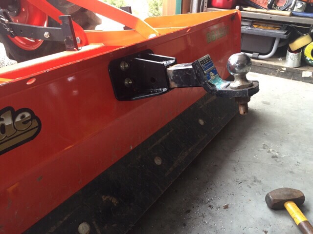

Nice build!
Added a hitch receiver when strengthening the 3pt hitch. Haven’t used it to pull a trailer yet. Might have to put a hitch on the land plane because it’s the implement of choice.
