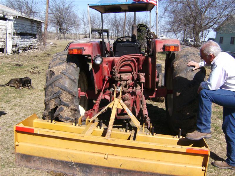

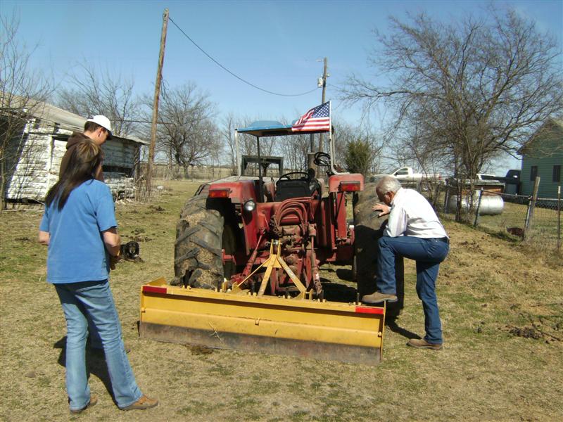

Took pics of the ruined tire and the tph set up. I don't see any type of stabilizer bar or chain to keep the box blade from swinging into the tire again. An easy enough fix, aside from the cost of this "learning experience". The worst part of this is that I'm in the middle of some projects that will have to wait until I get a new tire.
Pic 1 - close up of ruined tire
Pic 2 - tph set up
Pic 3 - tph again

From the picture it looks like you wrecked your good one. Bummer.
   / Box Blade Oops! #24
The cheap route would be to simply use chain. I have done this before and found it is not only several hundred dollars cheaper than going with OEM parts but just as effective.
I use a clevis with a screw pin on one end and adjust length for different implements by moving it a link or two either way. If I need the length to be somewhere in between two links, I give the chain a twist to take up the slack.

looks to me from the pics the right lift arm is bent a bit.

Kernopelli - That's just what I was thinking, the chain I already have, get a couple of quick links and I'll be much better off than before...like everyone else I'm working on a budget here
Good eye! the right lift arm is bent a bit but not enough to keep things from functioning proper, so it goes on the list

I just replaced the turn buckle and arm on one side. Seems that the turn buckle unscrewed and was lost then the remaining piece of arm became bent. I was lucky as the 3ph arm only chewed a few chunks out of the tire on one side.
I will be more proactive from now on.
