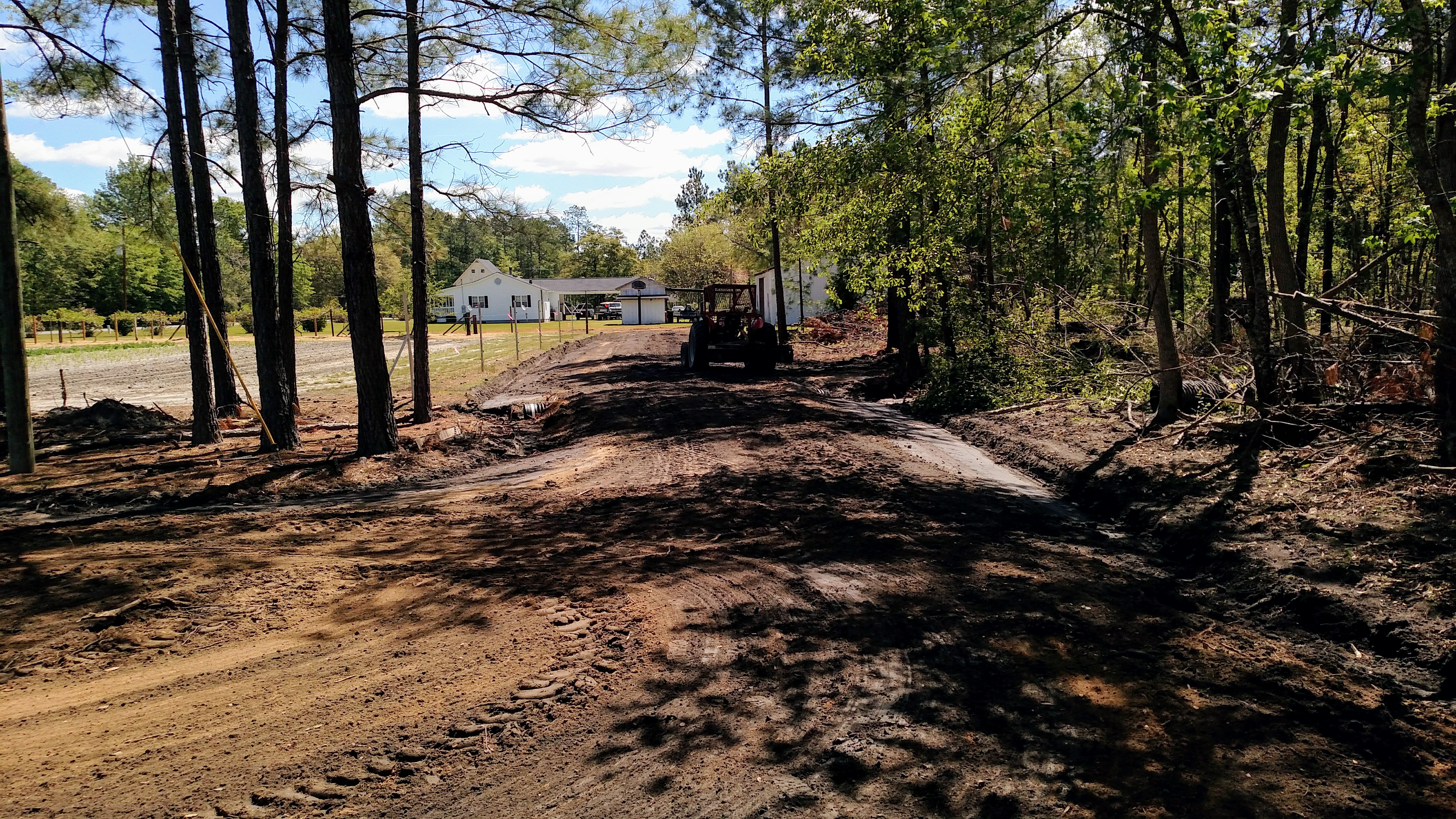

How I approached my implement acquisition is to have a solid plan of what needs to be done vs what would be nice to get done.
I bought my property after it had been neglected for 15-20 years. There were a multitude of beetle killed trees that needed to come down. A skidding winch was bought.
After they were removed, the grapple was bought to manage the massive slash piles.
The road into the property needed reshaped and graveled. A heavy duty rear blade was bought.
Now, after burning large slash piles every winter a chipper is next in the list. I’m not a fan of burn piles because of the time involved gathering limbs and hauling to a slash pile then the 2-3 days of it burning.
In the future, I need to widen out trails to get my tractor down the ridge for more tree extraction. I will most likely rent a mini ex for this project because of the side hill conditions.
