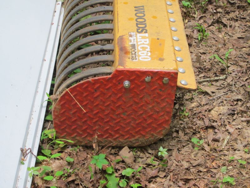

I was going to mention a rake...as the angling ability makes it also work well for dealing with washboards...
Mine is not near as sophisticated as the York model...but I do have some wheels that I rarely use with T&T...I did modify the ends to make it a "box-rake"...eliminates windrows etc...

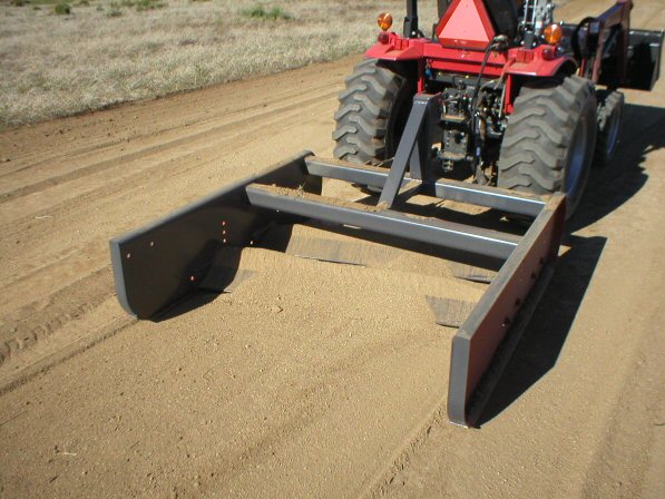

Sorry for the diversion in this thread,:sorry: I just felt that some things needed to be clarified. If I were you and your road is the MAIN concern, I would be getting a land plane grading scraper. (LPGS) The absolute best implement to maintain a natural surface road IMO.
If other tasks are also a concern , then a box blade ends up being the best all around grading implement. Sort of the Swiss army knife of grading implements, can do a lot of different things, but the correct implement for a certain type of job is typically better.
