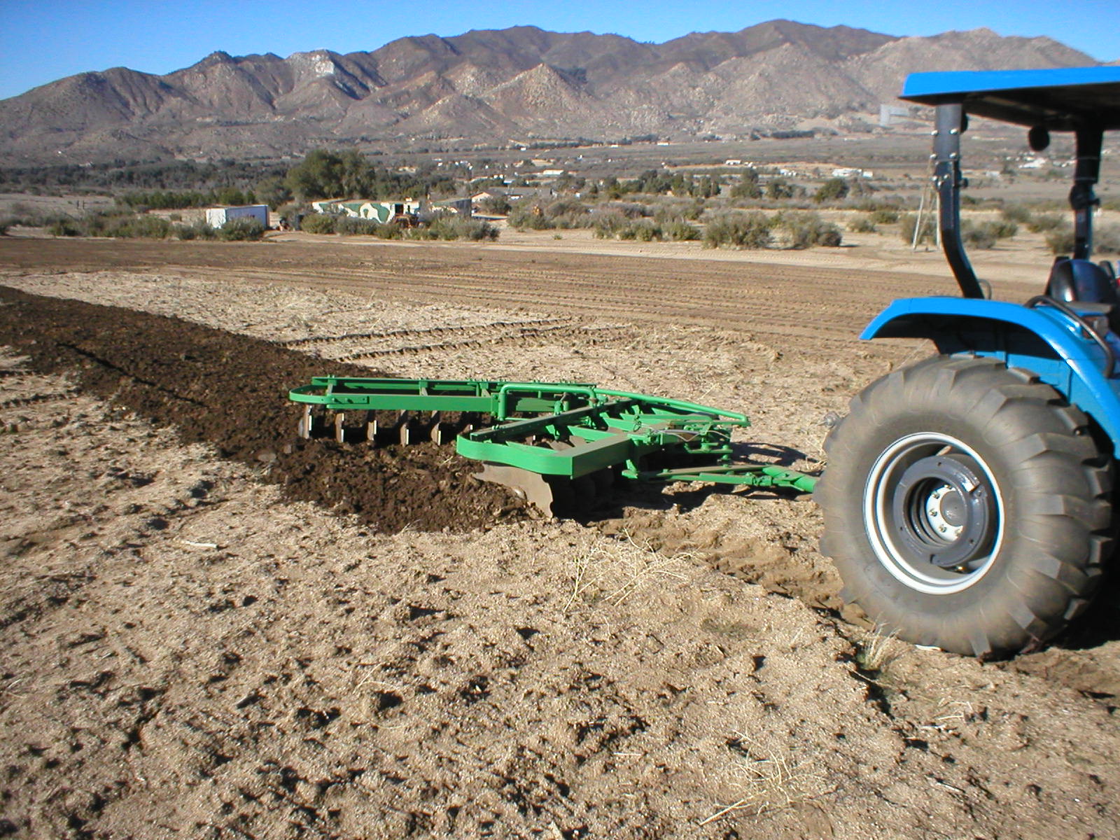

This is contrary to my experience...regardless of the implement BB, RB, Rake...I find somewhat wet materials much easier to work with...
Maybe we should be calling it moisture content. When I hear wet, it sounds like the ground has to much water in it. (to me anyway)
First 3 pictures the ground is damp and about perfect for working. The last 2 pictures the ground is way to dry IMO. But I am a weekender at best and have to work with what there is when I have the time. We don't get much rain out here, so not much choice. :(
