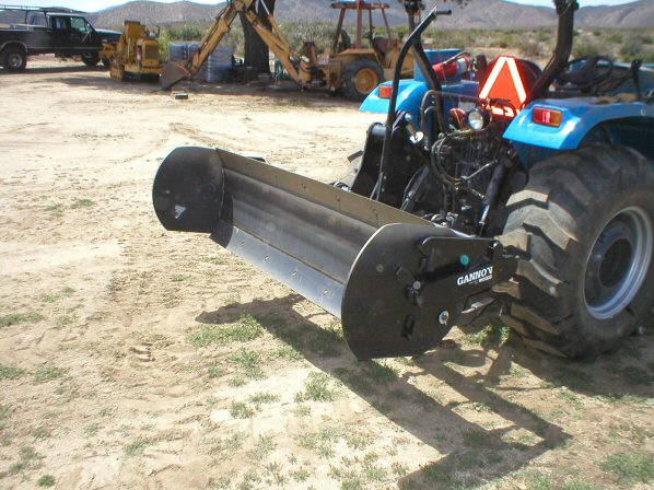

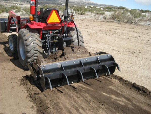

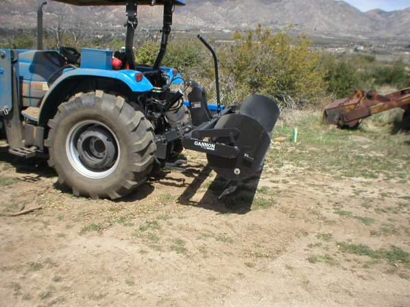

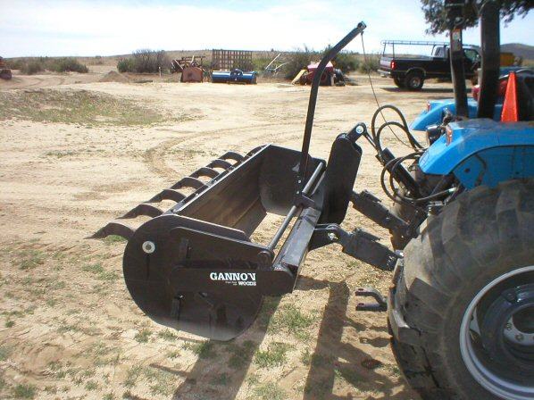

I highly recommend roll over box blades or (ROBB).
I happen to have 3 of them all built by Gannon. A 36" for the garden tractor, a 65" for the 32hp tractor. (very similar in size and power to your CK) and an 81" for the 75hp machine. Gannon no longer builds them, but the Dirt Dog units and the like are the next best thing that are still available.
Without going to hydraulic actuated scarifiers, these ROBBs are a great multi use implement. (y)

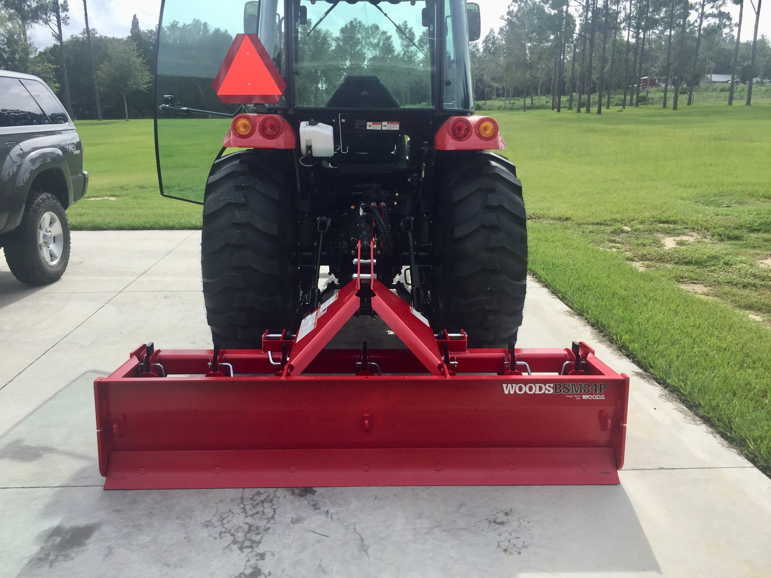

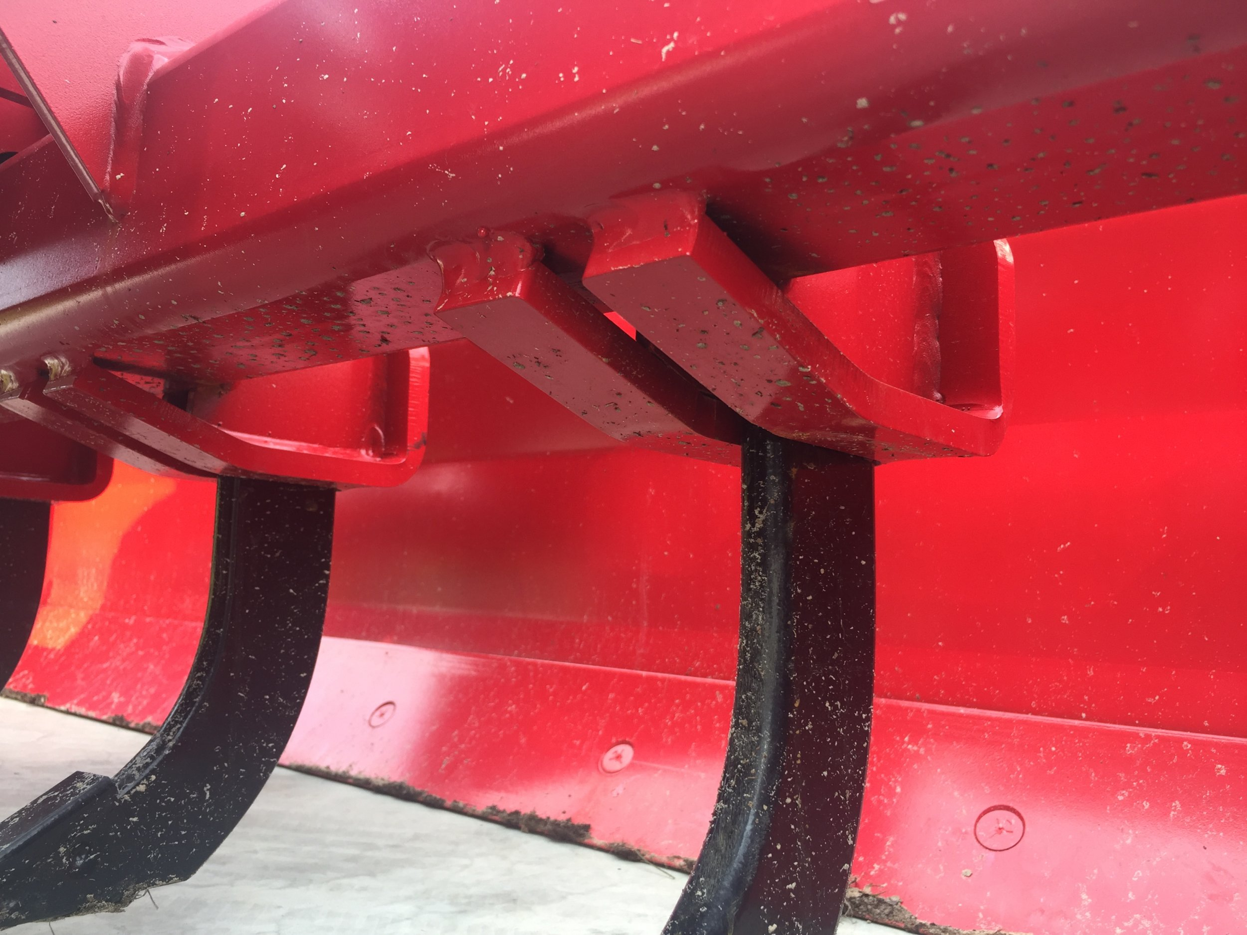

I have a Woods BSM84P with stationary blade. It comes with the hinge mounts if you want to switch to a hinged blade down the road or from the get go. It's also CAT 1 & 2 compatible. I consider this unit one step below the Woods/Gannon units with the hydraulic scarifiers.
The BSM84P weighs about 100lbs per foot, with my seven footer coming in at 750 lbs. It is 200 lbs heavier than 7 foot units you'll find at Tractor Supply or Rural King. The Gannon 7 footers come in around 1,200 lbs and would probably be too much for my 55 hp tractor. My tractor tires are 6 feet wide.

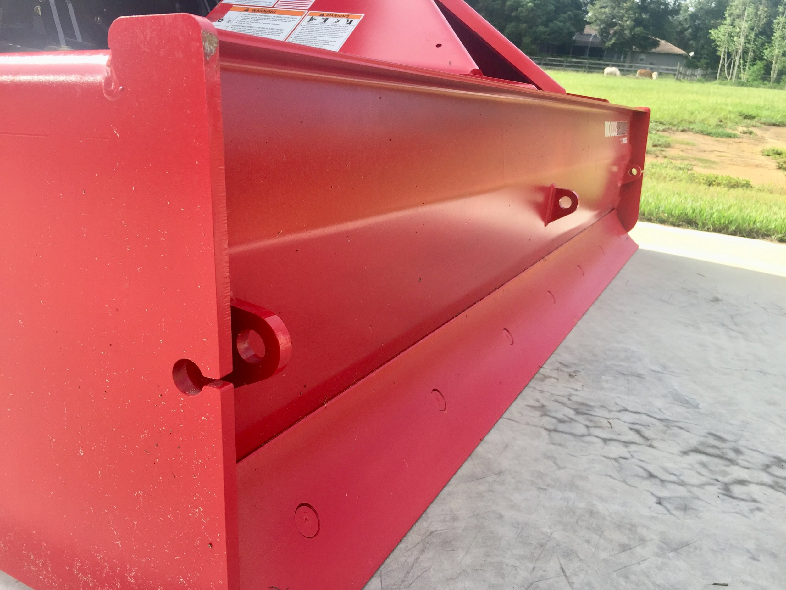

What's the three anchor points at the back for? The aligned hole on the side panels seems to allow a rod through them, but what for?
/ Box blade #10
Those are the mounting points for the optional hinged blade that Woods offers. You just remove the stationary blade like I have on mine and switch to a hinged blade.
