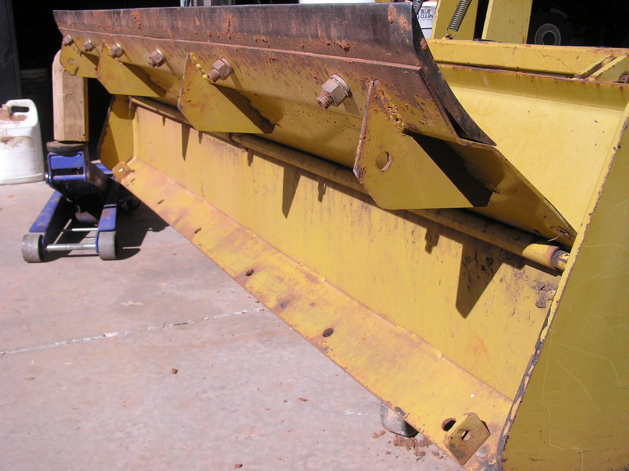

If I did put hydraulic top link on, there wouldn't be a need for a hinged unit,right?
I have a hydraulic top link on mine, just makes adjustments super easy on the fly.
Example: Angle the box blade to scrape / collect material.... get to the end and turn around.... now adjust the box blade angle tilting back, with just the rear blade touching. This is done to "smooth" what you just moved previously.
With the hinged rear blade, it will "float" across the material, regardless of any up and down movement of the tractor.
With a fixed blade, if the front of the tractor moves up an inch, the box blade will go down an inch....causing possible "ripples"
Having both a fixed blade previously, and now a hinged blade, I will never buy another fixed blade. Just my opinion....

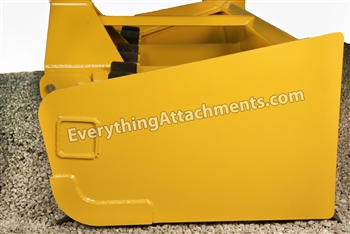

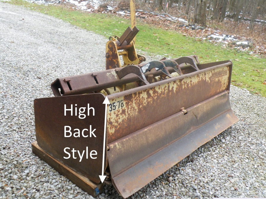

Another thing that isn't mentioned very often is there are two basic types, Standard and High Back.
This is high back with a hinged rear blade:
EA calls theirs "High Horsepower"

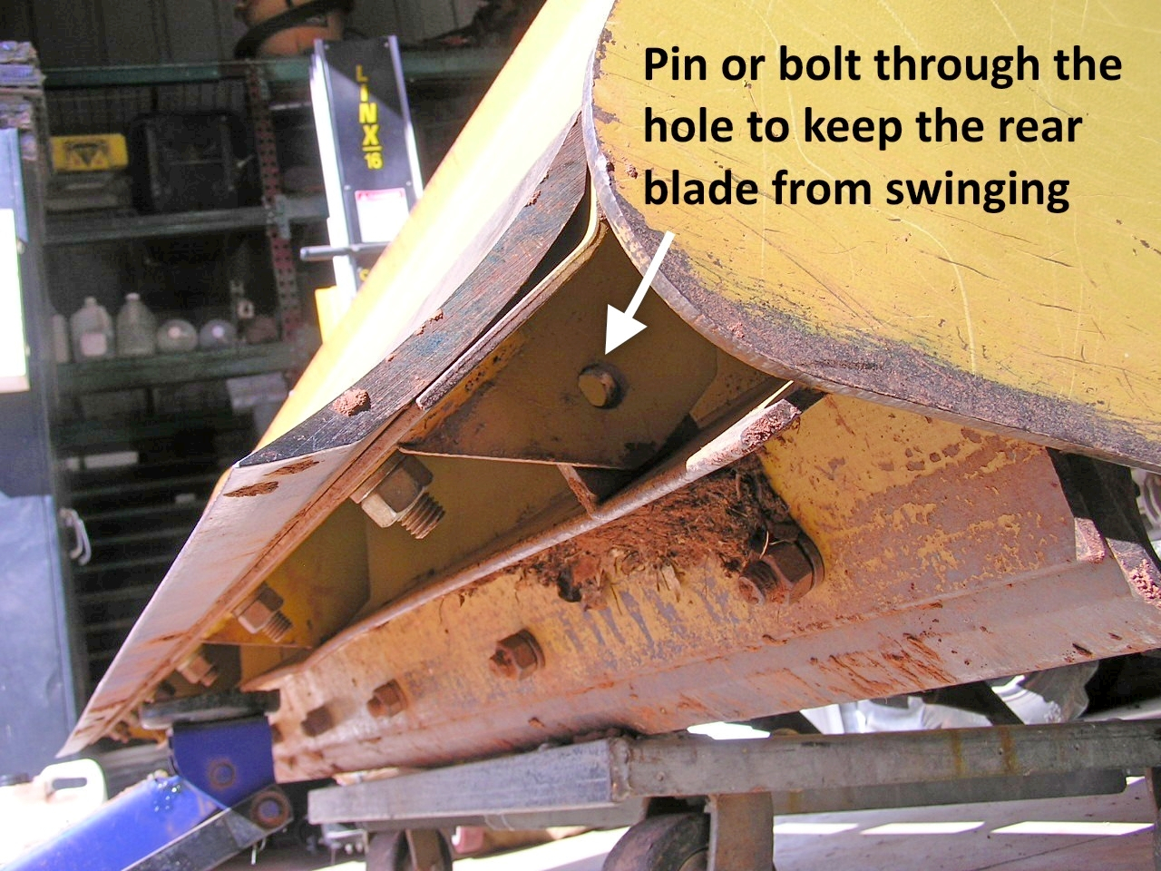

Here is Ted's explanation:

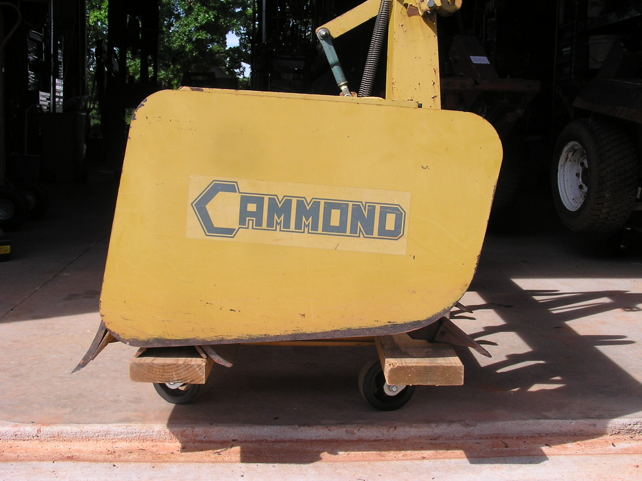

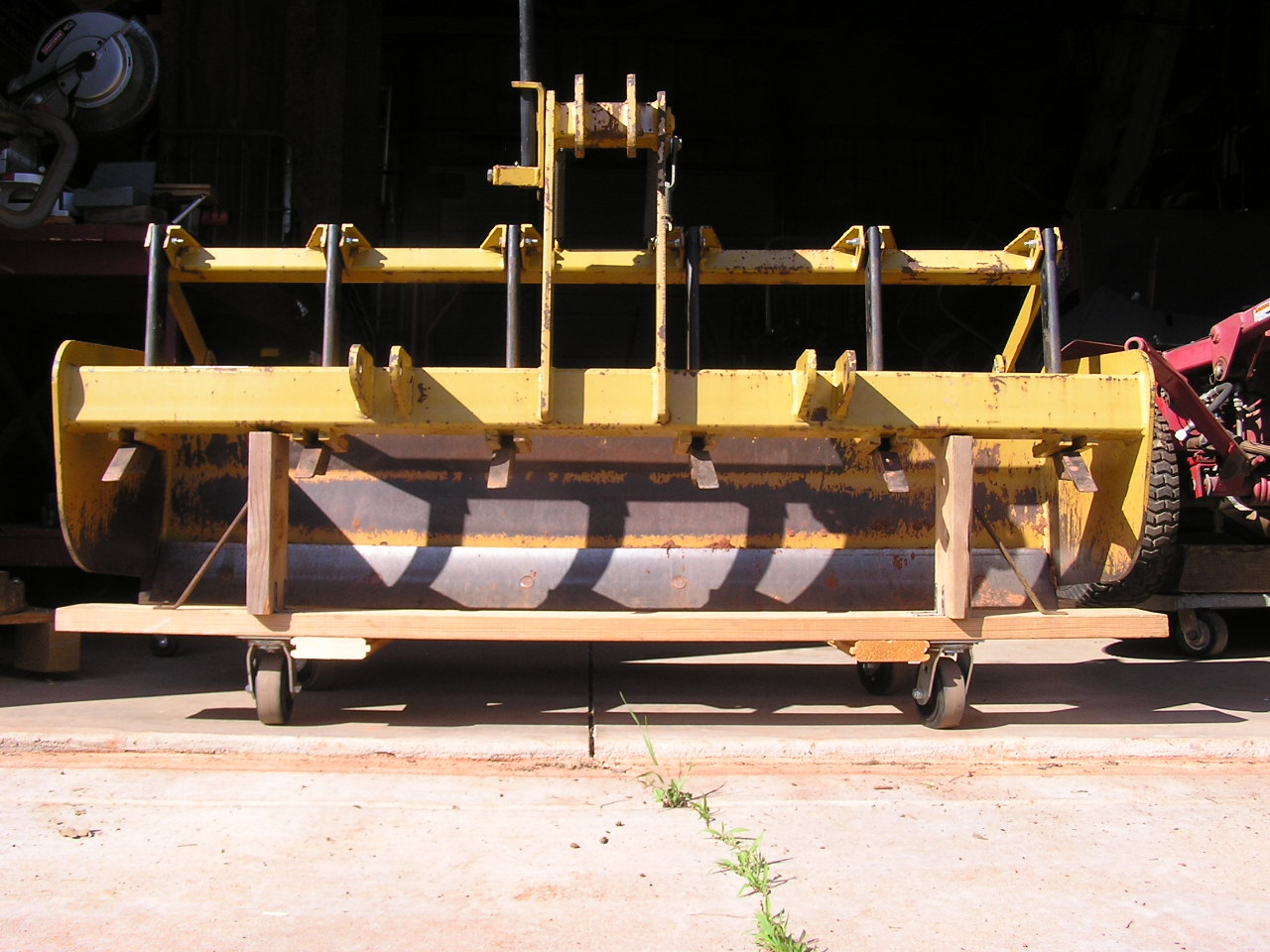

   / Box blade #29

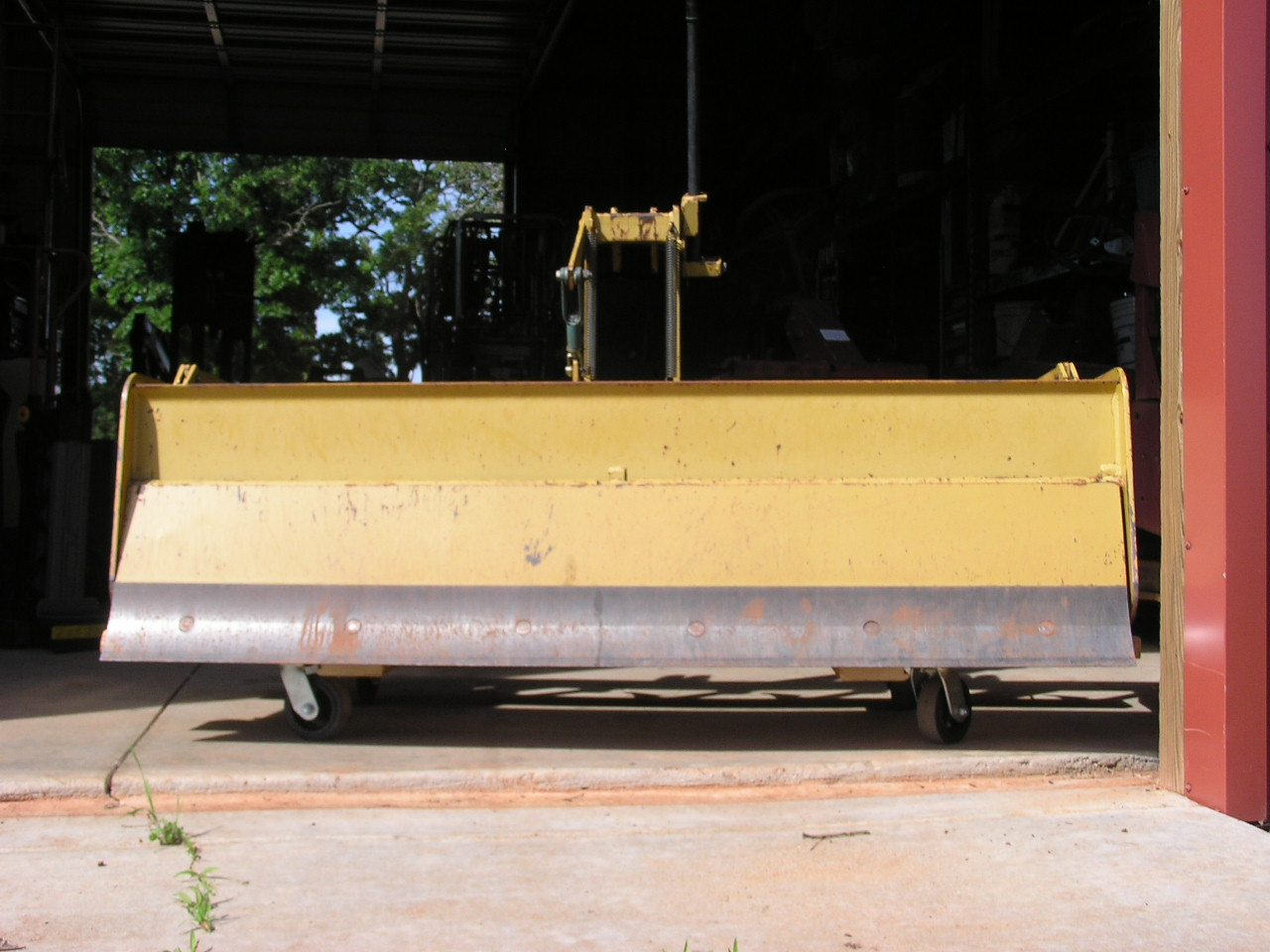

My 6' High Back is fixed or floating:
   / Box blade #30
For best finishing results I run backwards. Hydraulic top links should be standard issue on ALL tractors! If you go really slowly you can feather your way along (you really need to concentrate and be coordinated in your actions/responses).
