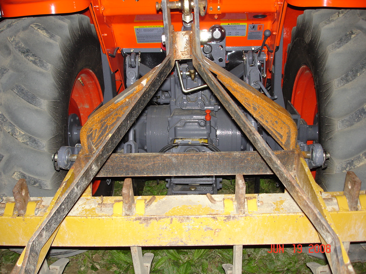

John, Here is a link to when I bent them and straightened them out.
Pushing In New Roads and Trails
It was while I was cutting in some new roads and trails. I used a hydraulic press and a little heat to straighten back. Then I used some old scarifiers from my boxblade and welded them onto the bottom. The scarifiers are slightly heat treated so they are very strong. They are just under 3/4" thick or so, and about 2-1/2" wide. I put them where the links would most likely bend.
Here are some photos of the links before the repair.
These show them straightened out and the "T" reinforcement. I put several heavy duty beads of weld on them. No problems since that repair.
Rob,
Well, I finally got my bent lower link straightened and my neighbor welded a 3/8" by 2" length of square stock steel to the bottoms of both links in the form of an upside down "T", as you did with yours. They are now painted and back on the BX1800. I sold my neighbor my 6 foot blade and bought a 5 foot Woods blade to replace it. I think my tractor will handle the smaller blade a little better. I followed your thread on the roads you put in with the box blade (pushing the box in reverse) that initially bent your lower links and am looking for any update on problems you have, or haven't, experienced since the reinforcement was made? The attached picture probably doesn't clearly show both the inside and outside views of the links, but the square stock is positioned equally on the link and a weld bead run down the full length of each side. Dyer, retired

Very Nice reinforcement job...a few weeks ago when I bent one of mine up on my 3520 (had less then 10 hours on it at the time)...I had contemplated strengthening them up, But I figured I was using the machine/3pt in a way it wasnt designed and strengthening the arms would just make a bigger/more expensive piece break...
Spudland_Dave,
Thanks, I'm lucky to be surrounded with neighbors that all have tractors and repair materials. We heated the link to "red hot" and pounded it severely! It took several heating and pounding sessions to get it back to where it was straight. We ground the surfaces before we started welding, so it was all clean to begin with. My neighbor has an old stick welder and we got very good penetration with the welds....I'm doubtful that they'll fail in my lifetime.
It makes me wonder....if it takes that much to straighten it, how much force there was to bend it. I had the same concerns about reinforcing the links and breaking something more expensive, but opted for the reinforcement after a lot of reading and communication with 3RRL. He created pretty much an entire road on his property primarily box blading in reverse. I got my repair idea from him and he's had no problems with his (up to April...from the thread I was reading.) I'm hoping he'll give us an update, but anticipate he's not had problems because he's always very willing to post what works and doesn't work, with pictures to demonstrate. I bent mine on an ice packed snow bank last winter when slamming the blade into it. The ice pack caught the corner of the blade and stopped everything up quick....bent the link and turnbuckle chain link also. I plan to take it slower and have gone to a smaller blade also. Pushing snow with the blade in reverse works very well for me on the lighter storms and I also plan on trying some skids on the bottoms of the blade, so it won't be digging in prior to the ground freezing up. My thought was that if 3RRL is o.k. with how he's using his links after the repair with such a significant project as he was working on,....I should be o.k. pushing some very light stuff and not slamming the banks. I'm just hoping that I don't get to try it out too soon, ha!
John,
That is a magnificent job or reinforcing your drag links. Heck, I'm jealous now because they look way better than mine ever did!:) They should work for every kind of bulldozing you'll be doing in reverse without any problems. I really don't think they will bend ever again.
Great job!
You asked how mine were doing.
I've used them over and over again since that reinforcement, which was almost 2 years ago, and still have had no failure. None with the drag links or where they're attached to the tractor. Also since that repair, I started all the ground prep for our log home construction (which is done now). So I'll bet I got about another 150 to 200 hours on the boxblade making the pads and trails I built since then.
