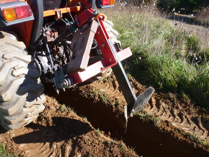

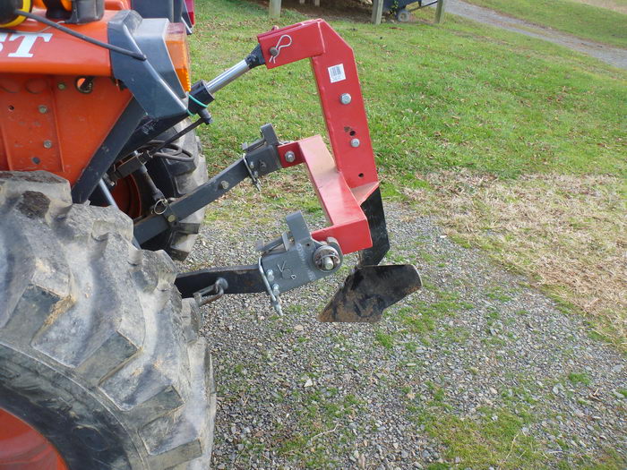

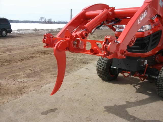

   / Box scraper = chisel plow ? #16
You mean like this.

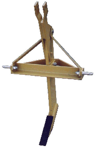

   / Box scraper = chisel plow ? #18
Those subsoilers like in JJ's last pic can be had at TSC for under $200. $149 if I remember correctly.
And if you have access to a welder and some scrap steel, they arent that hard to make either.
   / Box scraper = chisel plow ? #19
That's what I was thinking; a longer bar the same sizes as one of the scarifiers and make a point (optional)on it and blow a hole through the flat side for the pin. If I had a TSC in AZ I wouldn't have to make my own; but what the heck that's half the fun.:thumbsup:
Thanks for the help!!
RC
