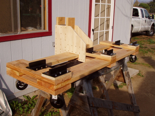

It seems that this attachment is the most off and on piece of tractor equipment that I own but it is almost the last to receive a dolly!:confused2:

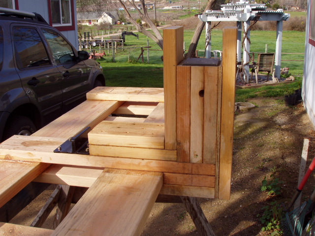

First photo shows the general 2x6/2x8 wood "glued 'n' screwed" build and the framing of the box scraper top link beam stand. That's a 1/4" steel plate on top of the column and inside of the 2x6 securing ears.
Second photo shows the 3/4" AC plywood gussets to secure the column in place. Since I have added a top (and tilt) cylinder which lifts the back of the box scraper high and over the column, there was no need to create a hinge point to lower the column as I did on the 8' York rake dolly which was built before I installed the T'N'T cylinders.
Also shown are the three sets of box blade stops-the aft three are raised 3/4" to allow for a level placement. Each of the stops are welded back to back 2"x2"x1/4" steel angles with an added 1"x1/4" steel flat bar welded to the edge of the angle to allow the bolting and not interfere with both of the box scraper front and back blades.

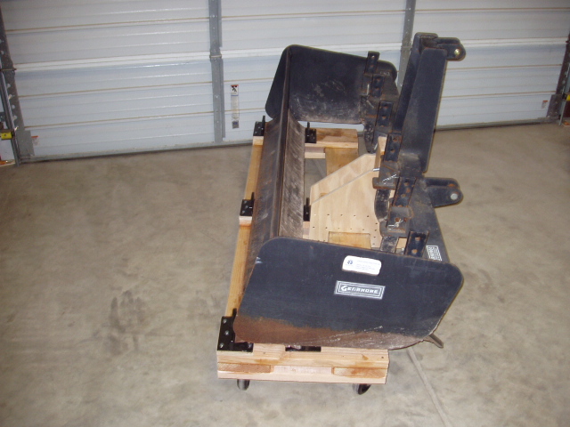

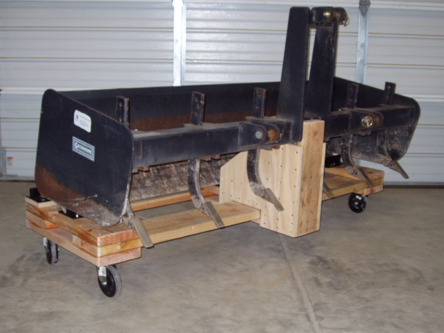

The last two photos show the box scraper on the dolly. Althought the BS looks drop skewed on the dolly, the top link beam is level and seated well on the 1/4" steel column plate. I guess that's just the way they build them.
It's now nestled in the shop with the rest of the dolly family-backhoe, wood chipper, York rake and wood splitter. Still to go-offset disc and rotary mower.:eek:
