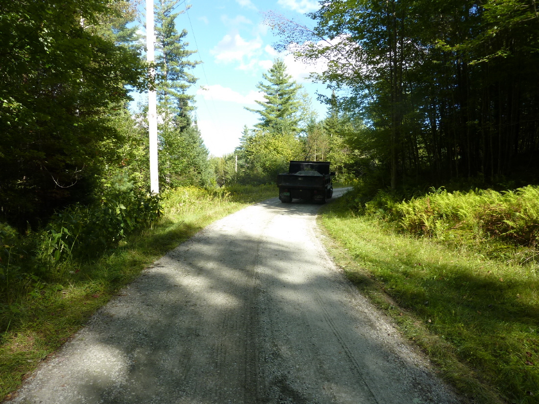

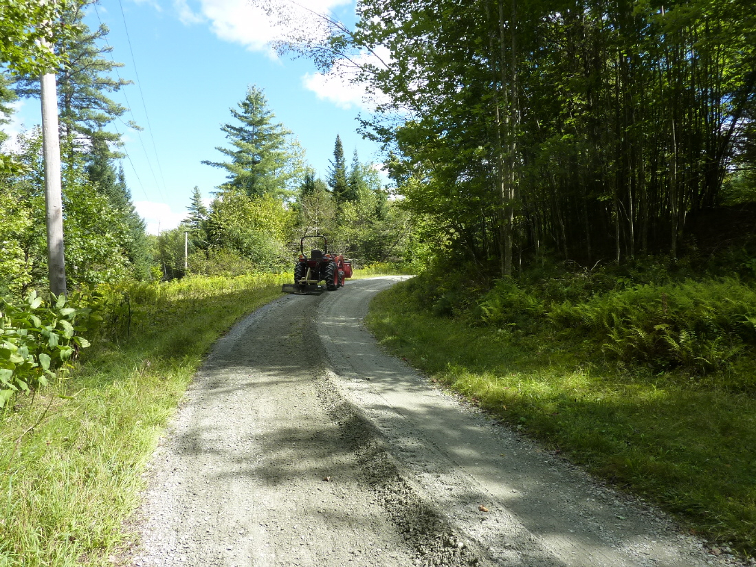

I don't have a video but I have some pictures. This is what works for me when I add gravel to a road. It is 3/4" crushed ledge gravel mix which packs hard with time.
1) I tail gate out a load of gravel. My truck is small so it's 3-1/2 tons per load. Then I pack what I just dumped with the truck. In this case the loaded truck with the next load is used to pack.
Then if the road needs shaping I use a blade to get the contour I want. Here it is a crown. First the left side - shown. Next the right side then spread and blend the berm in the middle. I omit this step if no shaping is needed.

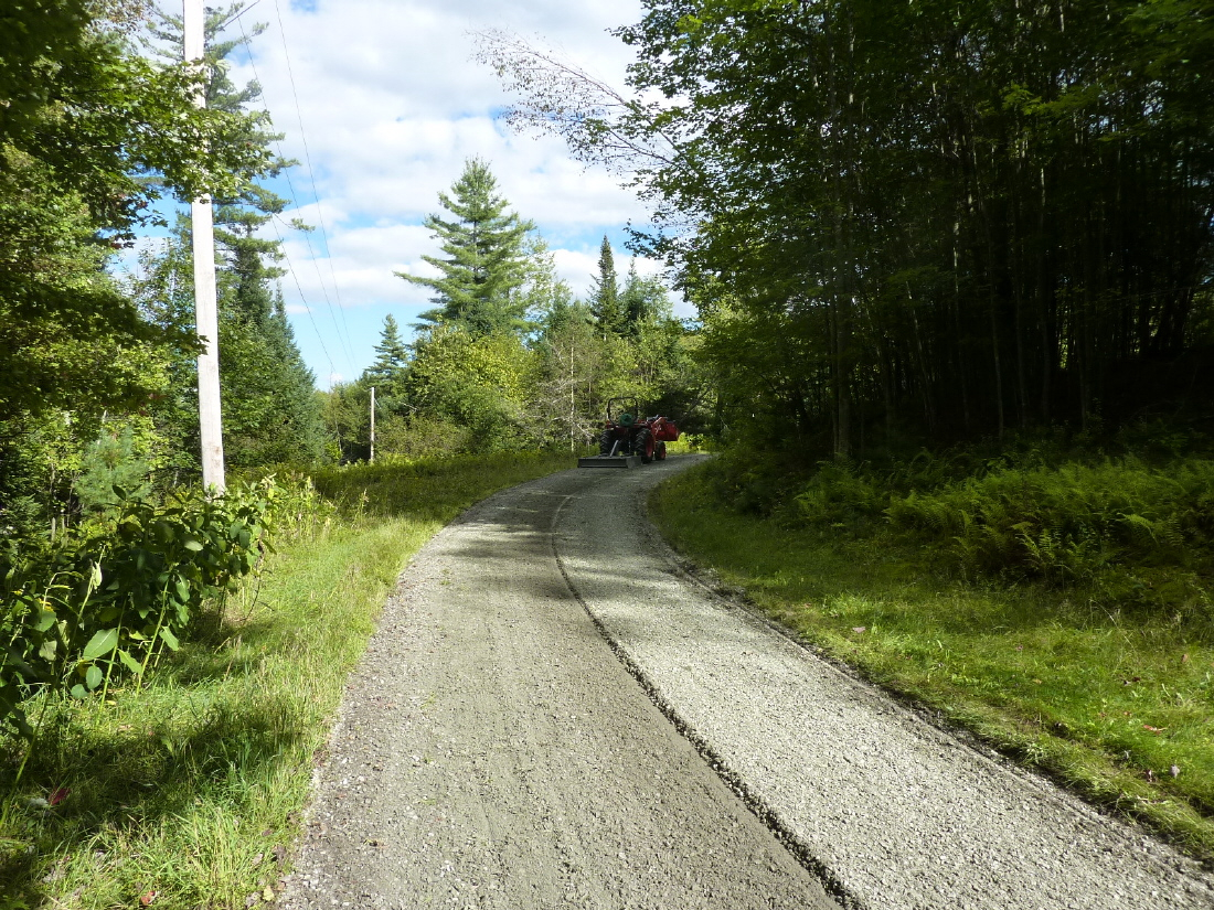

Because my blade work is often a little rough I even it all out with my land plane. I lengthen the top link to lift the front blade a little. Notice the front of the runners a slightly off the road and the front blade has much less material than the rear blade.
And this is how it looks after the LPGS pass on the left side.
It didn't come out like this the first time i tried. It takes patients, practice, and experimentation to develop a system that works for your situation. Stick with it - The vast majority of landplane users will tell you it is the best road implement they have. I have 2 rear blades, a box blade, and an LPGS. I also have a lot of road to maintain. I use all three but the landplane gets used the most by far.
Hope this was helpful.

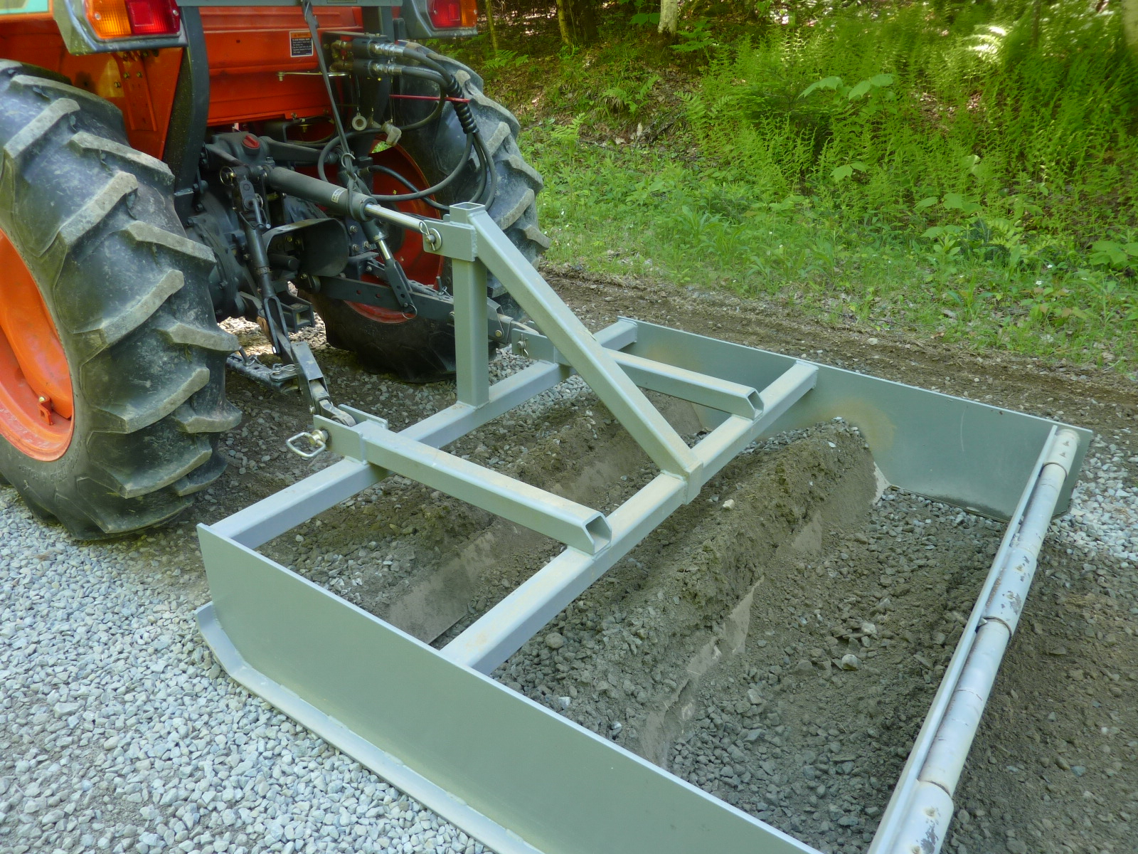

I put that tail gate on as an experiment. It is hinged on top and can swing a full 360*. There is a set of stop pins on the bottom. In the first picture the tail gate is dragging behind the pins and the grader is running properly. That is both blades are full all the way across with equal amounts of material being moved by both the front and rear blades.
This is the way I normally run the grader. And I think it is fair to say that the tail gate is doing nothing to make my grader any different from a commercial one except add about 90 lbs (which is a good thing).
What I discovered is that the tail gate is heavy enough to hold back sod while the heavier gravel passes under it. As seen here.
So while doing road maintenance cutting along the road edge sod like this
I can run along until I get to much sod and then lengthen the top link (hydraulic) to stop cutting and let the gravel run out. I lift the grader leaving a pile of sod and use the tail gate against the stops as a blade to push it off the road.
In the spring after mud season when roads are full of ruts and holes I swing the tail gate over so it rests against the stops on the inside. That way it holds excess material in the box and pulls it along the road until it drops into a low spot. It also works on a washout where a pile of loose gravel ends up at the bottom of a hill. I can pull it up. Like a box blade but not near as efficient. I don't have a real good picture of this but this is one where I am trying to remove a slight crown caused by driving down the middle all the time. I want the road flat but sloped so water will run left to right - high side to low side. Note: the land plane is not good at destroying crowns as many believe. You have to work at it.
So the tail gate isn't a great improvement but it's useful.
