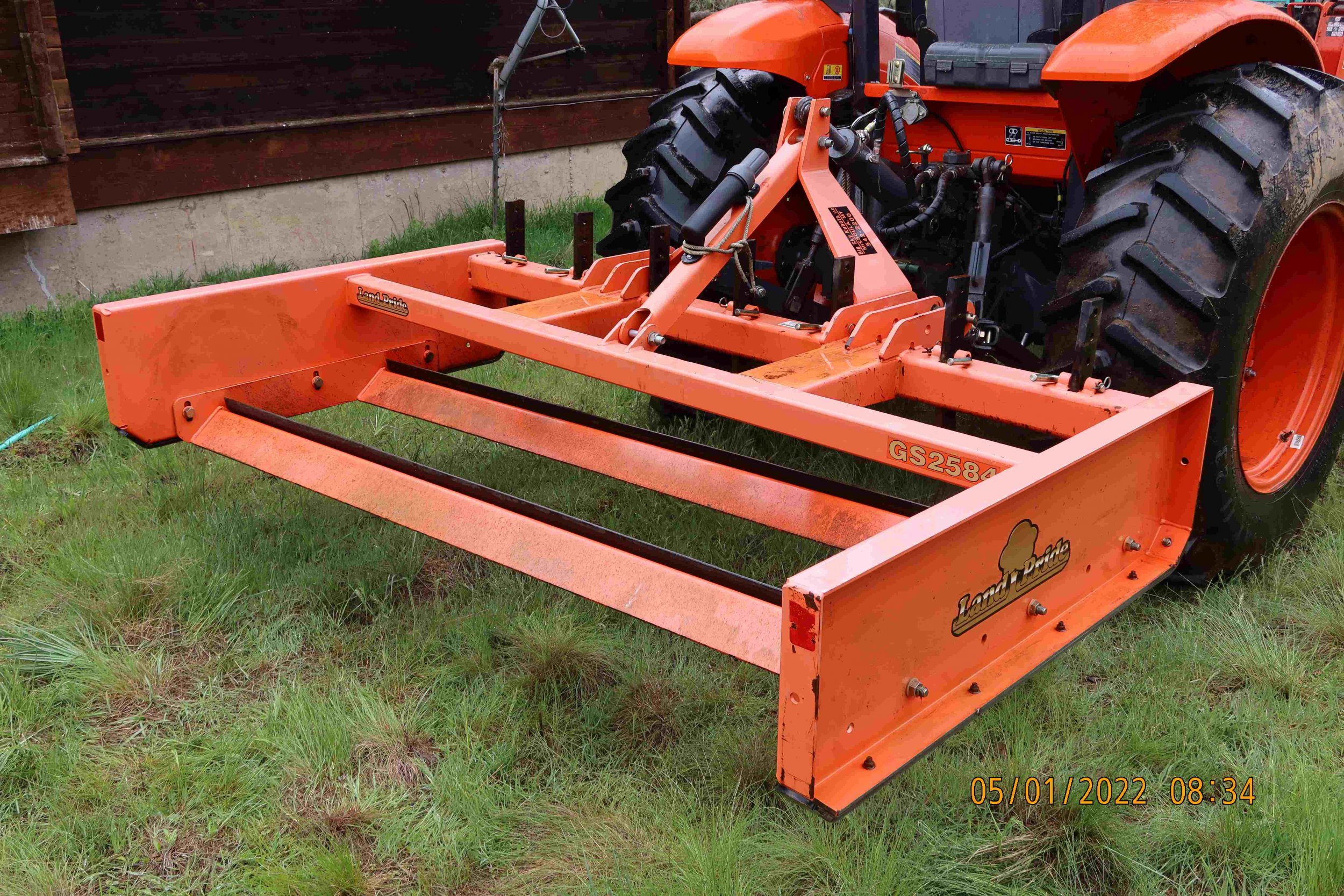

Just to be certain we are talking about the same implement - my LPGS.

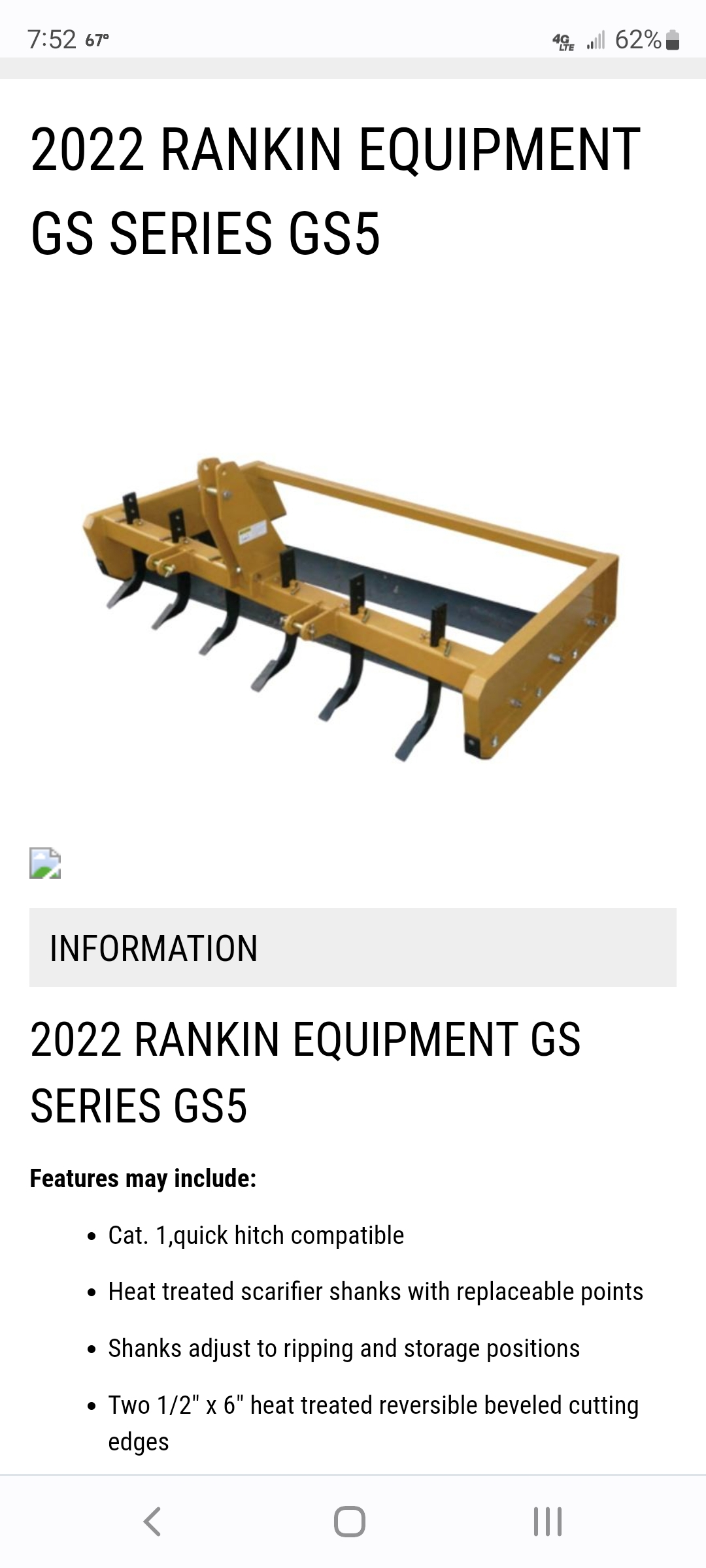

When you say it fills up and flows over the sides, you must mean over the cutting blades? Which is the intent. To prevent stockpiling at the pavement you may have to change the tilt of the blade and do one side at a time pulling away from the pavement. Practice makes perfect. Would love to see pics.
/ How to use a Grader Scraper #5
This one

Yes, same thing as the Landpride Landplane.
