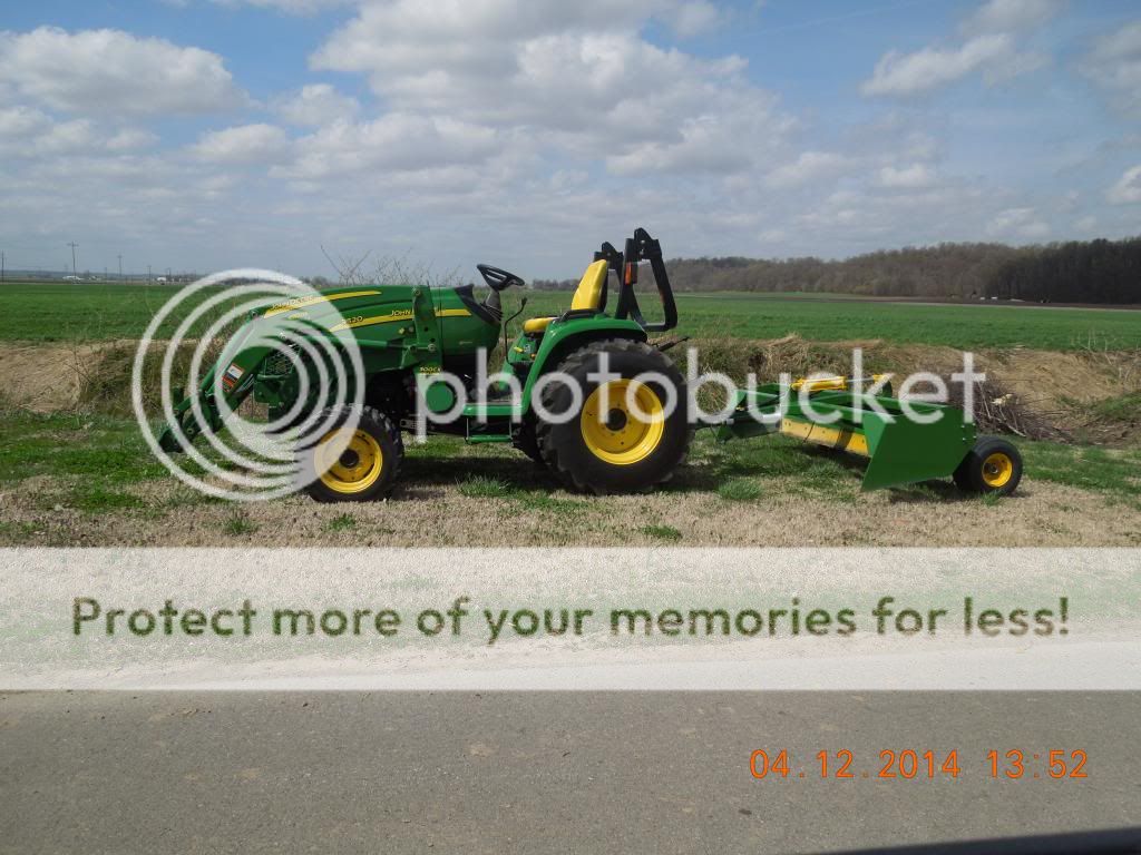

I don't disagree with the utility of a LPGS, I just can't justify one as I have a really good box scraper as well as a 10' drag scraper like the one below on my neighbor's tractor that works great for my needs.

Larry's 10' drag scraper is a very good tool in the right hands. Especially if it has hydraulic tilt on one wheel to tip the box. If you look at his picture you see what I mean about the cutting blade being between two axles. What the front axle of Larry's JD does has very minimal impact on his drag scraper. So when he hits a hump with the cutting blade it tries to cut it off with no input from the operator. Or when the box is full and the blade comes to a low spot it automatically dumps material, again with no operator input. Makrs an inexperienced operator look like a professional. And the best part is it will move material a considerable distance.
