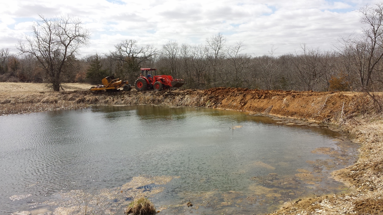

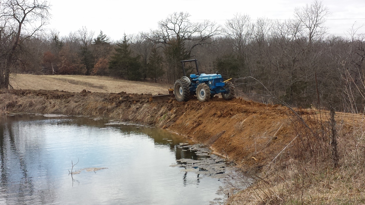

Okay, I'll admit it. I used my rear angle blade today. Raising a small pond dam. Dumping dirt with the scraper. The widening the top of the dam with the angle blade so I don't fall off..... :eek:
Can't do that with a BB or Land Plane. My old blade has the ability to swing the main beam to either side to get the moldboard farther outside the track of the tractor.
