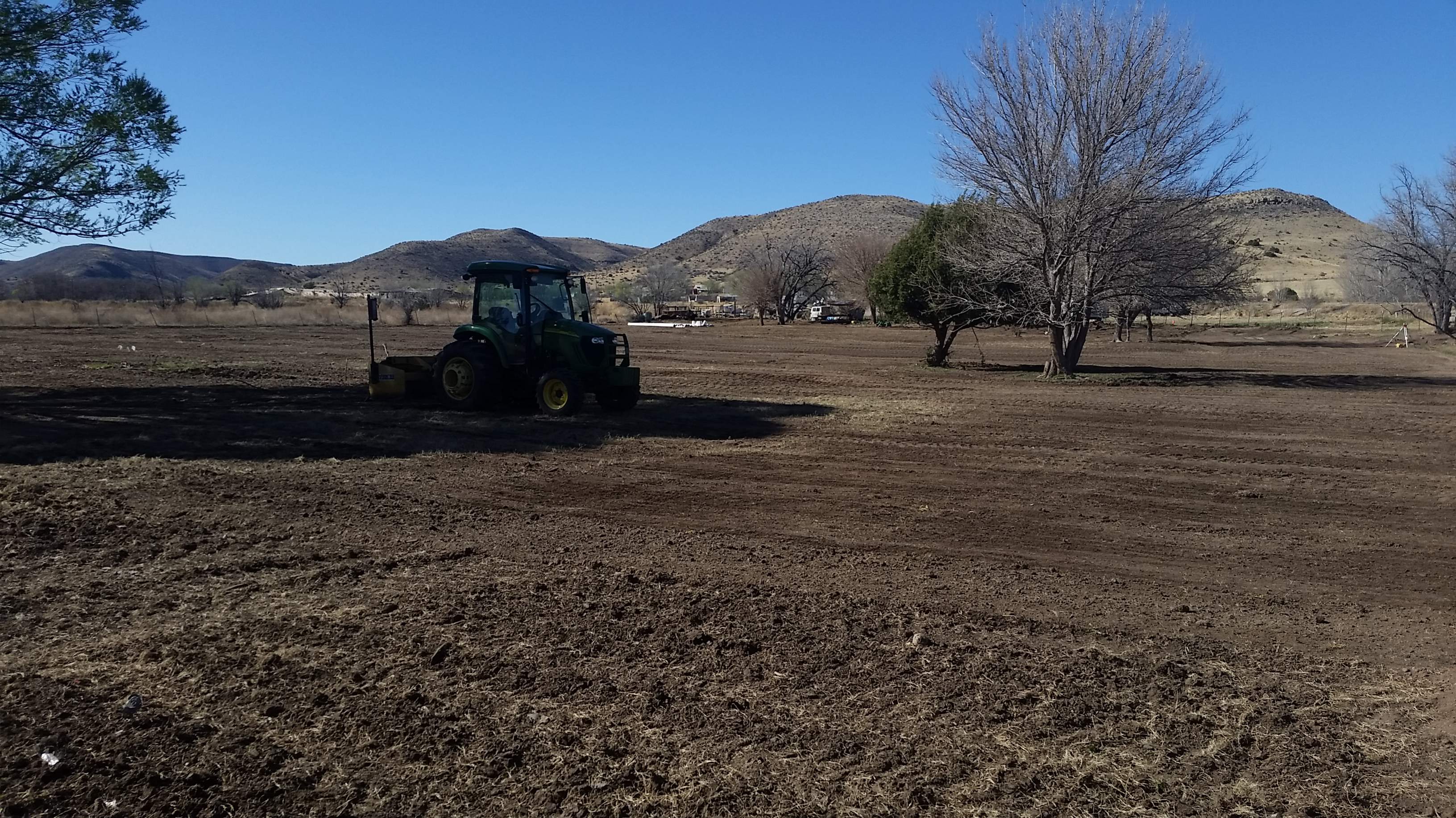

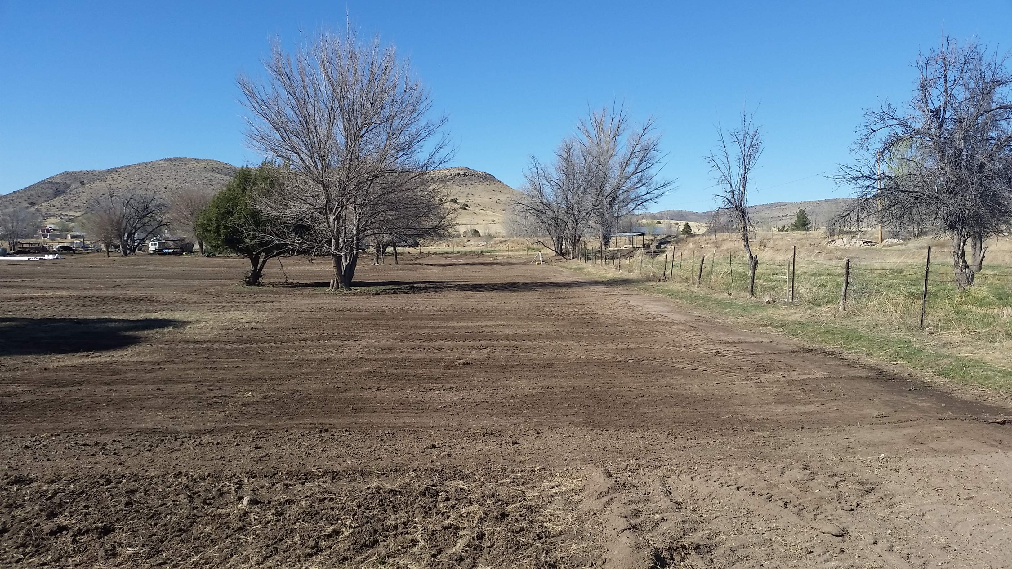

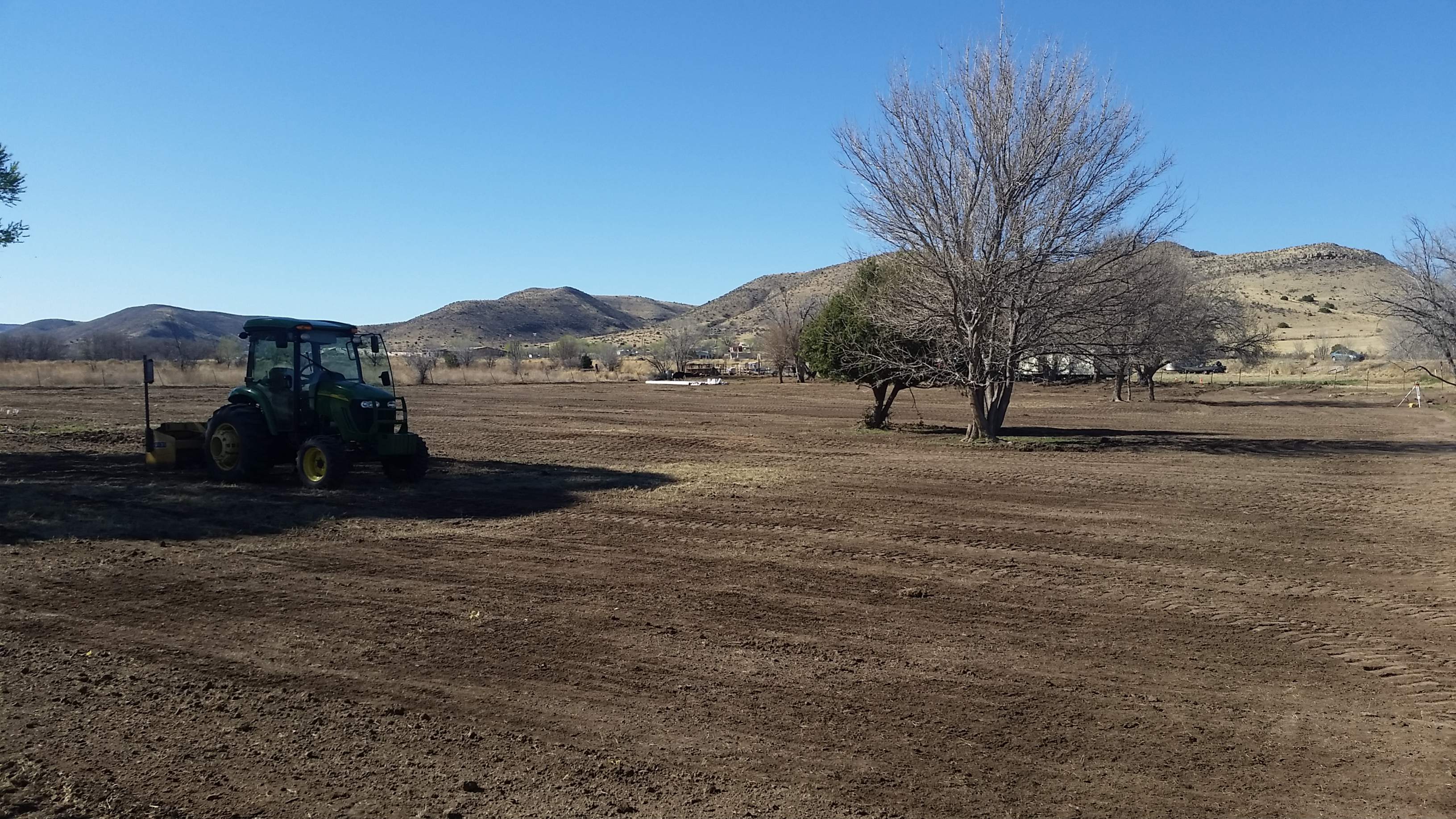

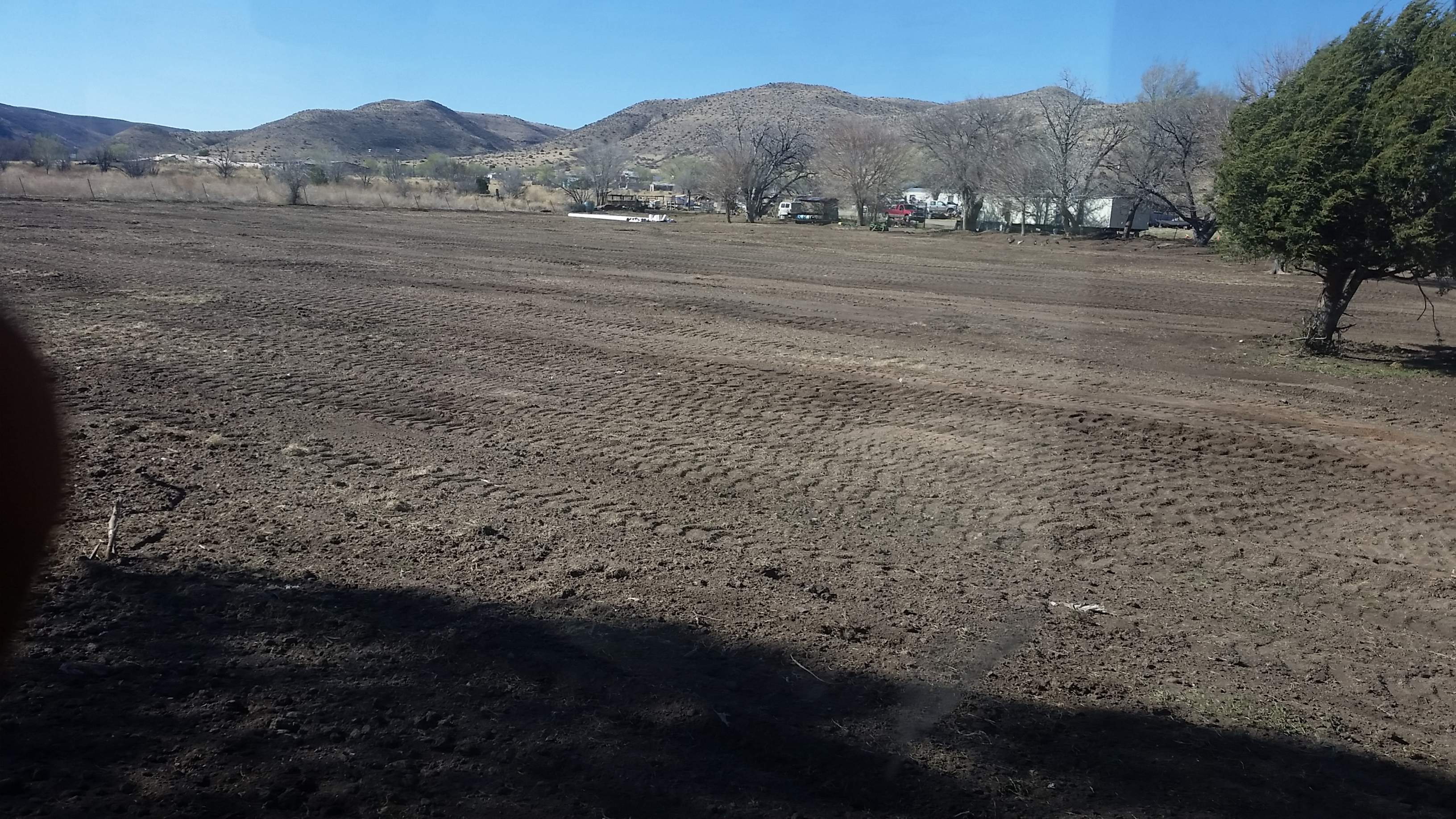

Nothing like seat time to get used to a box blade. Thought I would send you guys some pics of the job I am on right now. The pipe in the background is 12" that I will install next week or so. This is the first pass for the leveling.
Great pics Steve!!!! Anxious to see your results. :)
Nice work as always. If you get bored up there in God's Country, come on down. I'm out weeks and can't even handle all of the phone calls. You're probably the only guy I'd trust to do my jobs besides me. :thumbsup:
No offense intended Richard...I know you have a day job. :D
