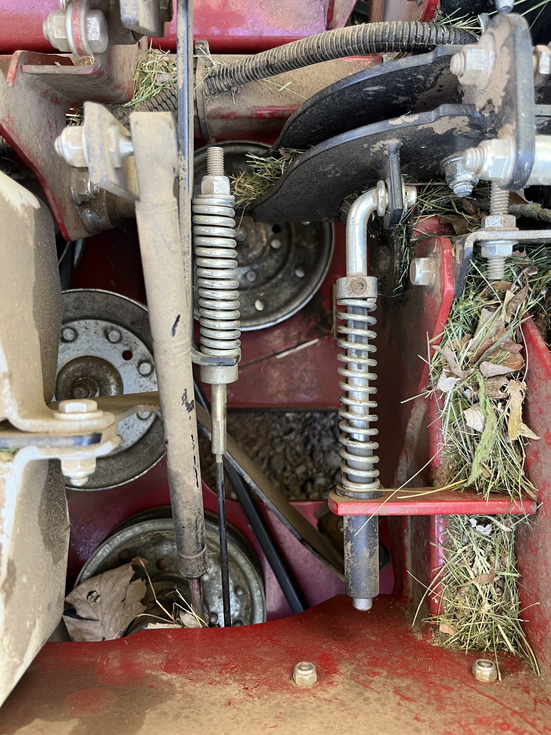

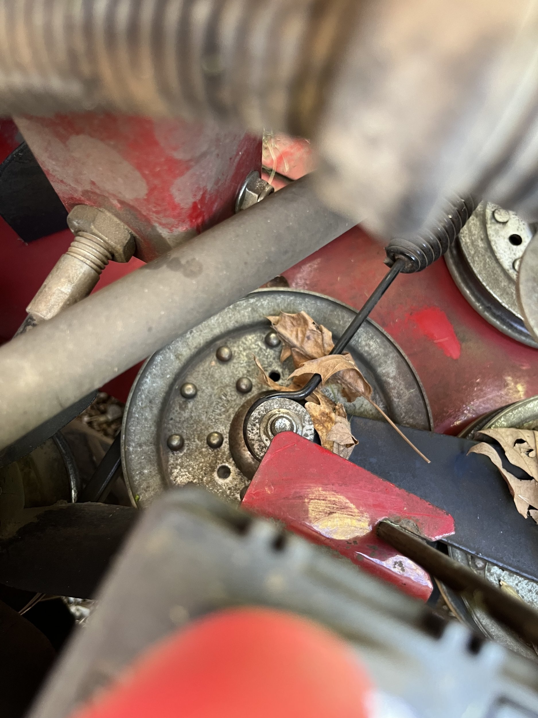

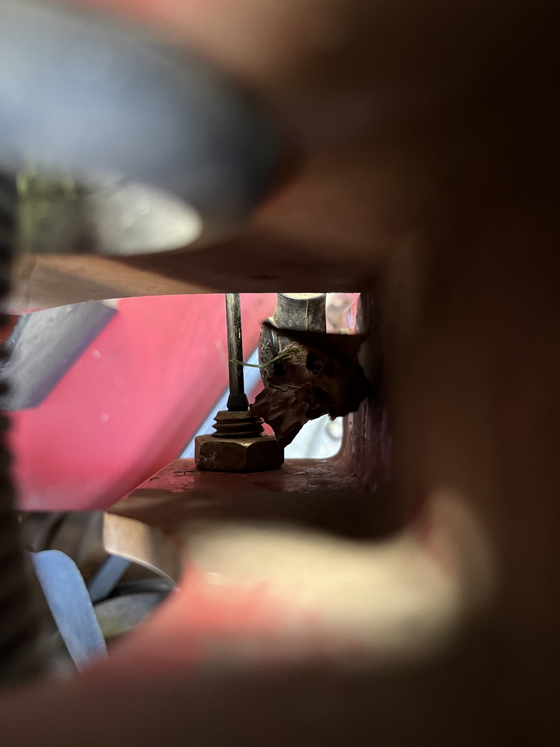

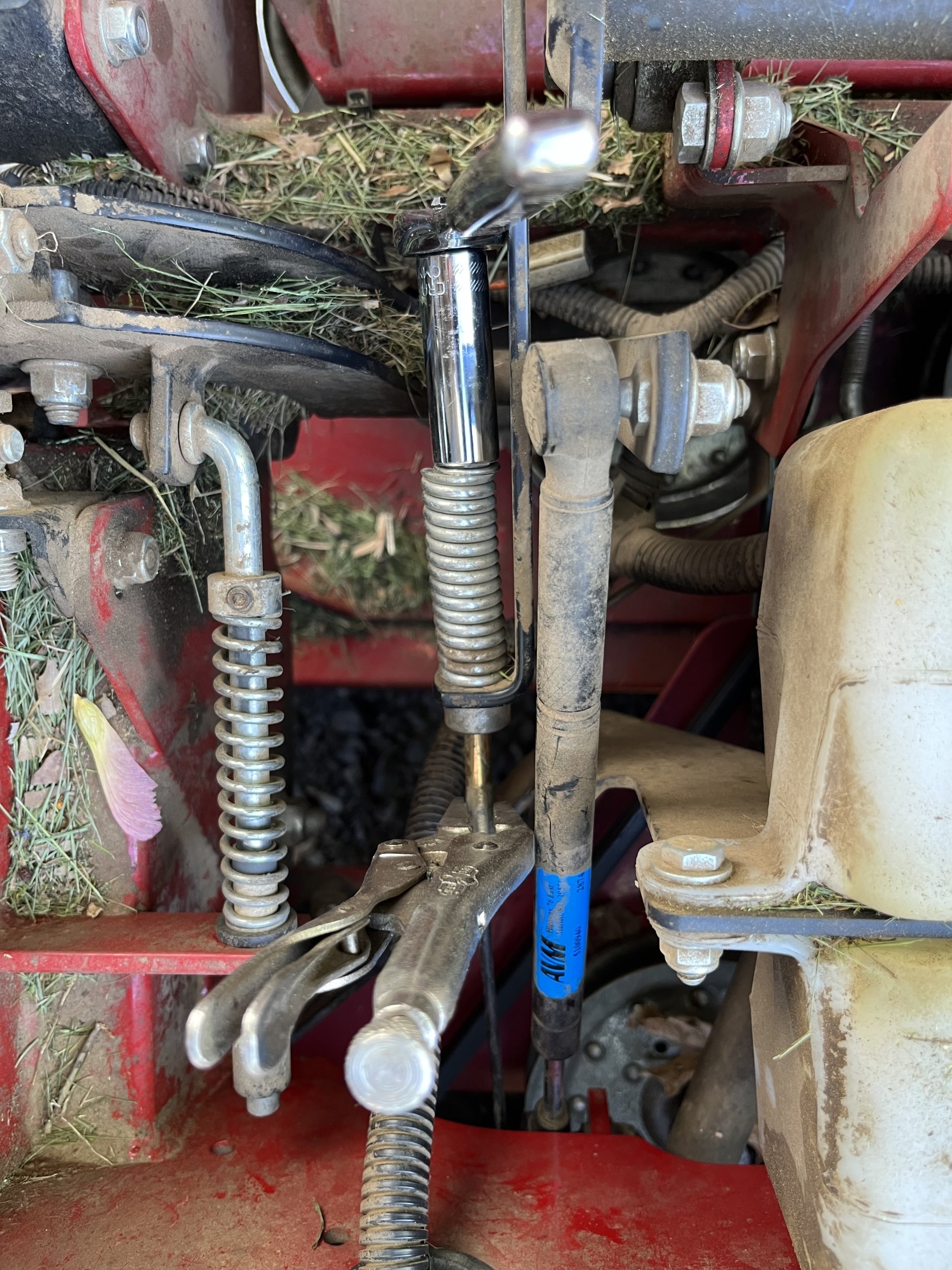

Hey guys,
This year I noticed that my mower was moving around a little on my trailer and when I apply the brake on an incline it also moves. I started looking around and noticed that one of the cables is rather loose. As you can see I attempted to tighten it but it does not seem like it is making a difference and now that spring is about as tight as it is going to get. So not sure if I did something wrong or it needs replacing. The first picture is me trying to tighten the cable and the second is the other side for reference. The other ones are the linkage that leads back to the transaxle.
I posted this to another site but haven't gotten a response and know there is some really knowledgeable people on here so I was hoping someone could tell me how to fix this so I don't have to take it somewhere for something that is probably simple.

It would help if you added the manufacturer and model of your mower. And a picture of where those cables go to. Not all of us know this particular model but if you give us some context and more detail of the type of brakes we can likely come up with some suggestions.

I understand. It was my mistake because when I posted it to the other site it was in the title. It is a 2015 Ferris IS2100z and the brake cables go to Hydro-Gear 4400 transaxles. It may be hard to tell but those are mostly the pictures. There is one other place where the lines are secured down on the frame before you get the to transaxles.

I’d check the actual brake pads themselves if you haven’t already. Make sure there’s nothing preventing the pads/brakes from physically engaging completely (debris or done).

Yes, I am certain. Because when I park on it on a slight incline the machine moves forward as well. I found the manual and it has directions for adjusting the brake cable I am referring to but what I was doing wrong is I failed to loosen the collar you see. It has one of those wonderful allen screws and it stripped out. I just bought a kit that I am hoping will be able to get it out.
