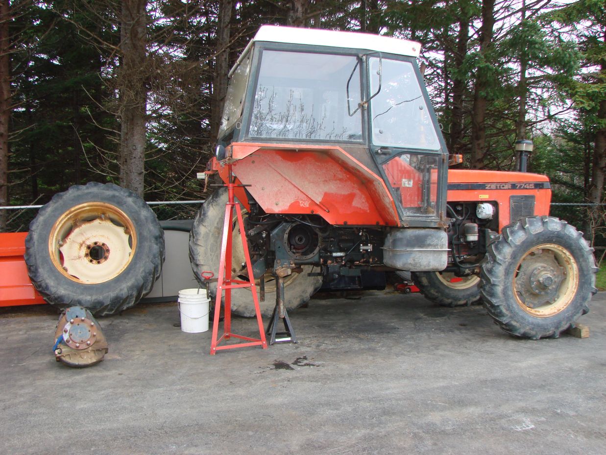

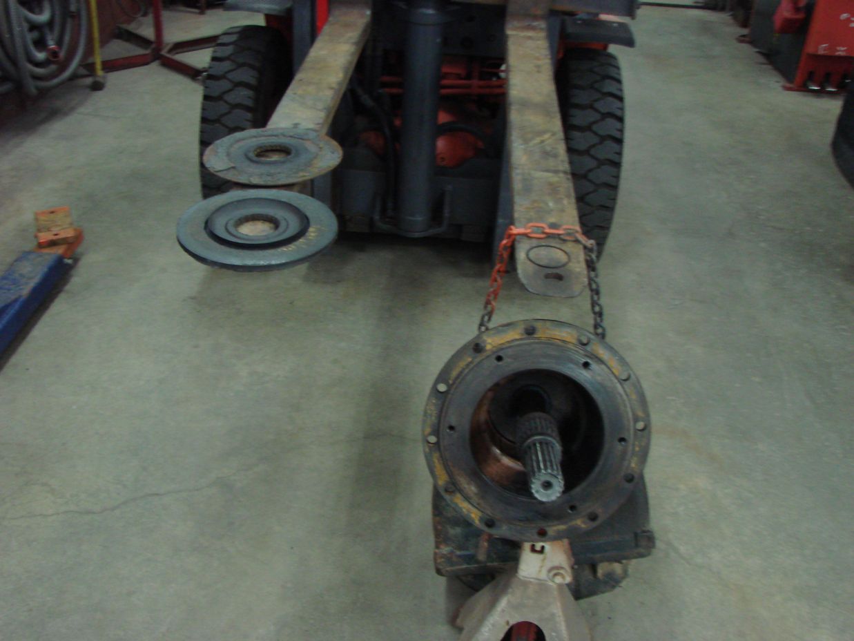

Well I removed the right side off the Zetor yesterday. The right side is a little more complicated because after removing the axel I discovered this is the side that has the deferential lock system and there's a gear in there that drops down a bit so if I don't figure out how to line up the gear with the axel spline I'm going to have a tough time reassembling it but I haven't really looked at it yet. I'll post photos later on today.

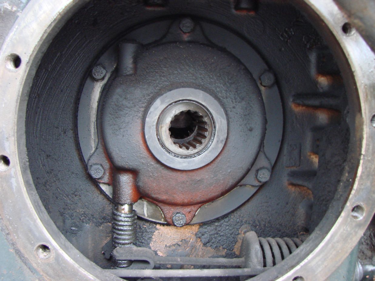

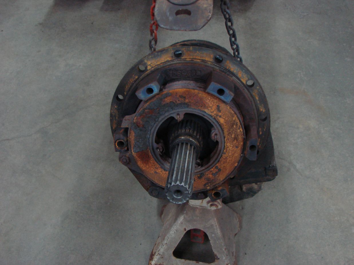

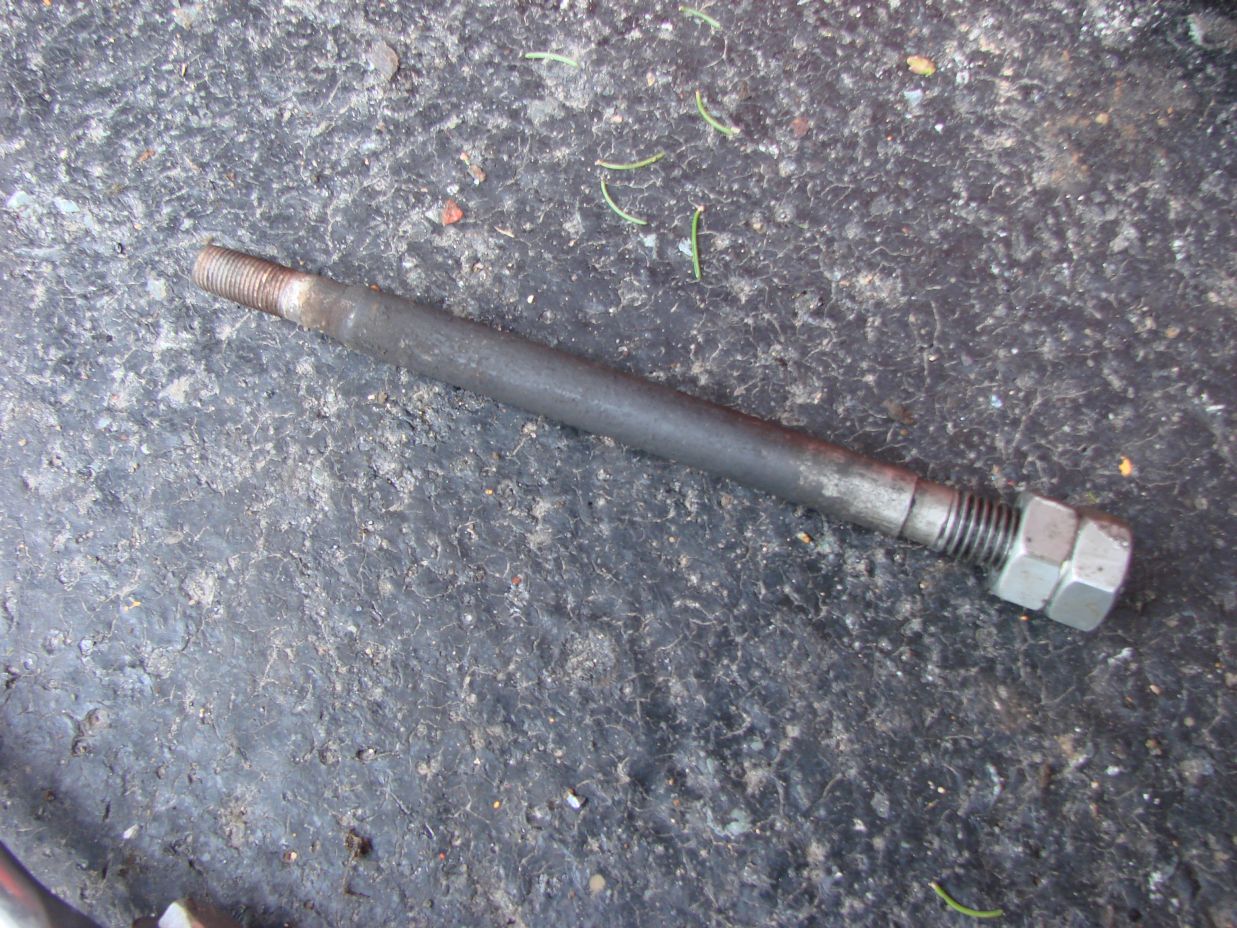

Here are some more photo's of the right side. You'll notice the long threaded bolt. It has to be removed from the inner brake system before the assembly can be pulled out.
Also notice the gear has dropped down some. It's for the rear deferential lock. I'll have to figure out how to put this back in place before I can install the Axel assembly.

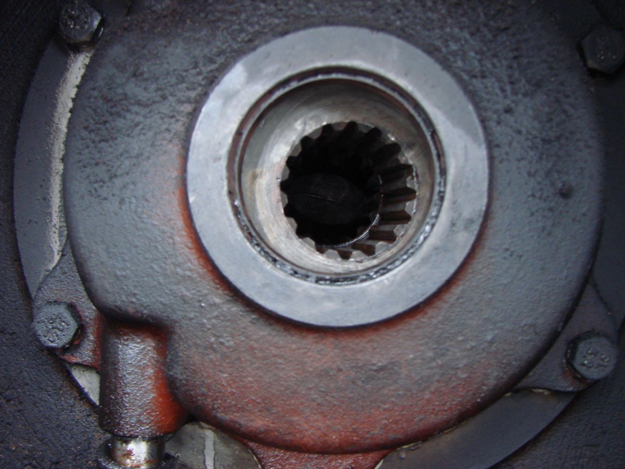

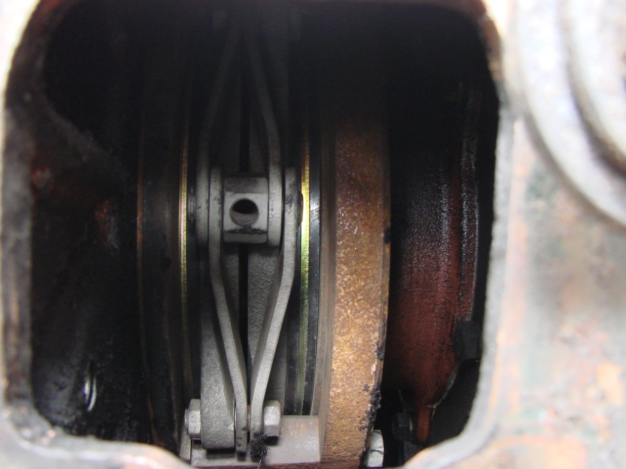

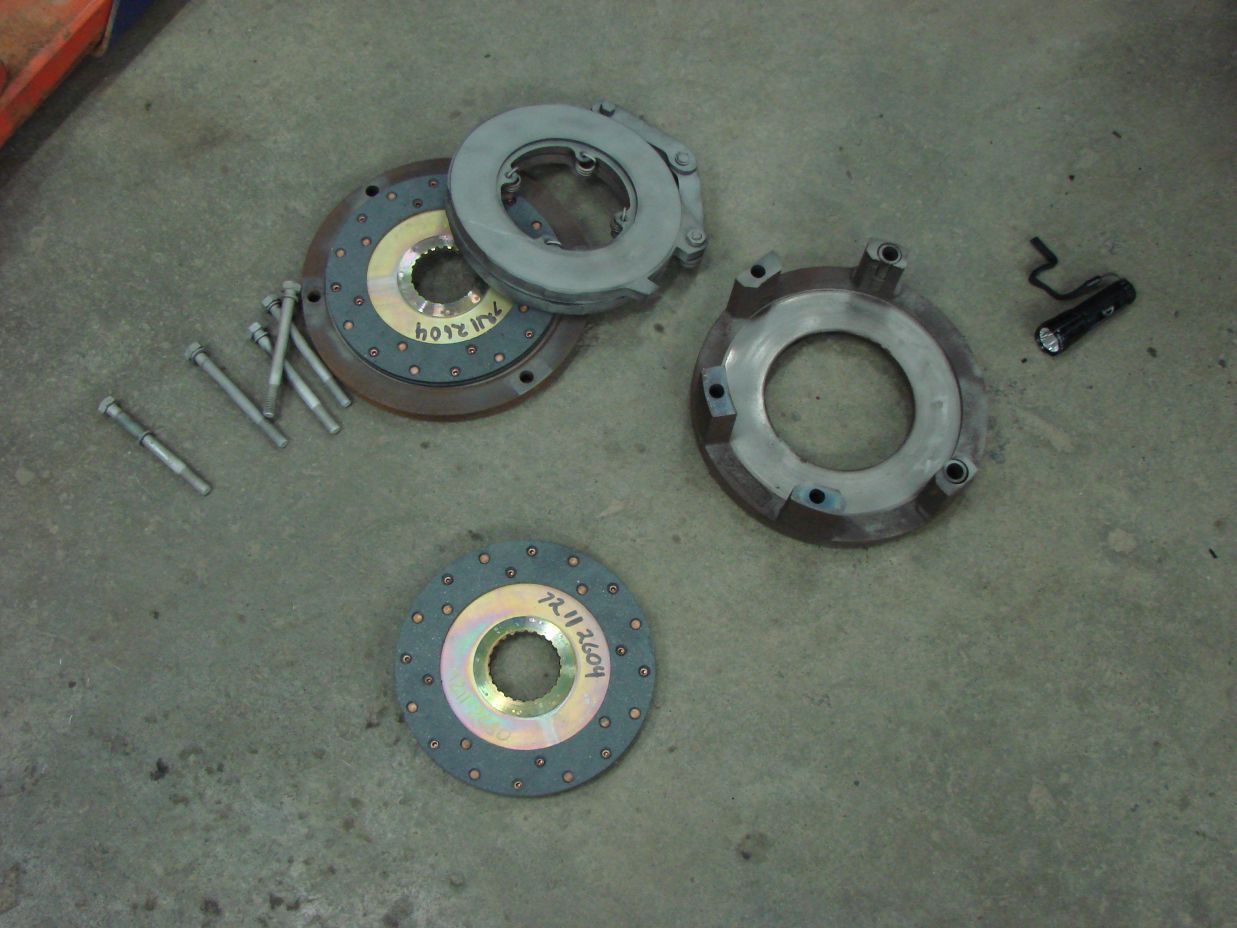

Thanks Optimista for the info but this one is a different beast. This one has disc brakes. I figured I'd post some photo's of them to show just how bad they were. Don't work to hard and I'll look forward to hearing about the Cobra. ;)

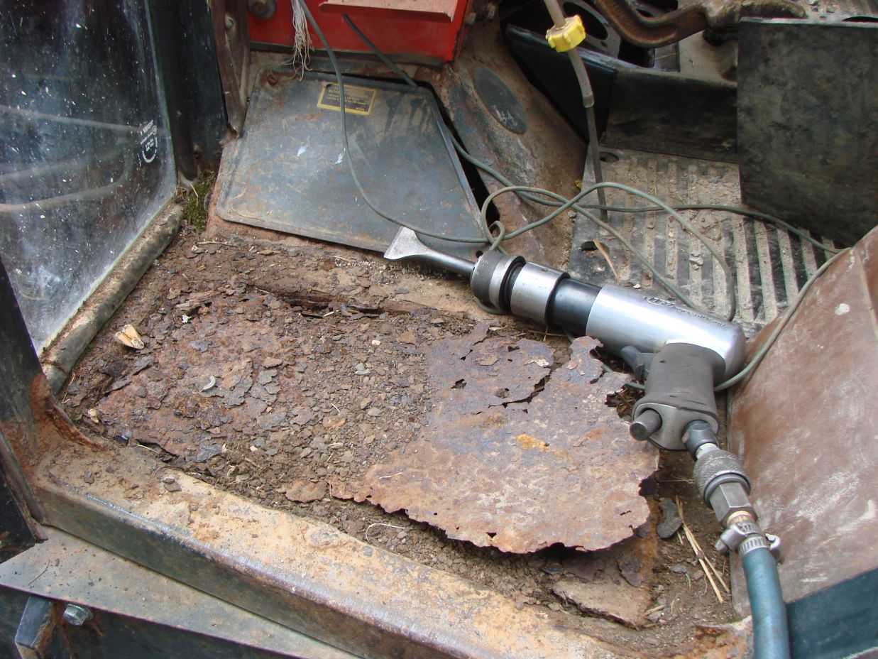

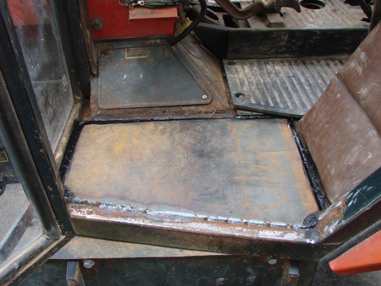

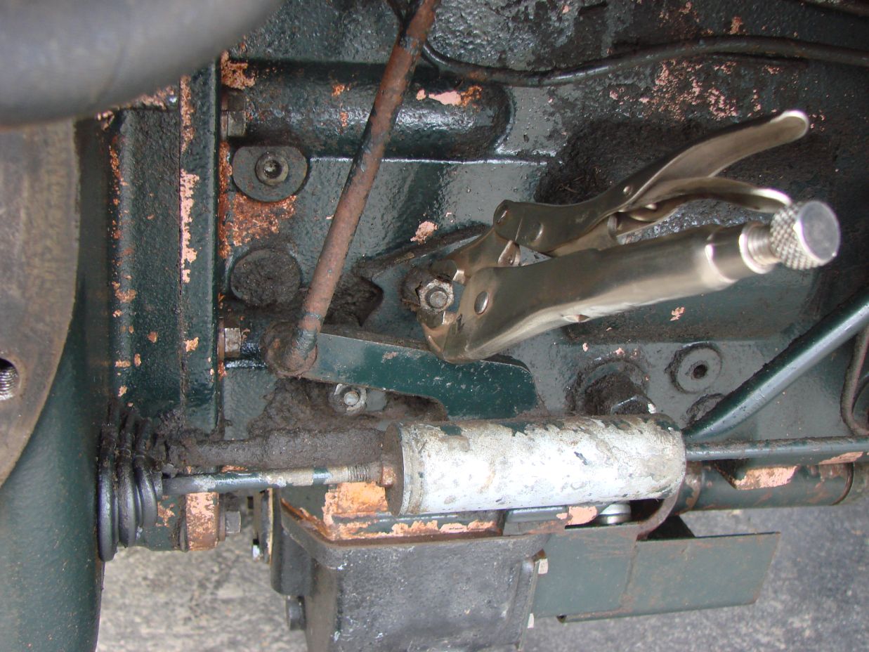

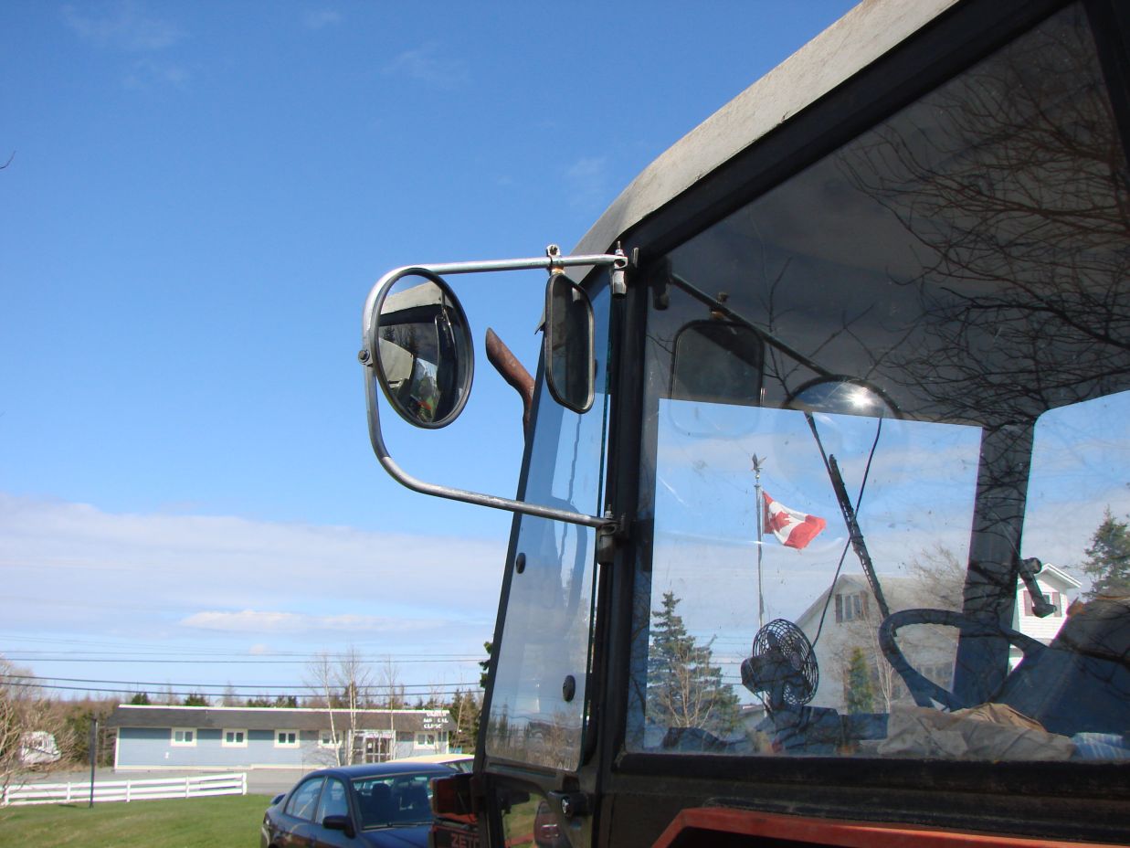

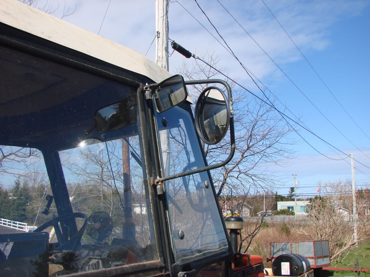

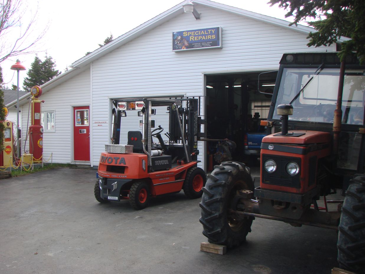

For those who have followed this thread I'm happy to report that I got the Zetor completed today. I did the brakes on the right side and discovered this is the side the deferential lock is at and the gear dropped down out of alignment with the main spline but I discovered a way around this. In order to get that gear to stay in place during reassembly just line the gear up and have someone in the cab press down on the Def lock and that will hold everything in place while you put the side Axel assembly back in place. I cheated a bit and held it in place with vice grips as pictured.

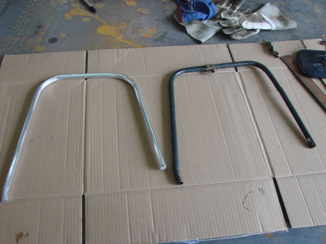

I also removed a rusted section of the floor and put in a piece of 1/8th plate. The old tractor didn't have much in the way of mirrors so although I wasn't asked to install any i went ahead and did it anyway but found out that one of the mirror brackets was rusted out so I fabricated one out of 5/8th solid aluminum round stock. i managed to get the bends right too. :thumbsup:

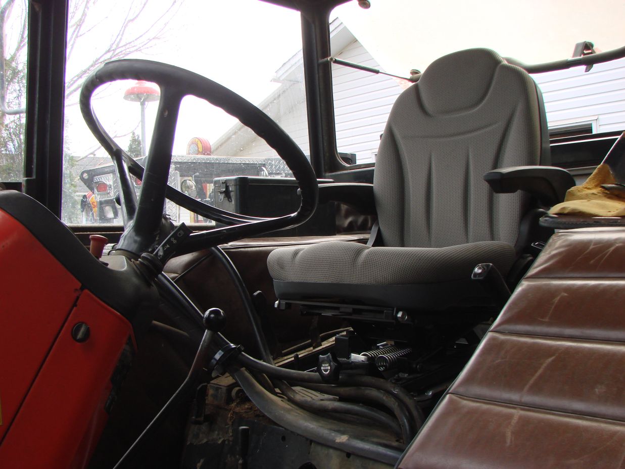

Last winter I removed the seat out of my new Kubota 5740 and the folks who owns the farm tractor purchased the old seat from me so I installed it in the tractor for them.
The operator should be happy now with great brakes, a new seat and a few mirrors he can see with now.
