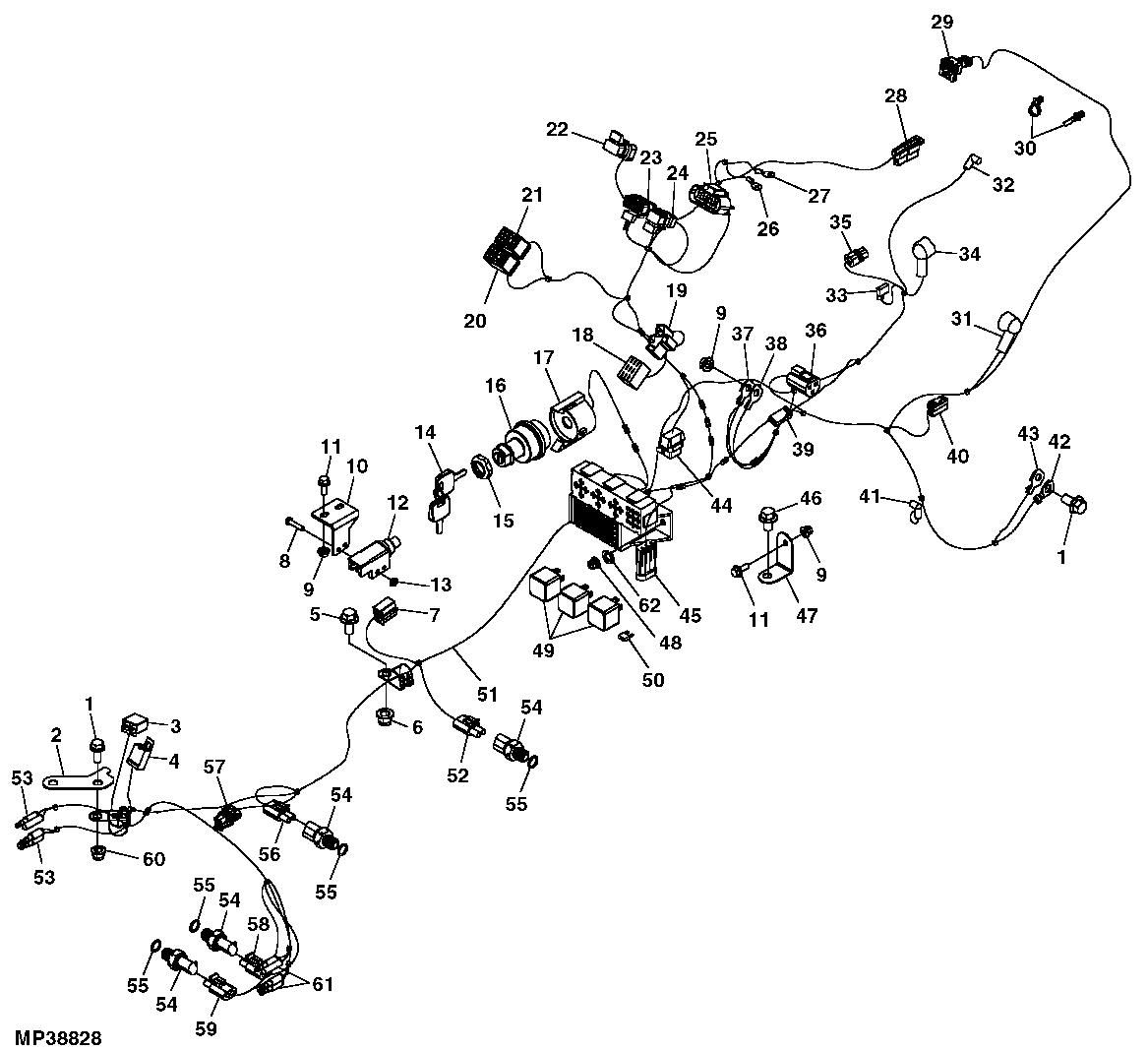

Was under my 3320 yesterday while changing the hydraulic fluid and filter (400 hours). Noticed a push button switch hanging on a broken plastic mount. Looks like it is designed to be depressed until I step on the brakes (like a brake light button?). Not sure what this switch does.....but the only thing on my tractor currently not working is the automotive cruise control.
I forgot to take my owner manual along to look up the part. Any advice what this switch is? Illustration for part number ? (I know that is asking allot). :D

I don't have an open station 3320 service manual handy but I think it's the switch to kill the cruise if you hit the brake, just like the cars do.
Tom

Is it #12 on bracket #10?
Part LVA13307 brake switch (#12)
Part LVU17692 bracket (#10)

I agree with tomd999, that it kills the cruise when you hit the brakes.
/ Brake Pedal Switch
Thanks guys. That has to be why my cruise has not worked for a time. The timber and brush takes it's toll on the plastics, and unprotected parts.
