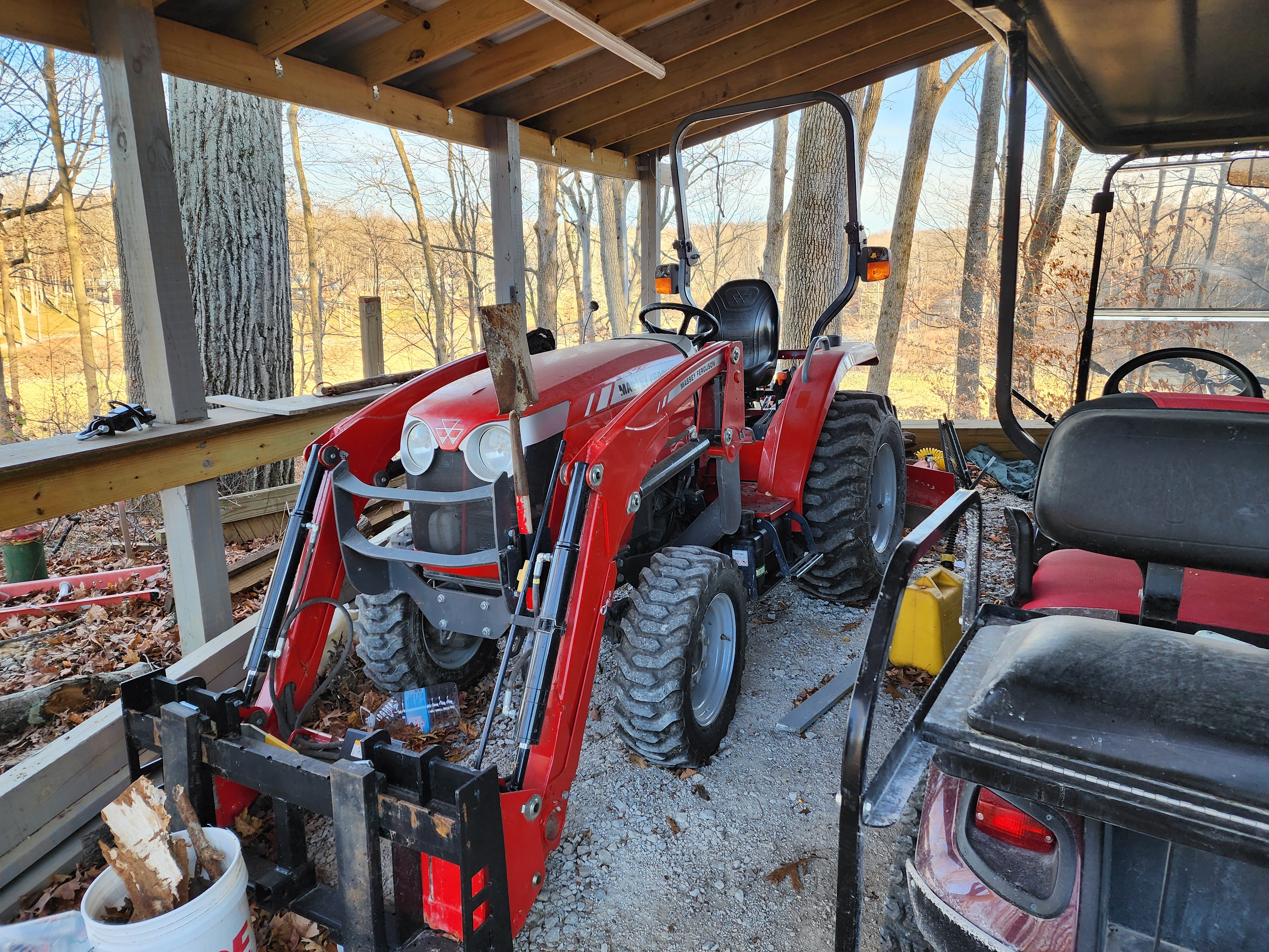

My question is. - If I'm going down a step hill carrying a load in my front loader bucket.
' If my back tires come off of the ground, will I still have brakes on the front wheels?
I have some fire wood at the bottom of a steep hill I'd like to get.
Thanks
This is the Massey Ferguson 1739E.
It's old school.
It does not have the Hydro clutching mechanisms.

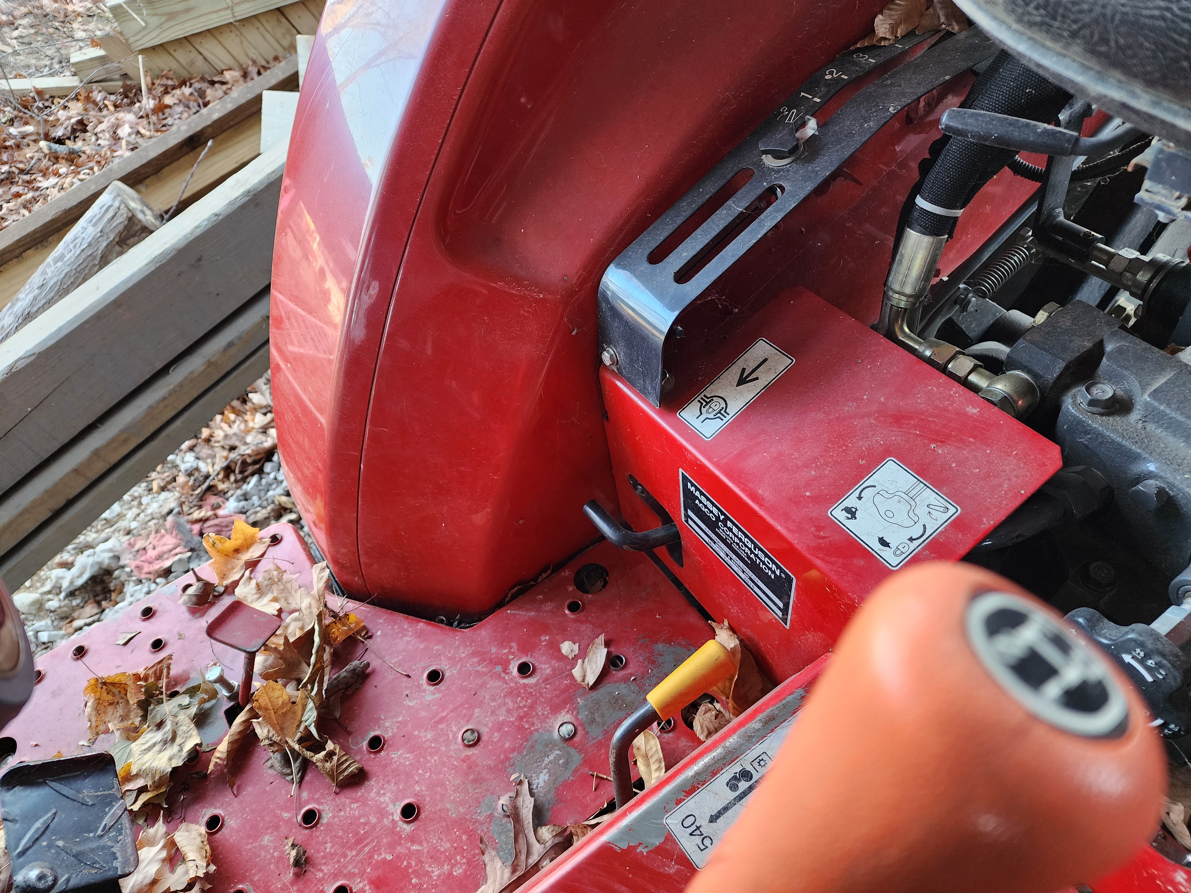

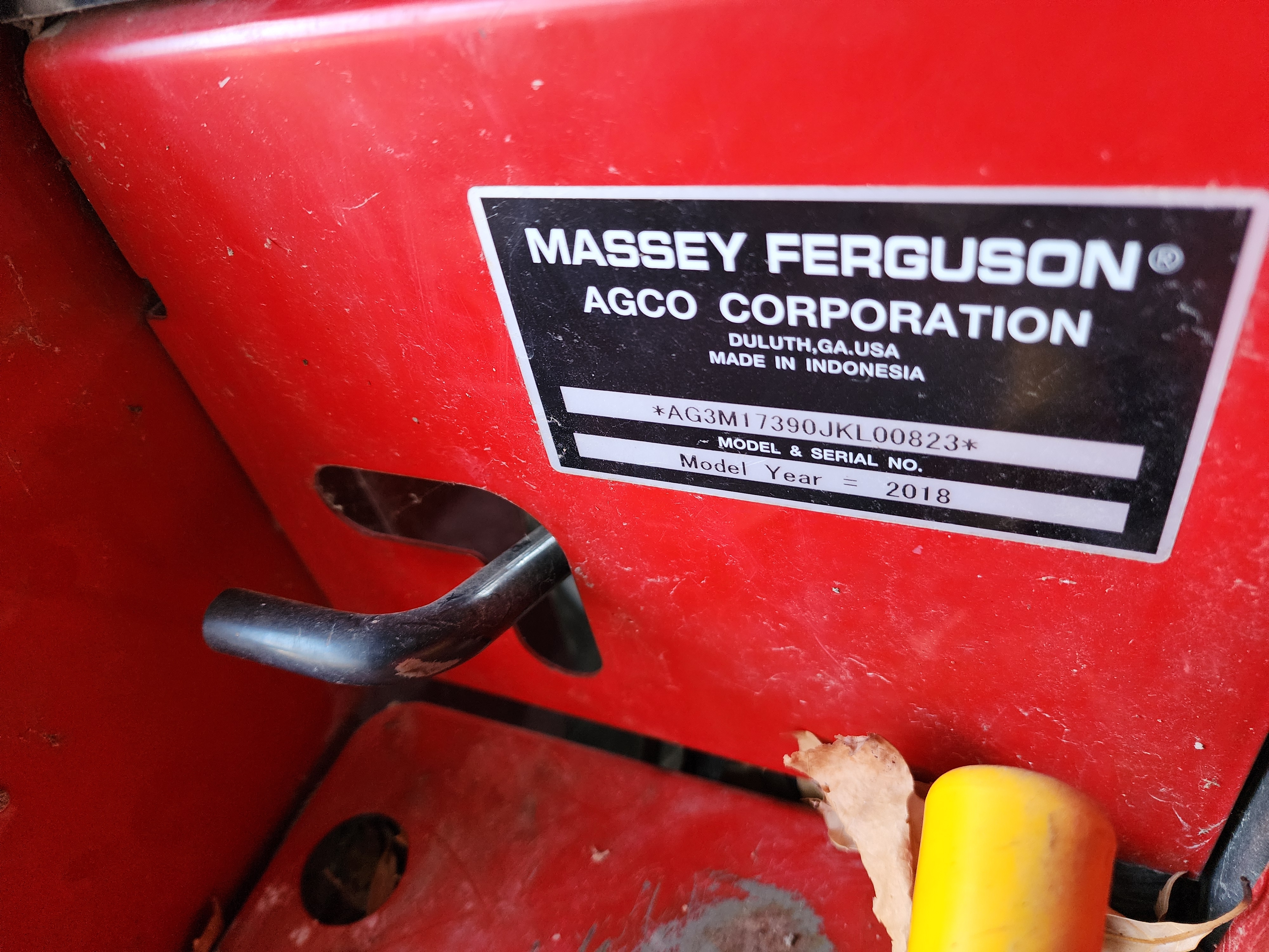

My 4 wheel drive is a little lever that sticks out near the floor board. You have to keep your right foot on it. It's more difficult to engage and you can not press brakes because you have to keep it pressed to keep it engaged.
If I'm wrong somebody correct me.

That's the rear diff lock pedal. It locks both left and right wheel together.
That's not the 4WD lever. Please check your manual to see where the 4WD lever if before you attempt doing any work on hills.
It will most likely be on the left hand side of the tractor. It has two positions. Engaged and disengaged. It will stay in position too.

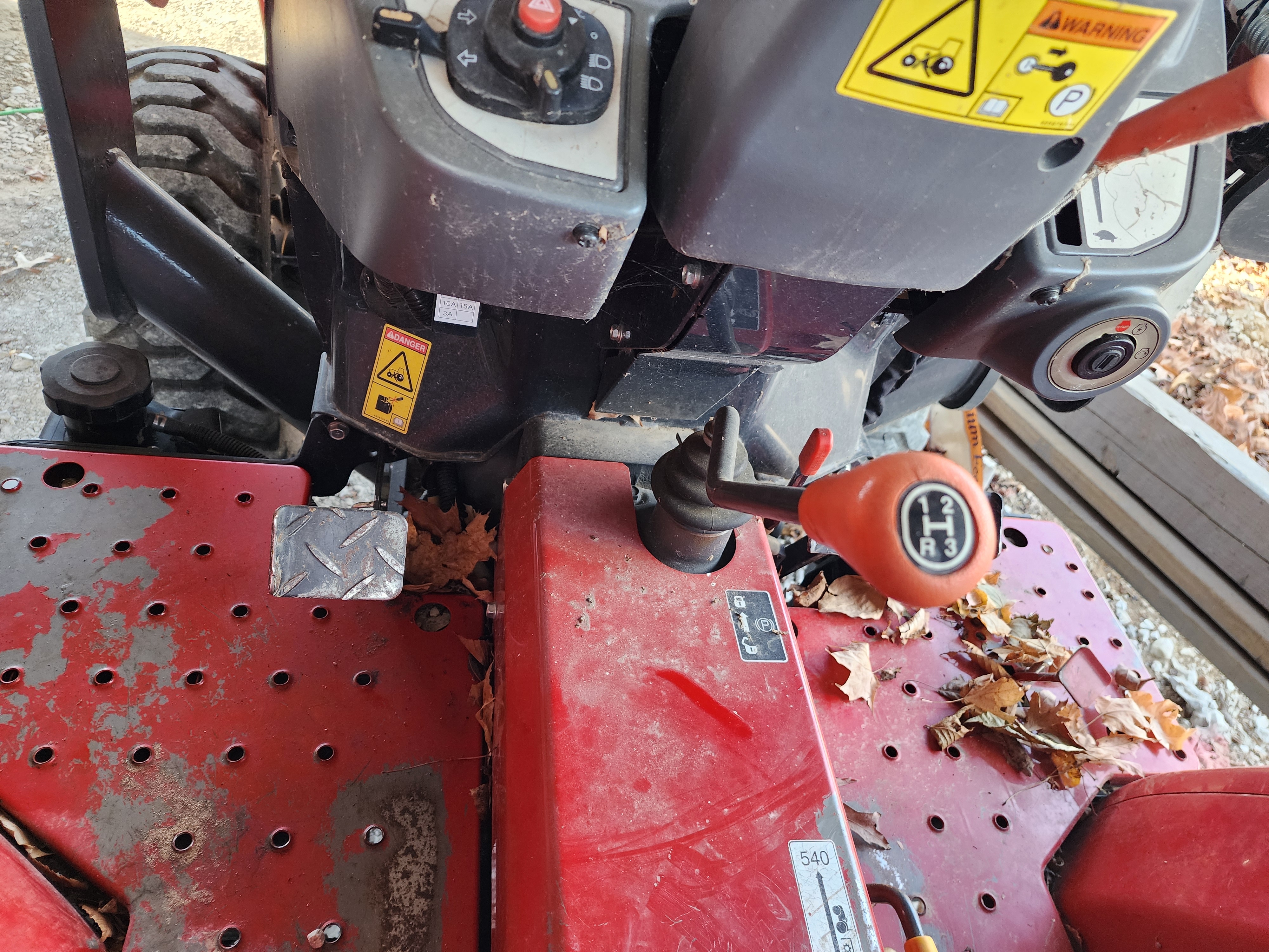

I'll go look for my manual. Here another pic

   / Brakes on Massey 1739E, old school clutch and brake. #10
It's the orange t handle. Pull up to engage, push down to disengage.
