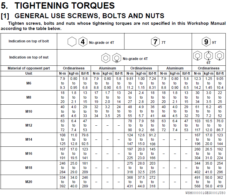

It should be a chart at the front of the manual that has the bolt sizes and coressponding torque value.

I did find the torque specs for bolt size, but I cannot find the bolt size for the mid pto assembly.
   / Brand New B2650 UDT fluid leaking #54
May just have to go off the actual bolt if the size isn't listed.

I'm not sure what the bolt size is.
These are the torque specs I am seeing for the transmission part of the manual.
#56
If I use my rethreader to measure the bolt, it fits into the M10 nut so according to the shop manual, it would need torqued to about 39 to 44 foot pounds. I just don't want to strip it out considering how I stripped out the oil drain plug already. As you can tell I am gun shy now.

Do you see a chart that just shows pictures of bolts and list the torque based on size, typically if it's not listed by location they are torqued based on the standard size chart.
   / Brand New B2650 UDT fluid leaking #58
Just to be clear you're talking about the threaded portion being 10mm, not the bolt head? Does it look equivalent to a 3/8" dia.?

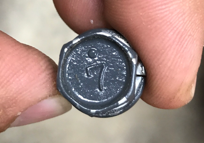

Here is part of page 1. Hard to understand for me though. The bolt has a 7 on it, but I see aluminum and the casing of the mid pto is aluminum, so would it be 32 foot pounds then?
   / Brand New B2650 UDT fluid leaking #60
Yup that should be 29-32 ftlbs, I would use N-m if your torque wrench has it or check the lbft conversion, had more then one improperly converted spec before.
Although that spec sounds right for that size bolt.
The material it's threaded into is what you base the chart on so it's still aluminum.
