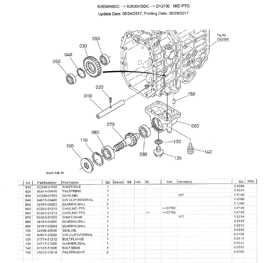

I must have snugged it too tight. The threads from the transmission side pulled out. I was tightening it and wasn't even going that tight I didn't think and it got loose. I took it back out and the threads were on the bolt.
I don't understand how you can hand tighten it, then with a snug of a wrench, the threads pull out? What do you mean "threads pulled out"? Did you cross thread it?

Very frustrated. I bought new so I didn't have to work on it. It's just been a bad experience since day one. I ended up getting an oversize oil filter bolt with a piggy back and put that in. I don't like doing that, but it seems to be holding for now, but I want to give it a few days to know for sure. I did work on the original problem and replaced the oil filter and the replaced the oil filter thread pipe just to be safe, which that part went without any issue's, so hopefully that problem is solved, but we'll see.
In order to fix the stripped out threads on the oil drain, I'll have to replace part 060 in the attached picture. I am going to see if the oversized oil bolt holds without leaking. If it does, I'll see about getting that part replaced and fix it right.
I think that's an excellent idea. Have them fix it for you. Things happen. It's brand new so let dealer sort it out. Sounds like you are getting frustrated which is very understandable.

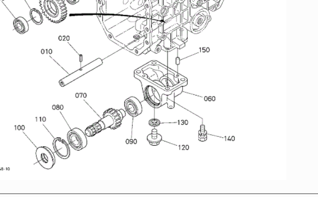

You should be able to rethread to the next size up and use a bigger plug. Also have you tried running a tap in the original threads to clean them up?

The bolt pulled out along with the threads, so re tapping the original size won't work. I did order the replacement part from Messicks this morning. The original issue is fixed, no more leaking from the oil filter, but the piggy back plug has a extremely small leak. I got the housing, seal and a new oil plug bolt and seal just to be safe. I make one stupid mistake and all this happens. It's very frustrating.

I got the new part in. The old part is out and everything is switched over. I am letting the make a gasket dry, but everything is hand tight. Messick 's was nice enough to email me the breakdown but I am having some issue's understanding the torque for the 4 bolts that hold the housing in. See attached. They are very tight when I took the 4 bolts out, but I don't want to make a mistake and over tighten them. What are the proper foot lbs for the 4 bolts, number 140. To me it looks like a little over 1/2 foot lb, but that can't be right.

Looking at this again, I am wondering if that is the actual weight of the item.
   / Brand New B2650 UDT fluid leaking #48
Yup that's item weight, not torque spec. Torque specs will be in service manual, should be able to look up based on bolt size.
