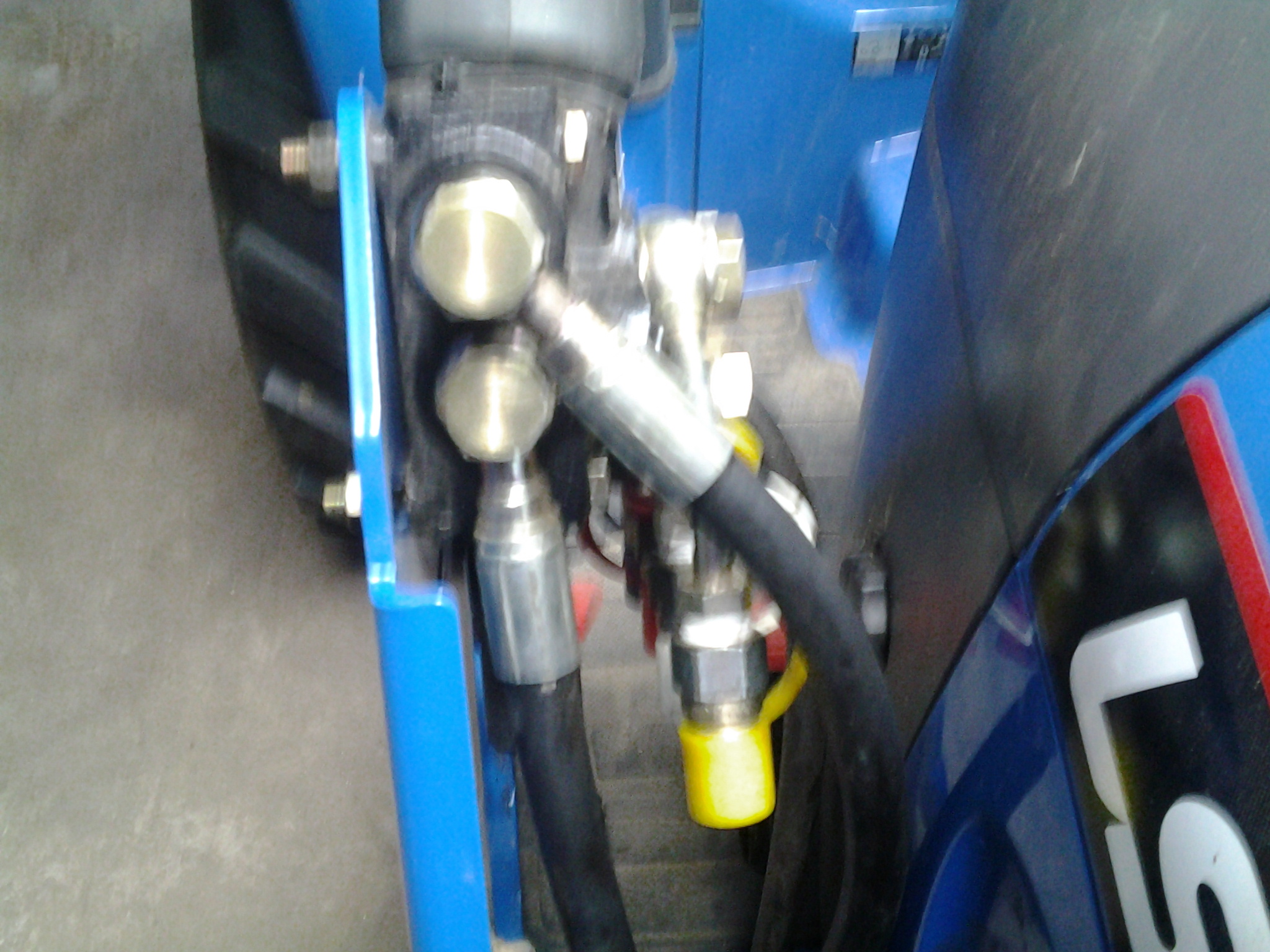

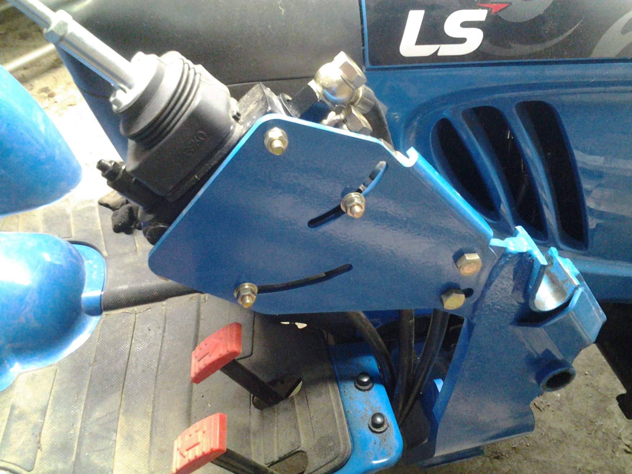

I don't think I can move mine to the inside...the quick release from the other hose will hit the fitting..
Disregard the advice I suggested about wrapping your lines & do just as BLUE ME suggested. Just move the top hose to the inside (closest to the hood) & move the loader valve to the most upright position. Bending the floor pan isn't necessary. Like he stated, also gives you more room to enter from the right. 2 for 1.

Here is a couple reference photos 20150818_191341.jpg20150818_191341.jpg20150818_191325.jpg
   / Brand new XJ2025h and already have a cut hose and hyd leaks????? #25
I just unbolted, repositioned and retightened.

where hoses ride metal edges, I usually ziptie some sort of shield to the hose. IE.. a piece of radiator/heater hose as a sheath, etc.

Here is a couple more photos under a different format. P1010964.jpgP1010961.jpg
