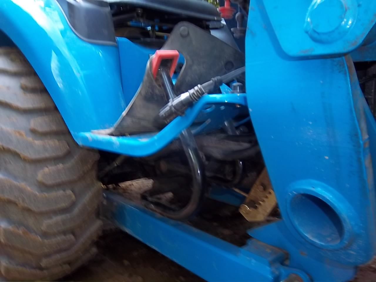

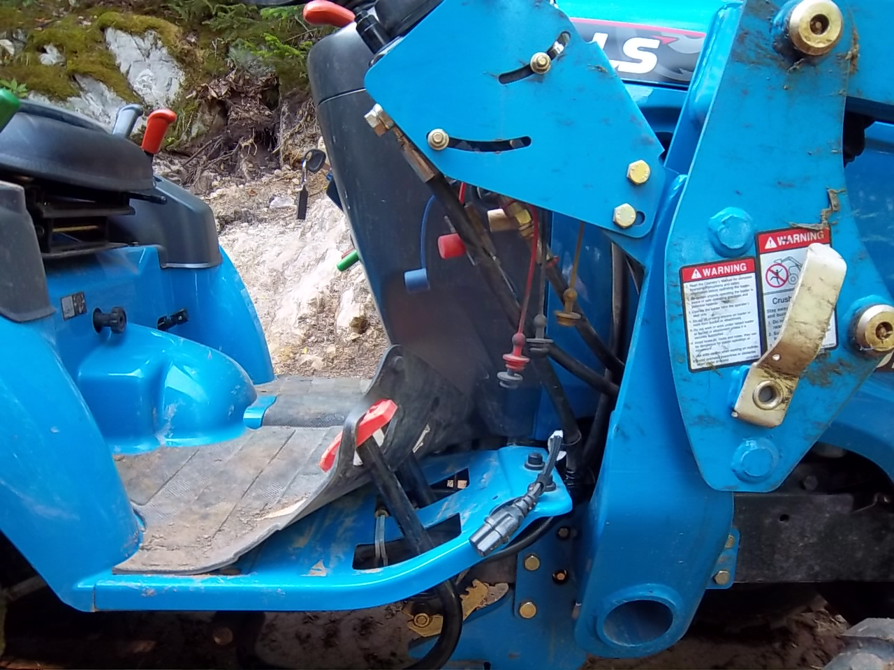

well got my new hose today>>> 3" longer and a MUCH nicer and heavier hose...got all re-routed,,,all is well....can you guys post pic of how your 3 hoses are routed under the floor pan ??

Any pics of how the 3 hoses are routed under the floorpan

well got my new hose and this one is a much nicer heavier hose ....3" longer.....rerouted so I can swivel the handle on the bracket...anyone have a pic of how they are fastened under the floor pan ??

ok here are pics...just follow the top hose im point to where it wraps under the floor pan...also if you guys don't see an issue pls post pic of how they have the top hose attached to the control box,,,which way its turned....thx
Thanks for the heads up! I'll check ours this afternoon and let you know what I find.
