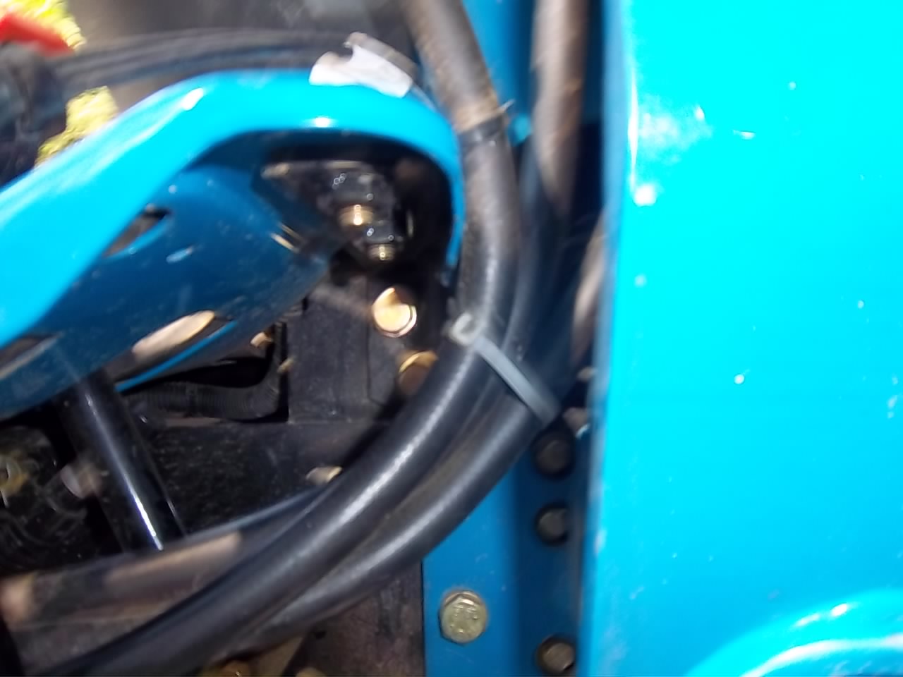

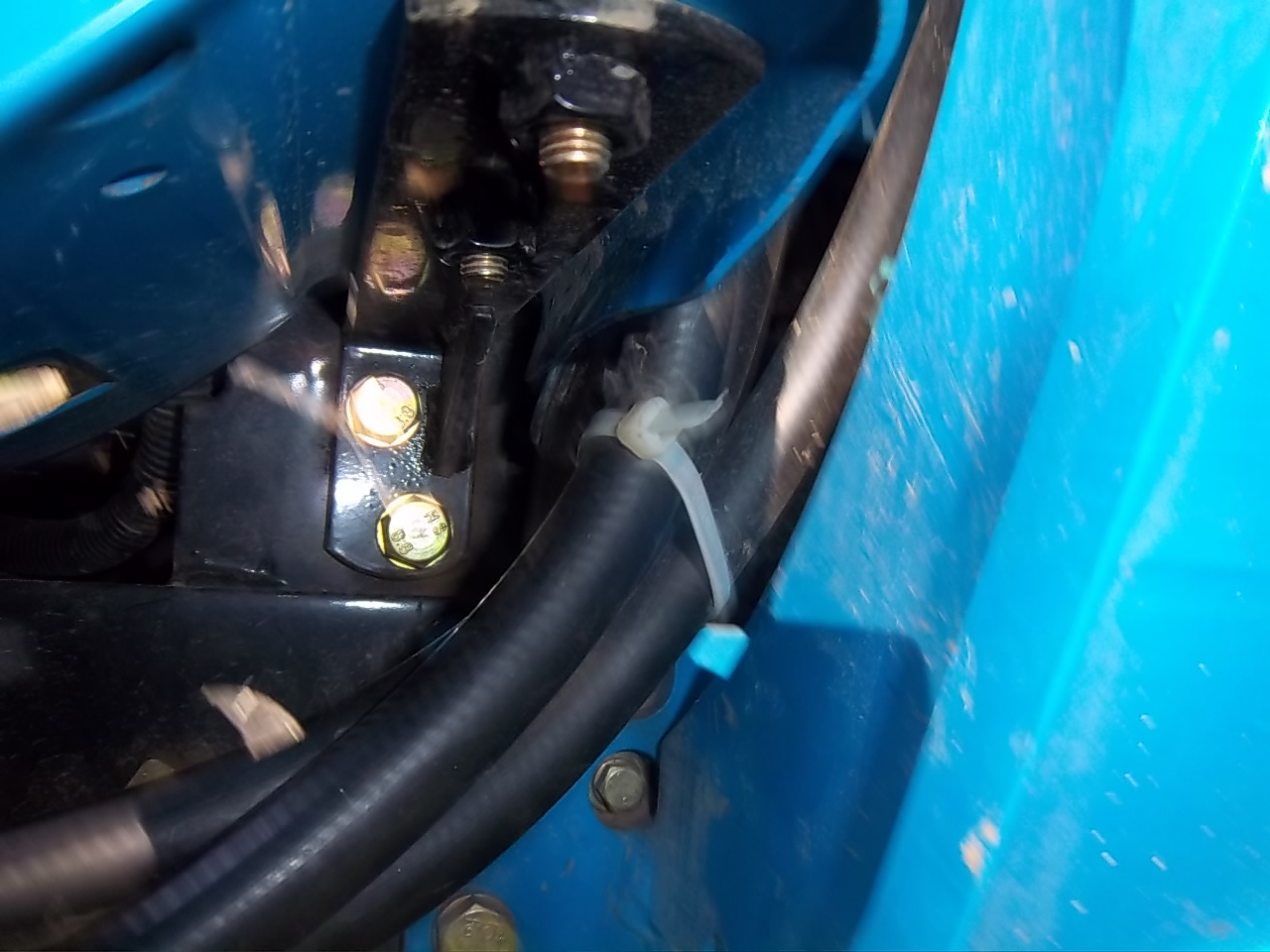

Definitely an issue on the J2023 as well. Just checked mine & it is down to the metal. I contacted my dealer & informed him for future reference. A couple of repair ideas would be lengthen the hose & then feed all 3 through a larger braided hose. Have to give thanks to you cvcman. Don't feel too bad for your misfortune because for some guys this may not be covered under the warranty. This hose may be considered a loader part & only carries a 1 year warranty. This is TBN at its finest. Thanks again cvcman.
   / Brand new XJ2025h and already have a cut hose and hyd leaks????? #12
When I first got my tractor I repositioned my fel control and moved my hoses to do so.
I put a tie around hoses and bent floor pan to give me more clearance.

when I get the new hose im going to chg it and zip tie the three together that go to the rear and make sure they are not going to get caught on anything or hit the tire...

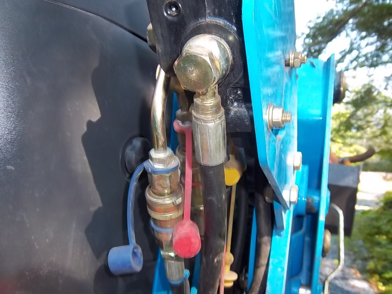

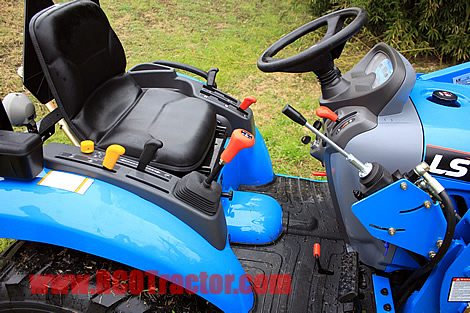

this is how the others look...mine the hose runs behind the controlls2025.jpg

once I get my new one on im putting that flexable plastic wire loom over the hose where it touches the frame...The larger New Hollands don't have all these hoses this long...much nicer neater system.......

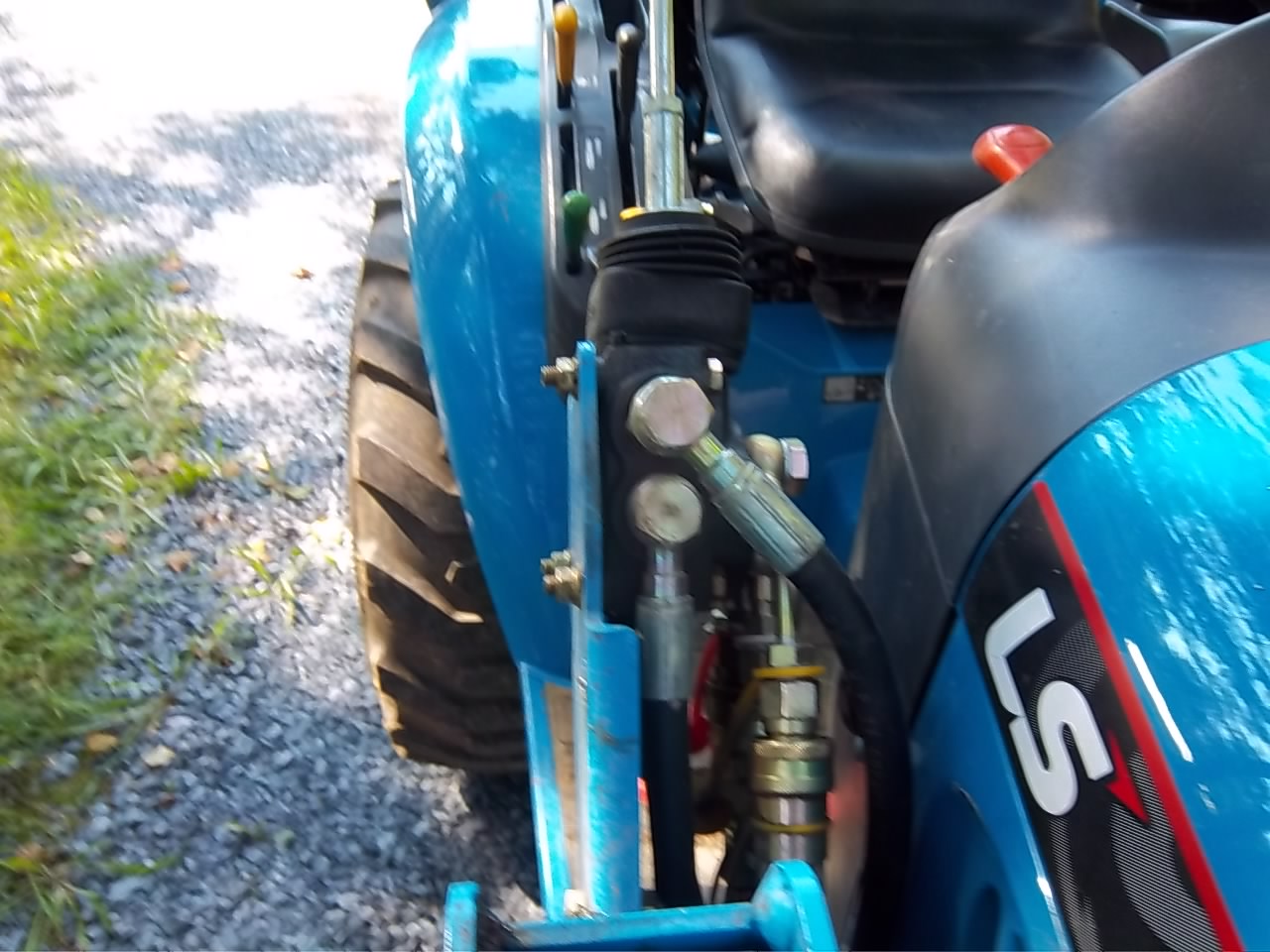

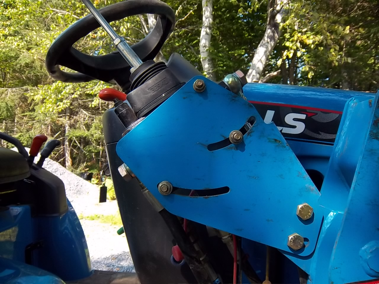

Disregard the advice I suggested about wrapping your lines & do just as BLUE ME suggested. Just move the top hose to the inside (closest to the hood) & move the loader valve to the most upright position. Bending the floor pan isn't necessary. Like he stated, also gives you more room to enter from the right. 2 for 1.
