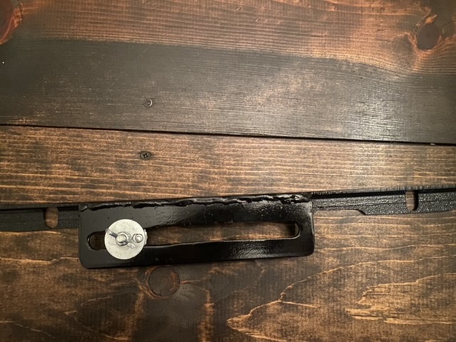

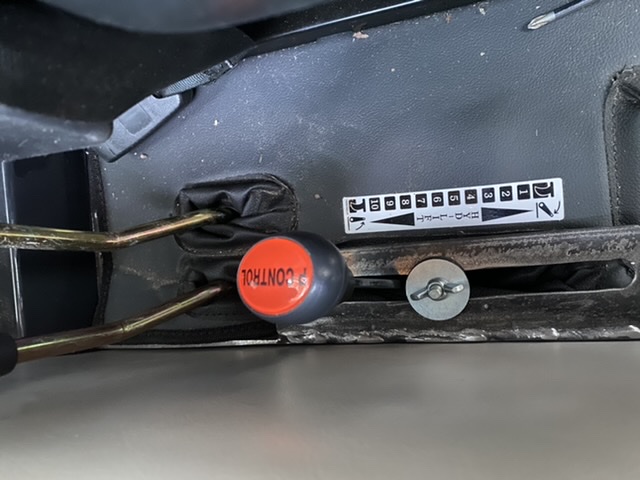

The three-point hitch control lever on the right side of the driver's seat, that controls the lift arms, doesn't have a knob or widget to set as a stop. The word "Hydraulic" is spelled out vertically for use as a marker (other tractors use numbers, dashes, or letters) so you can eyeball where to set your three-point back down at a preferred height after raising it up for travel, but it's foolish not to have a sliding stop for this purpose. Elsewhere on TBN, I found this can be added: Hydraulic Lever Position Holder (part number FEB4100000A). I plan to order that widget soon, as I prefer to mow with the rotary cutter several inches above the ground. Dealers should include it by default, or at least tell customers this is an available accessory.

If the 3pt position lever or the throttle lever action is too stiff for your liking, they are both adjustable. They have spring preloaded friction dampers, double nutted so they don't back out. I like controls that work smoothly so I reduced the friction on mine by quite a bit.
The throttle one is inside the dash. You have to take it apart to get to it but it's not that hard. On my non cab 3725 the 3pt one can be reached from behind.

The three-point hitch control lever on the right side of the driver's seat, that controls the lift arms, doesn't have a knob or widget to set as a stop. The word "Hydraulic" is spelled out vertically for use as a marker (other tractors use numbers, dashes, or letters) so you can eyeball where to set your three-point back down at a preferred height after raising it up for travel, but it's foolish not to have a sliding stop for this purpose. Elsewhere on TBN, I found this can be added: Hydraulic Lever Position Holder (part number FEB4100000A). I plan to order that widget soon, as I prefer to mow with the rotary cutter several inches above the ground. Dealers should include it by default, or at least tell customers this is an available accessory."
I don't think this stop will work on the cab tractors because of the lever boot. I will be fabricating one that will work for mine.
Finished the stop. I just duplicated the bracket that supports the fender trim then cut down some angle iron to create a slot for the stop. Works good.
