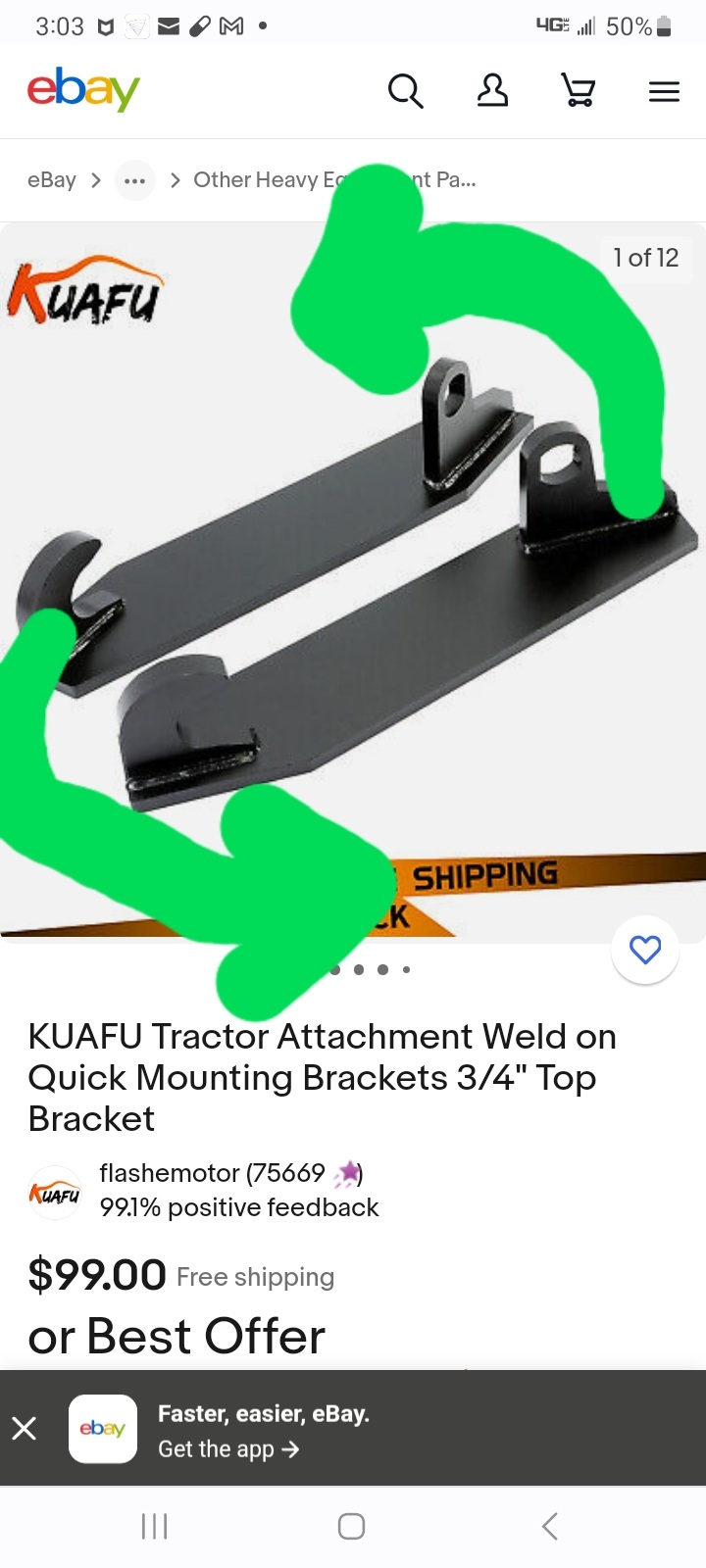

I couldn't get anyone to give me the diameters of the upper hook or the lower eyelet of the two independent Euro brackets. Now, I believe those "loose" brackets as viewed on all web pages could just be reversed to right and left and it would fit on my Ansung quick attach, but the diameters are unknown and the pin would need lengthening.

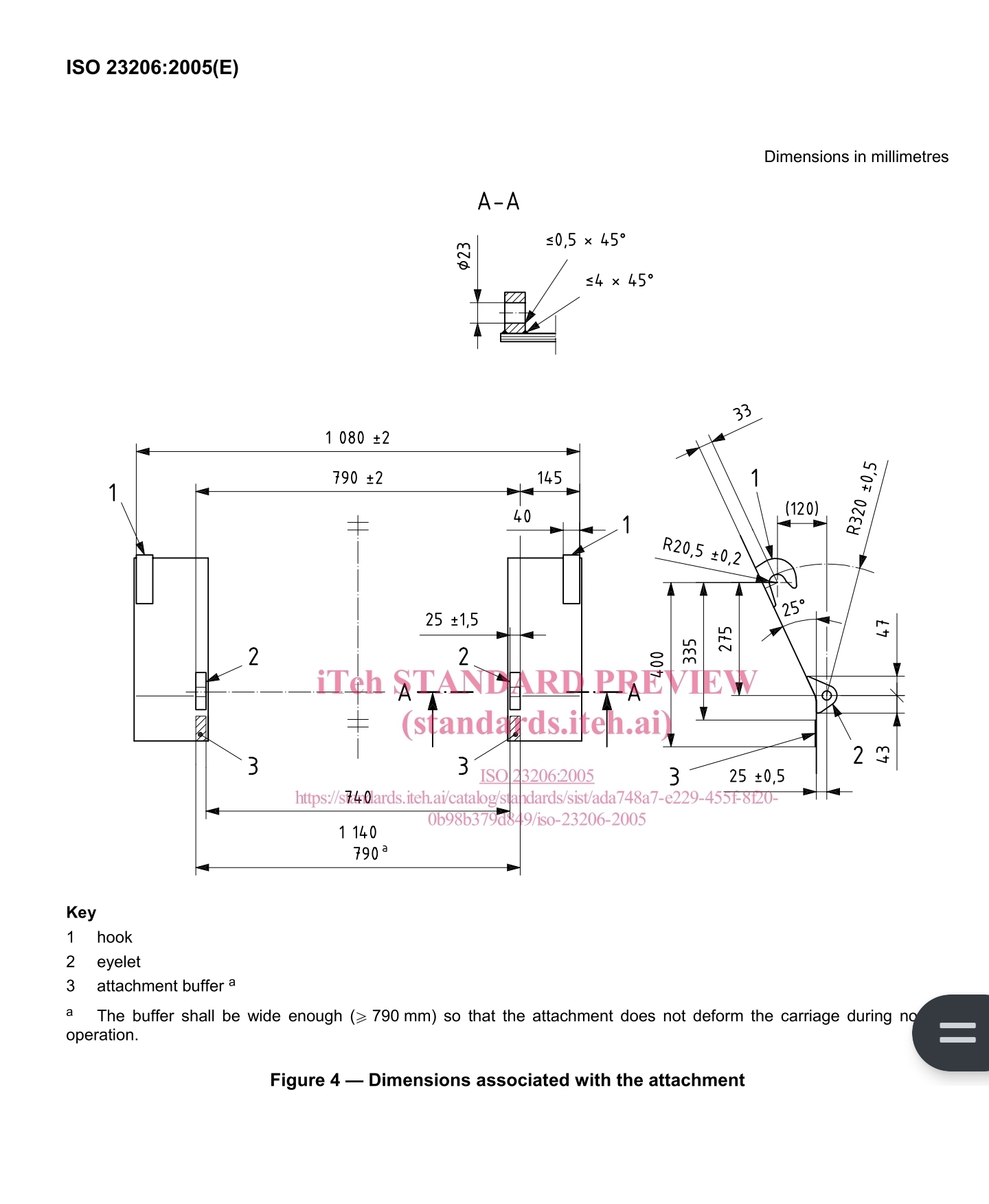

Here's more info on the Euro quick attach from when I built my loader from scratch. I forgot I had this stuff. Hope it helps. Hook "hole" diameter is 41 mm and in the lower eyelet is 23 mm.
That should work. 41mm = 1.6" & 23mm = .9". I would need to enlarge the eyelet, maybe, which is typically under compression.

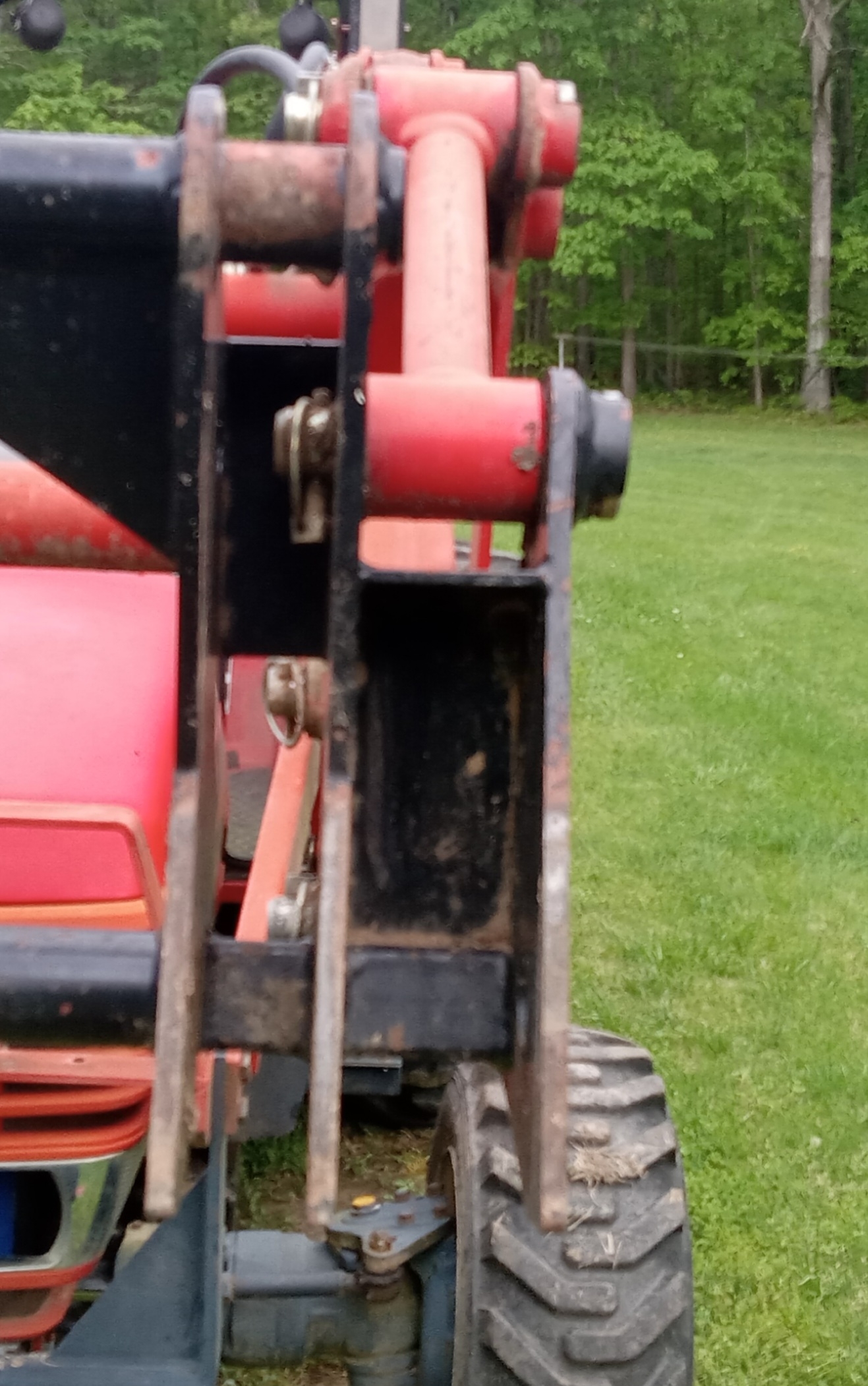

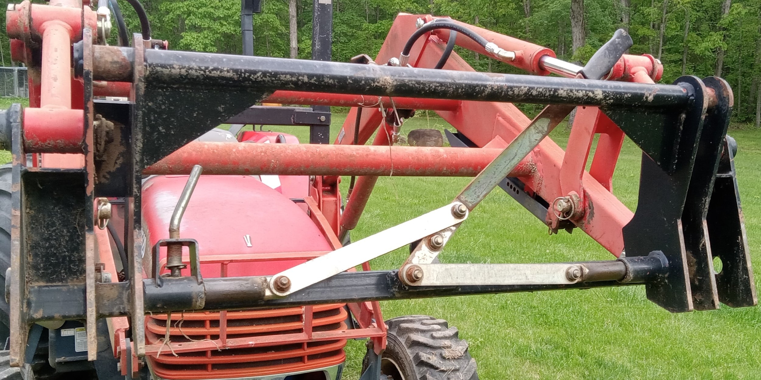

#15
Well, I got it welded up today. The pins on the adapters are tapered and bind on the blank. There is about 3/8 space at the bottom and I'm not sure I like that. I removed the bolts and reversed the handles towards the inside and my hook now acts as the stop for the lever in both directions. I'm very happy with the quality of the adapter.

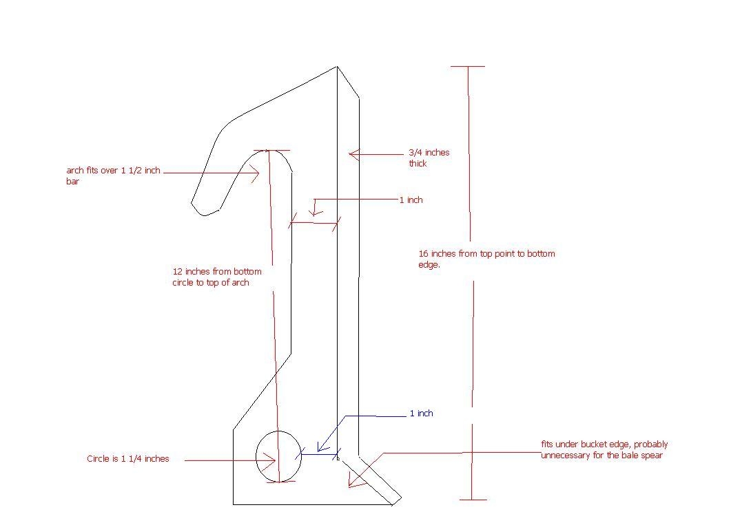

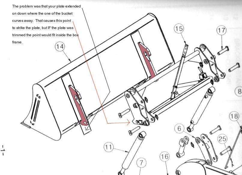

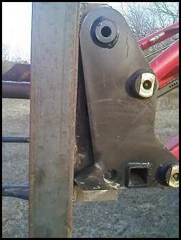

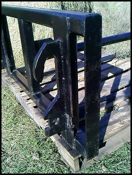

I couldnt find this thread earlier while in search. I found this yesterday on this site and will deposit it here for easier searching for our older tractors.

#17
Im wondering if I need or anyone thinks I need to fasten a horizontal support between each SSQA, and why that might be needed. They are easier to install one at a time and each SSQA weighs a good 40 pounds or more.
I'm not happy with the space between the adapter and the plate. My new forks are greater than half inch. I noticed the adapter shift when the forks are placed on the ground. I believe every shift out of normal position is an opportunity for failure. The addition of a 3/8 plate to the base will minimize the movement. IDK, this is my first experience with SSQA's; the Branson/Ansung QA seems to be a more positive and fixed system that has less chance of failure.
Do all SSQA's have this space at the base?
