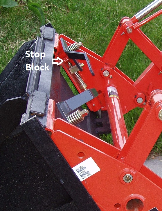

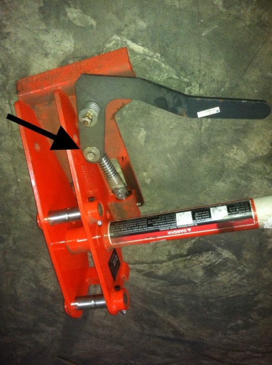

The handle didn't release so I presume the tapered pin overcame the spring pressure.
The pin needs to go over center:
And have a stop block to prevent the pin from raising when the handles are down:

I installed a stop block and now the pin is positively fixed into the blank tang. Thank you.

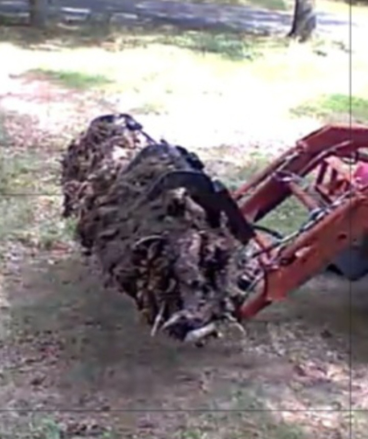

Well I finally got my grapple running. I like it and I am learning how to use it. It does seem like every other tool has its specific use, I think I will need a clamshell type as now I do see the benefits of the short tines. This grapple does grab a disorderly load of several 10 inch limbs, not pictured.

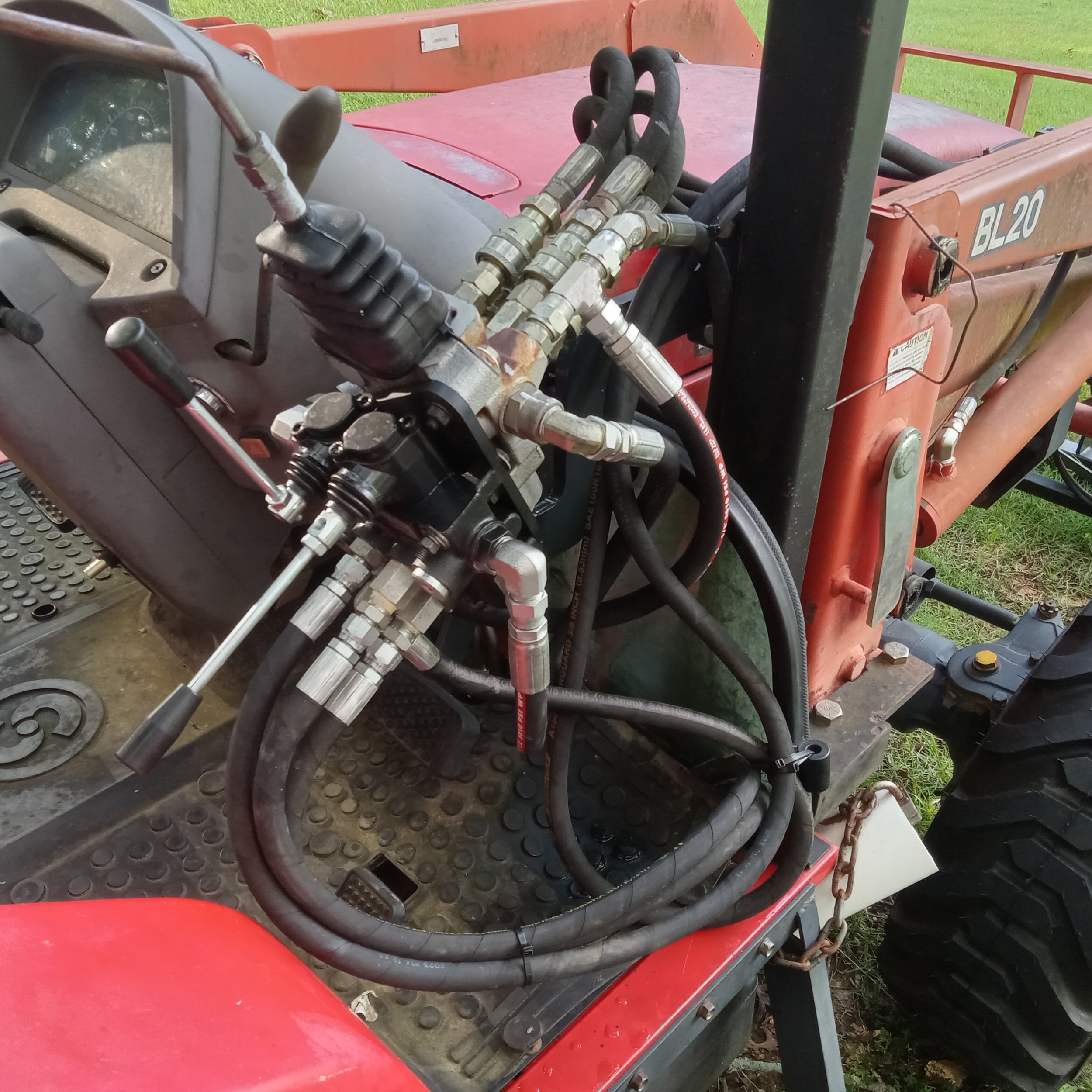

I never included photo of my 3rd/4th function in this thread. I plan on 90's where the straight connectors are.
