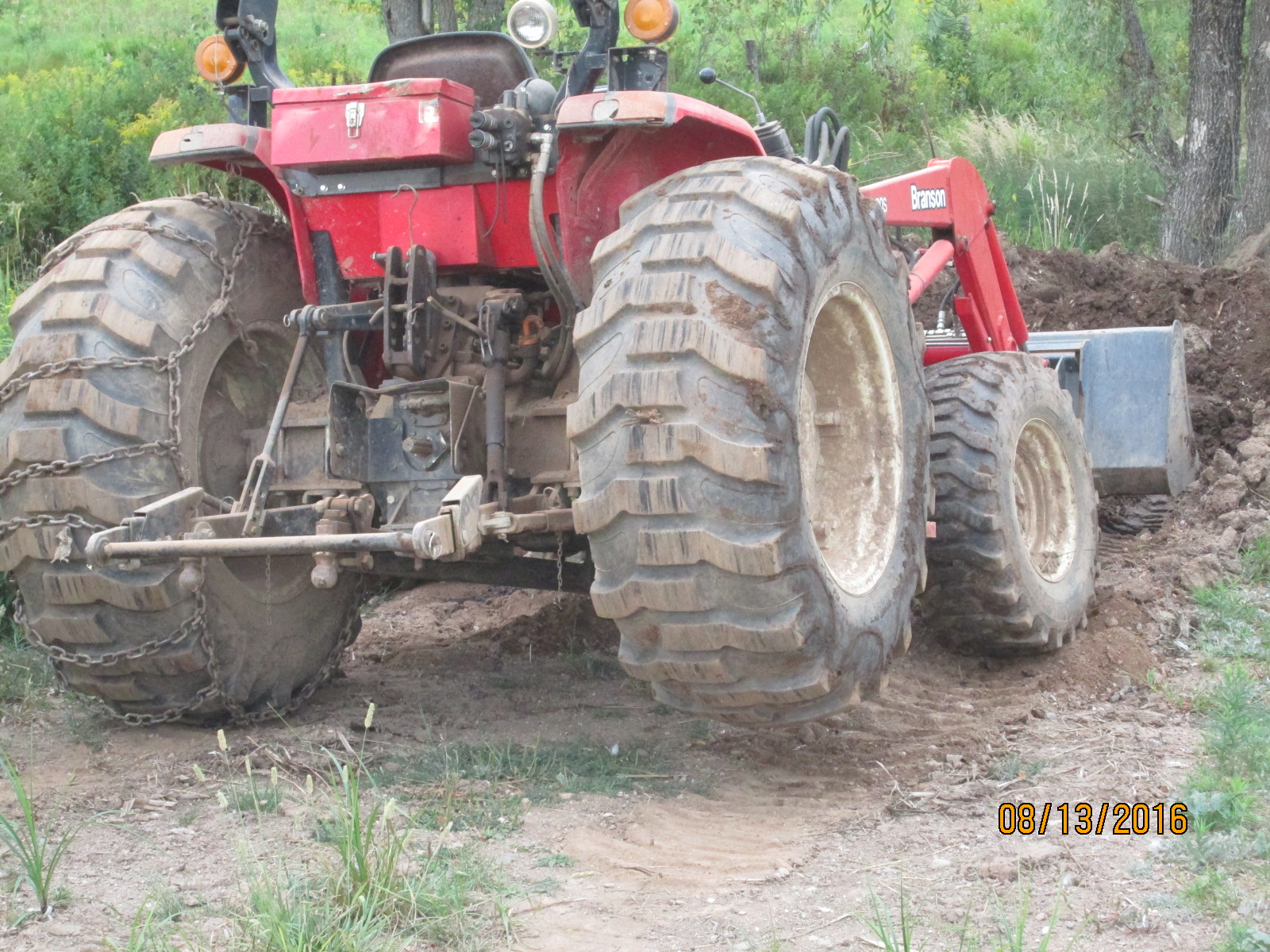

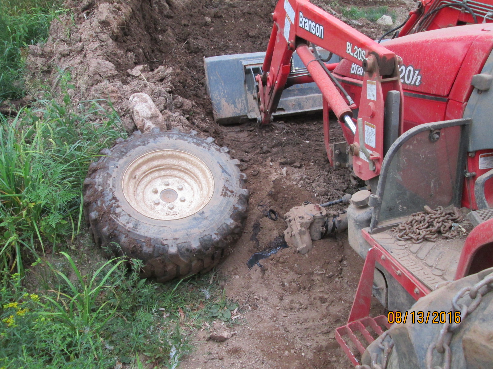

Here is mine from the spring
I was moving dirt . Drove into pile and continued to drive to get more dirt Rear tires spun some and heard a click no movement. Thought it came out of gear lifted bucket tried to reverse. Rear tires spun front didn't.
Dumped load and tried reverse . started to move and tire fell off.
$500 laterView attachment 499290View attachment 499291
With differential in the rear, unless you had your foot on the differential lock, the rear wasn't driving with the primary rear drive tire in the air....the "accessory" front drive unit was asked to do all the work under impact. Not surprised.
