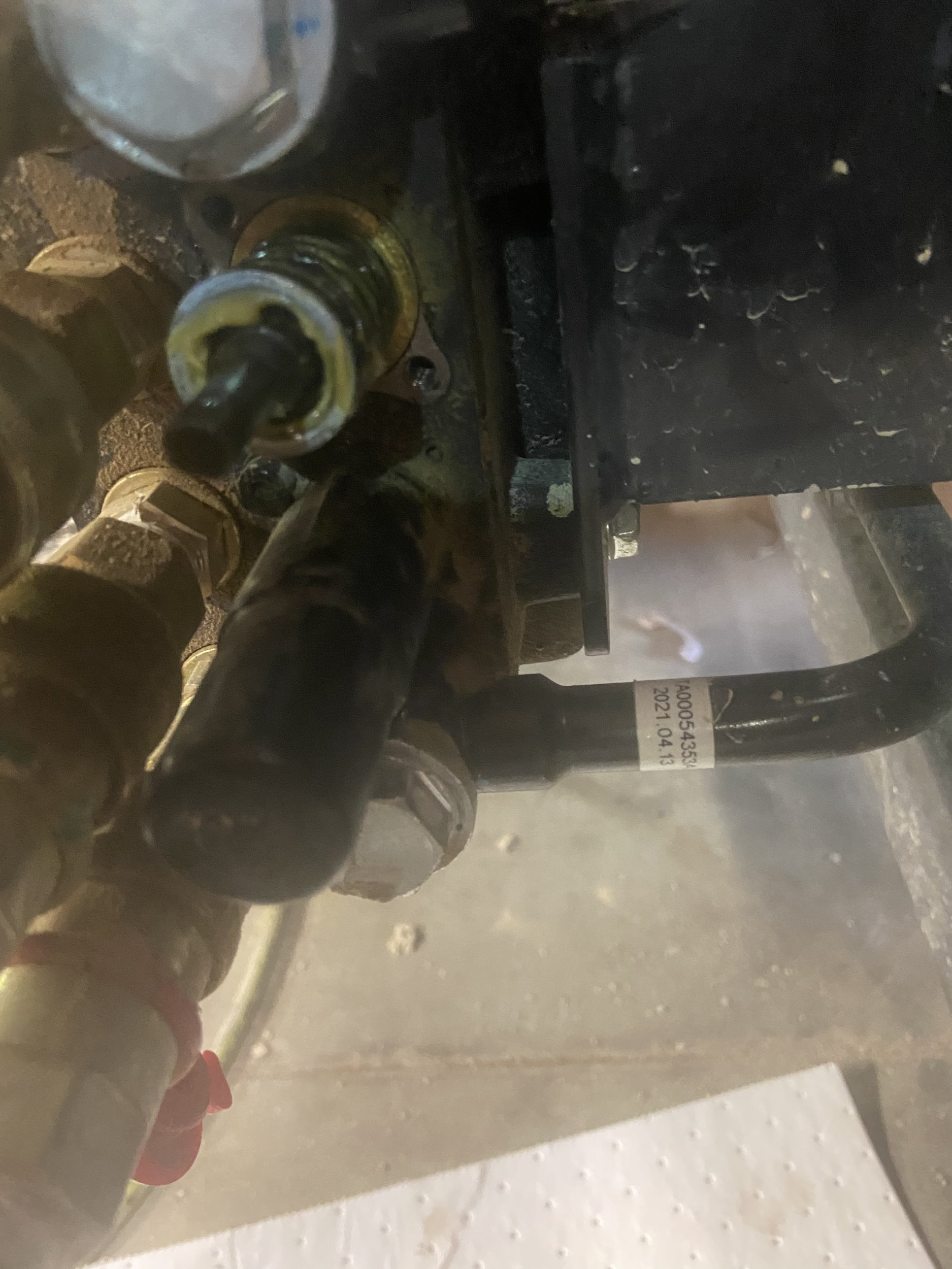

Can someone help me find the relief valve for the loader on my Branson 4820r. And is it an adjustable valve or need shims.

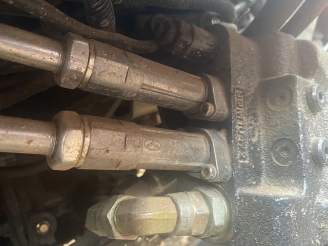

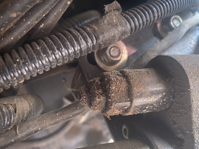

Thank you for your reply. I did hook up a gauge it’s only putting our about 2100 psi on boom up. Dead headed. Spec is 2532 according to what specs say. There are 2 on the remote valve. Under a cover with 2 Allen bolts. They don’t seem adjustable. Maybe I’m looking at the wrong one

This is mine but it is a 15 series and 2020 model. Yours may be different.

Yes that picture is the loader valve on mine. I figured yours may be different. They made a lot of changes on the new 20 series. Unfortunately they have not released the manuals yet that I am aware of.

That's not the relief valve. That's the end of the spool valve. The relief valve will look like the one that K5lwq showed on post #6.
