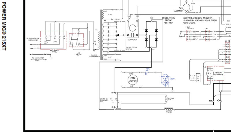

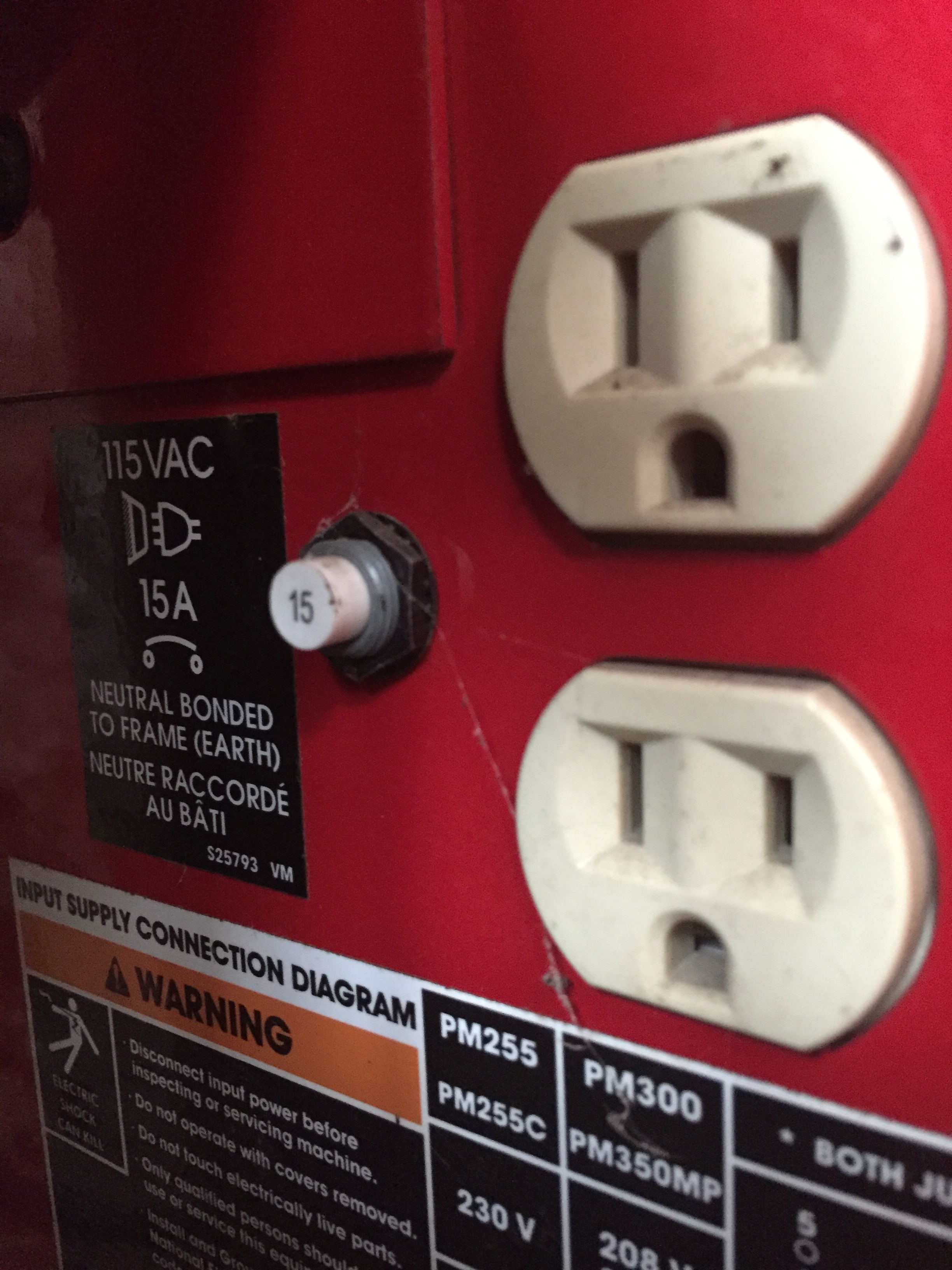

If this is the case with Cord's machine then he is seeing one leg of the transformer secondary intentionally grounded by the mfg (connected to the case) to create the separately-derived line and neutral for local 120v loads. This is very different than just connecting the neutral terminal of a 120v receptacle to a grounded surface in the hopes of creating a return path.
Yeh, let's see if I can get a snip attached here.

Maybe I am misunderstanding you. Do you mean the welder was furnished with a 120v male cord cap or that your welder branch circuit is terminated in a 120v duplex receptacle?
See if this helps to answer your question. 2017-07-27 20.04.32 (1).jpg Honestly, I don't think the outlet is any different from a 120v fan being used inside of a 220v welder and the machine not having a neutral.
