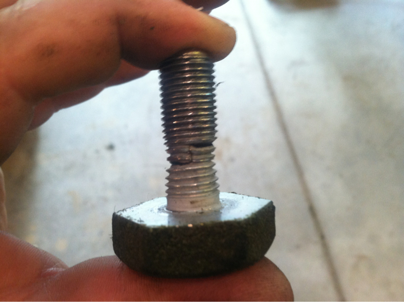

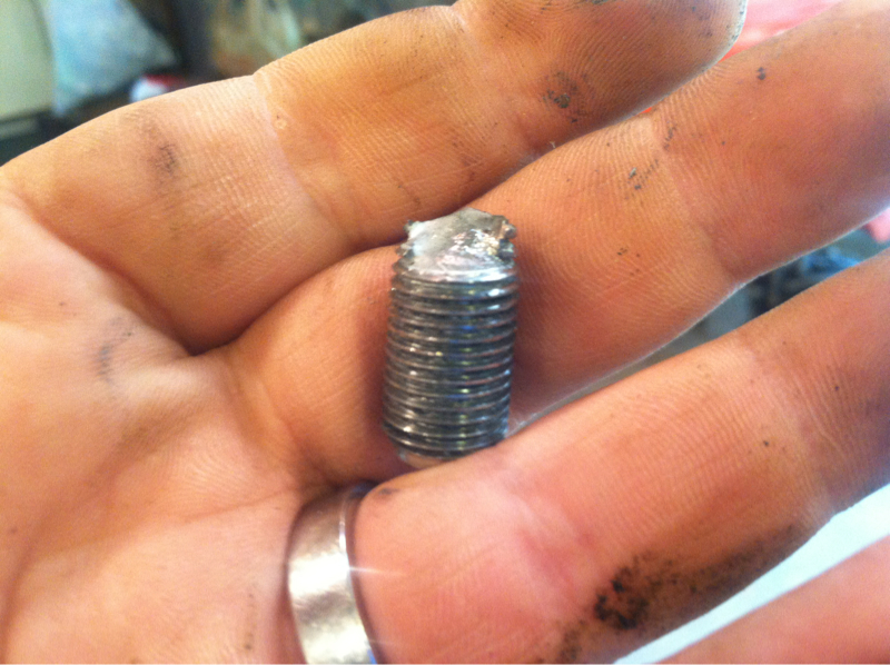

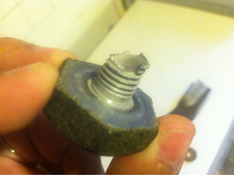

Autopsy pictures

Thats too much stretch for it to be a very hi strength bolt. Id say Gr5/8.8 or less. When mine snapped on tightening there was very little elongation. I figured Gr8/12.9. ... [strange] :confused2: ... I did replace my bolt with a standard 8.8 grade and have had no trouble tho. But then the design of the 54" mower prevents any possibility of further tightening from incremental blade slippage, by use of that hex washer I referred to.

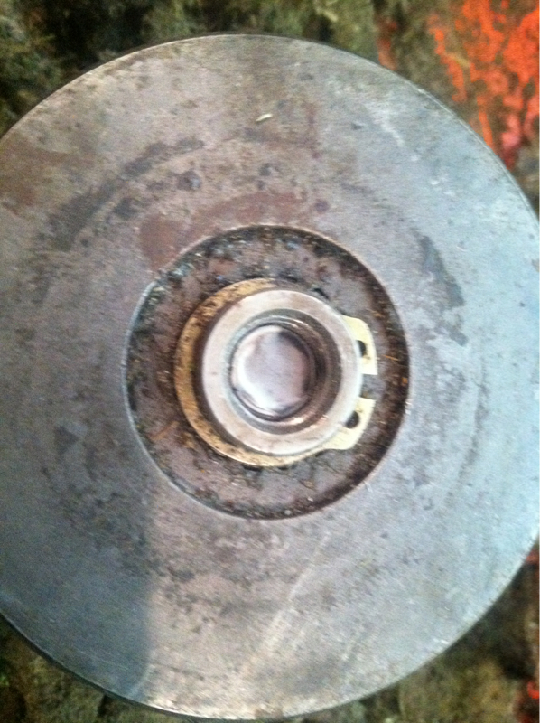

Wood be good if those spindles have a hex nose for the washer to engage. It doesnt look like it from the picture he just posted.
