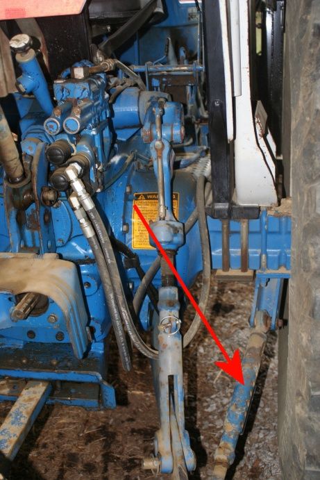

My bad. I did not realize those pics were embedded thumbnail. Any how I opened the pictures up and had a close look and have too agree with Jinman as this was the case of " honest operator error" which is just fine, cause no damage was done,and more importantly no one was hurt. I do not have a BB with my setup and can not comment a lot about them but theory and physics of the operation is exactly as Jinman said. I mentioned it before that the 3 point does not have a down pressure force and hyd safety pop off should deploy far before you destroy the rockshaft unless you are rocking your about 9000 lbs tractor forward and backward trying to free sacrifier teeth that are stuck good and deep in something nasty. At that point something got to give. By the way I can see your attempt of leveling the 3 point on the right crank arm by observing more oily thread exposed. That's good.
The only word of caution that I have is " always, always beware of stored energy in implement before you get the big hammers and such when you mount or dismount implements. Release of stored energy from spring, binding load can be very quick and violent.... just need to be careful.

I'll try to answer your questions here:
1.) Yes, correct in assumptions. I did try to level it with the hand crank before removing the BB, but it was so tight I could not get the crank to budge.
2.) Toplink was slightly extended, nothing dramatic. I tried adjusting it to see how it would affect the bite of the scarifers, but didn't change the overall length very much at all. I also had the top link in the highest hole on the tractor, which would have some affect on the thing. When lifted, the rear of the blade was lower than the front, yes pulling the scarifers closer to the tires. When lowered, the longer top link seemed also to allow the front end of the BB to be lower and get a deeper bite out of the scarifers.
3.) Yes I have stabilizers.
4.) I do not know what the stock tires were for this tractor. These are 18.4X34's. They are pretty big. I've noticed other implements have interference issues as well. When I put a bale on a 3ph spear the tires rub the edges of the bale some times.
5.) Don't know about the rims either, but the tires "seem" normally mounted to me. Of course, that may not carry much validity.
6.) Certianly those things could have played into the problem I ran into. However, here's a picture I took of the BB lifted before I started working back there.
It is reasonably level and though close, not interfering with the tire. Something happened while I was working, maybe the hand crank slipped with the force being put on it any time I lifted the BB or the nose of the tractor dipped. I hear what you are saying about the adjustment being out so the left side lifted before the right, but it was a pretty exaggerated angle.

Tim, I didn't mean "operator error" in the true sense of the phrase, but rather a lot of things coming into play at the same time that you didn't notice. When I look at the picture of your new boxblade on your tractor (especially the one I posted) it looks like the scarifier is very close to the tire.
What I meant about the rim is not that it is non-standard, but just the opposite. Consider a rim that could be adjusted as wide as you want. With a tire mounted, as the rim gets wider, the tire would spread and it's outside diameter would decrease. If your tires are designed for a wider rim, then they could be a little larger diameter.
I'm glad to see you have stabilizers, especially since you use the boxblade in reverse. Without stabilizers, the main lift arms take a lot of stress.
Maybe the next time this happens it will be in full daylight and you can see all the contributing factors. Just remember that a small amount of tilt is multiplied out on the end of your boxblade, and a small amount of toplink adjustment is probably 1-1 on the bottom of your box and scarifiers in the opposite direction.
When I put the first hydraulic toplink on my tractor, it was about 2" too long and there were several times I put the scarifiers into my tires when I ran the toplink out too far. Now I'm probably overly sensitive to clearances.

Spivey,
There are only 2 things I can think of off the bat. The adjuster slipped or the splines on the rock shaft slipped.
I don't think the splines on the RS slipped as the upper arms are level in the pictures. I wouldn't think they would go back to level if that was the issue. So, that leaves the adjuster on the right side. The right side was lower, so that is consistent. You were working with the scarifiers down, so there may have been a point where you snagged a root or rock and it pulled the adjuster. They are pretty robust, but even anvils fail occasionally.
Put a tape measure on the adjuster and note the length. Then work it good an see if it gets any longer.
Also, take extreme care lifting the 3pt with the BB on it when the scarifiers are down. You don't want to find out what happens when one part of the 3pt breaks and the BB pivots. Think giant whoosh sound and your wallet getting $1000 lighter (per side). That's right, pop! goes the tire. You really don't what that.
